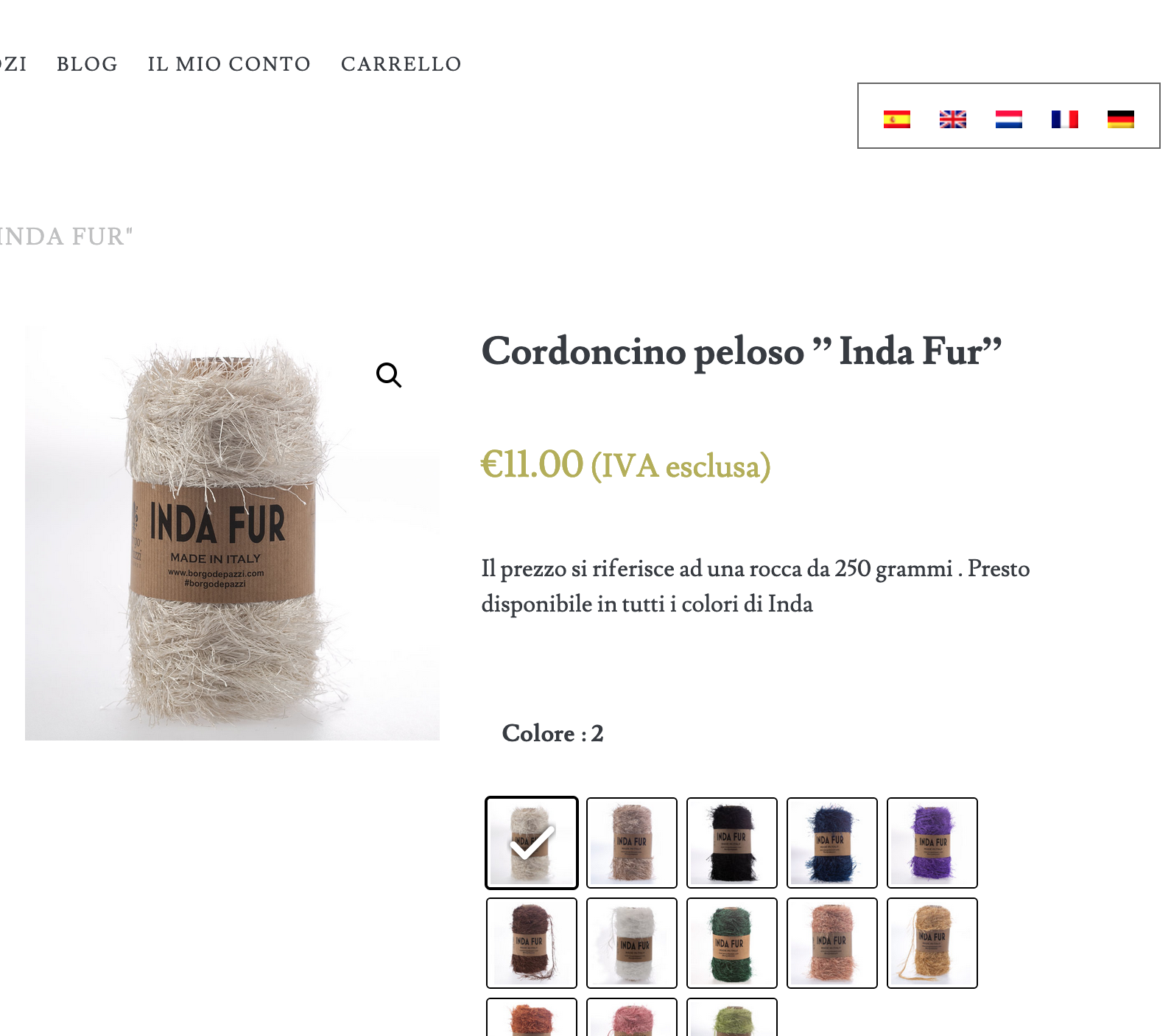

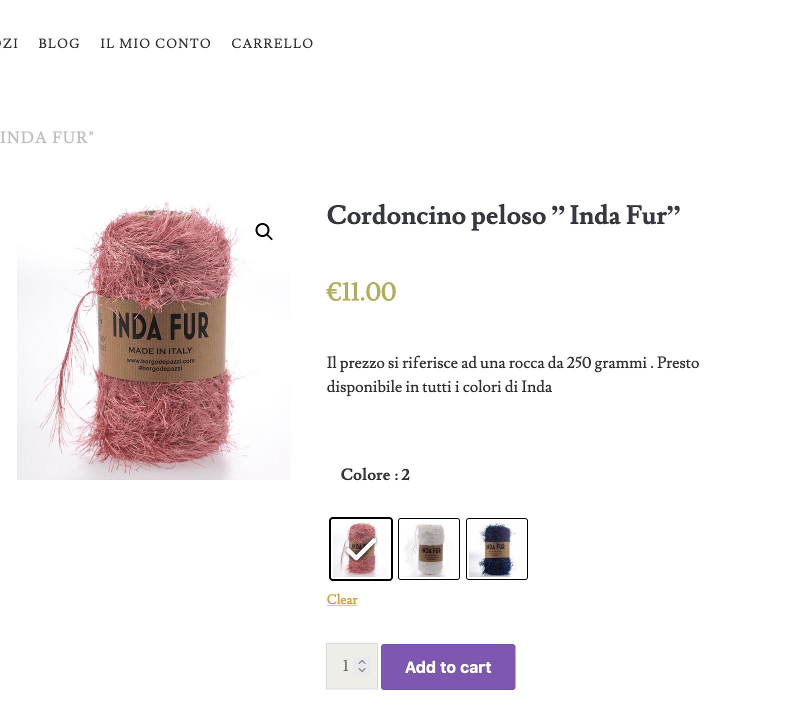

April 16, 2024 at 8:27 am #15523247
danieleB-4
Hello Prosenjit,
thank you for your answer. I enclose two images, you can see the links to the different languages on the live site but none on the staging.

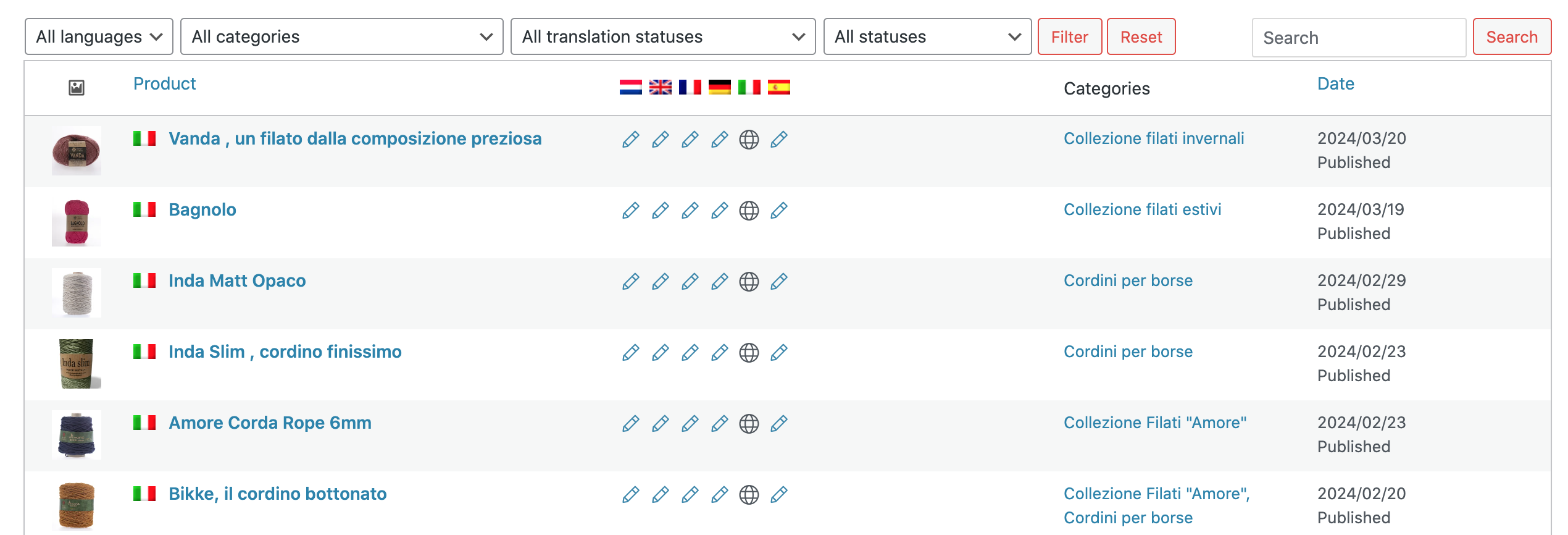

April 17, 2024 at 12:13 pm #15531921
danieleB-4
Hi Prosenjit,
the products all have completed translations, as you can see from the screenshot.
For the product we have been using for testing I opened it again in WooCommerce Multilingual, completed the English translation and saved it.
Yet all products in front end do not have links to the translations, as you could see in previous screenshots and from the links.

Hi There,
Thank you for the update.
I have inspected both sites and noticed that the entire Language Switcher markup is missing from the header section of the staging site. Please check this screenshot for a better understanding: hidden link
Since you are using the theme's default header, please confirm that the language switcher shortcode is correctly implemented in the header of the staging site, similar to how it's set up on the main site, and then check again.

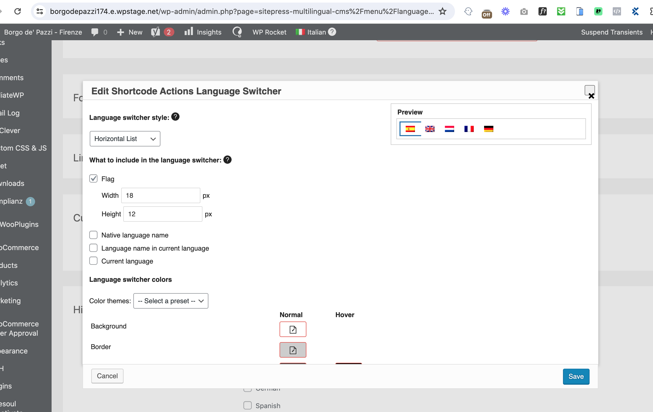

April 18, 2024 at 7:26 am #15535614
danieleB-4
Hello Prosenjit,
thank you, indeed is missing the entire div with the selector, which is visible on the live site with the ID "lang_sel_list"
the fact is the live and staging are identical, I am still checking also all the settings, the theme is the same.
I went to check as you suggested in "languages" -> "custom language switcher" and all is active, the preview on both websites shows the same. I enclose screenshot of the preview on the staging.
Yet that part is not visible on the front end
