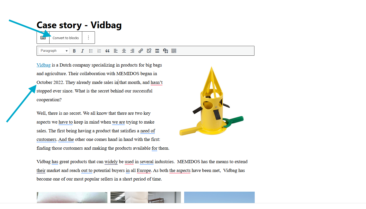

I've investigated the issue and am pleased to inform you that I've identified the root cause. Here's what was happening:
When the post was originally created 2-3 years ago, it was created using the Classic WordPress Editor. I confirmed this through database investigation — there are no Gutenberg block markers (`<!-- wp:`) in the content.
However, at some point (likely when Gutenberg became the default editor), WPML registered this post as a "Gutenberg" package and created string translations under that package type. Since the actual post content never had Gutenberg block markers, WPML couldn't process the translations correctly.
This is an edge case that I couldn't replicate locally, but we're currently discussing how to handle it properly in the code. As soon as we have an update or a permanent fix, I'll let you know right away.
In the meantime, you can use this workaround to get the translations showing correctly. Before updating any translation, follow these steps:
1. Open the post in the default language in the editor
2. Click anywhere in the text
3. Click on "Convert to blocks" (as shown in the screenshot)
4. Make any updates you need in the default language and save the changes
5. Then update the translation
I tested this approach on your sandbox site, and the Danish translation now displays correctly in the UI.
Please give this a try on your production site and let me know how it goes. Once we have any updates from our team discussion about a permanent solution, I'll reach out immediately.
Thank you for your patience as we work through this!
Prosenjit

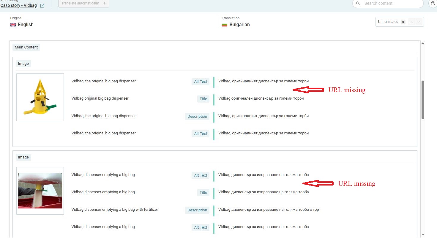

I followed your advice and made the workaround. The text is now getting translated, but I am facing an issue with a link.
The first word in the article is “Vidbag”. Here i am linking to the company page: hidden link
If you look in the ATE for Bulgarian the link is translated correct to: hidden link but the translated link is not active on the Bulgarian version of the blog page (this appears to be the same for all languages)
The image links appears to be translated and working correct, but in Bulgarian they are not visible in the ATE. For other languages they are visible, but not necessarily showing the correct translated link even though it is working correct on the respective blog page.

I’ve reviewed the Bulgarian version, and the “Vidbag” link is working correctly and points to the appropriate translated company page. At least in the sandbox environment, after completing the translation, the link behaves as expected and is fully functional on my end.
Regarding the images, I checked and couldn't find any links attached to them on the page, which could be why they're not showing up consistently in the ATE.
I want to make sure I'm looking at exactly what you're experiencing. Could you help me understand a bit more:
1. When you say the translated link is not active, does it mean the link isn't clickable at all, or is it clicking through to the wrong page?
2. Are you checking this on a specific device or browser? Sometimes, caching can cause differences in what we see.
3. For the image links, were these supposed to have links attached to them originally?
If you could share a screenshot or screen recording of what you're seeing on your end, that would really help me replicate the exact issue and get you a proper fix.

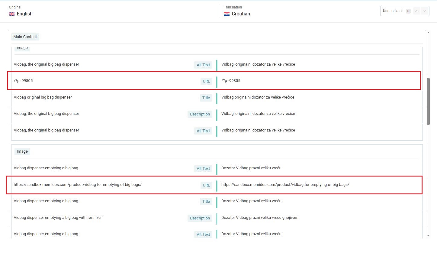

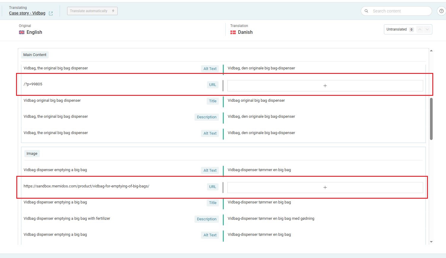

Now the translated links to the Vidbag company page also seems to be working on the production server. Very strange - I cleared the W3TC cache several times yesterday.
Regarding image links:
Sorry for the confusion. I only made this on the production server.
Now I have copied the text/code to the sandbox so it is identical and translated it into a few languages.
I have attached screenshots from the ATE for Bulgarin, Croatian and Danish. As you can see are all 3 different, and it is not possible to edit the image link url in Bulgarian.
Best regards
Peter

Thank you so much for sharing those details. I understand you're reporting an inconsistency with how links are being handled in the translation editor. Since you made updates in the sandbox, I took a look and found that the links attached to the images are not appearing in ATE.
To make sure I was investigating correctly, I made an update to the link in the first image (and also modified some text slightly), saved the changes, and then tried to update the translation. When the editor opened, I still didn't see the links attached to the image.
Please note that when you use an internal page link, WPML should automatically handle it and update the link in the translated page based on whether that linked page exists in the target language.
But that is for the frontend. However, I do see some inconsistencies with how links are appearing (or not appearing) in the translation editor. I'm currently discussing this internally with the team, and as soon as I have more information or a solution, I'll update you right away.
