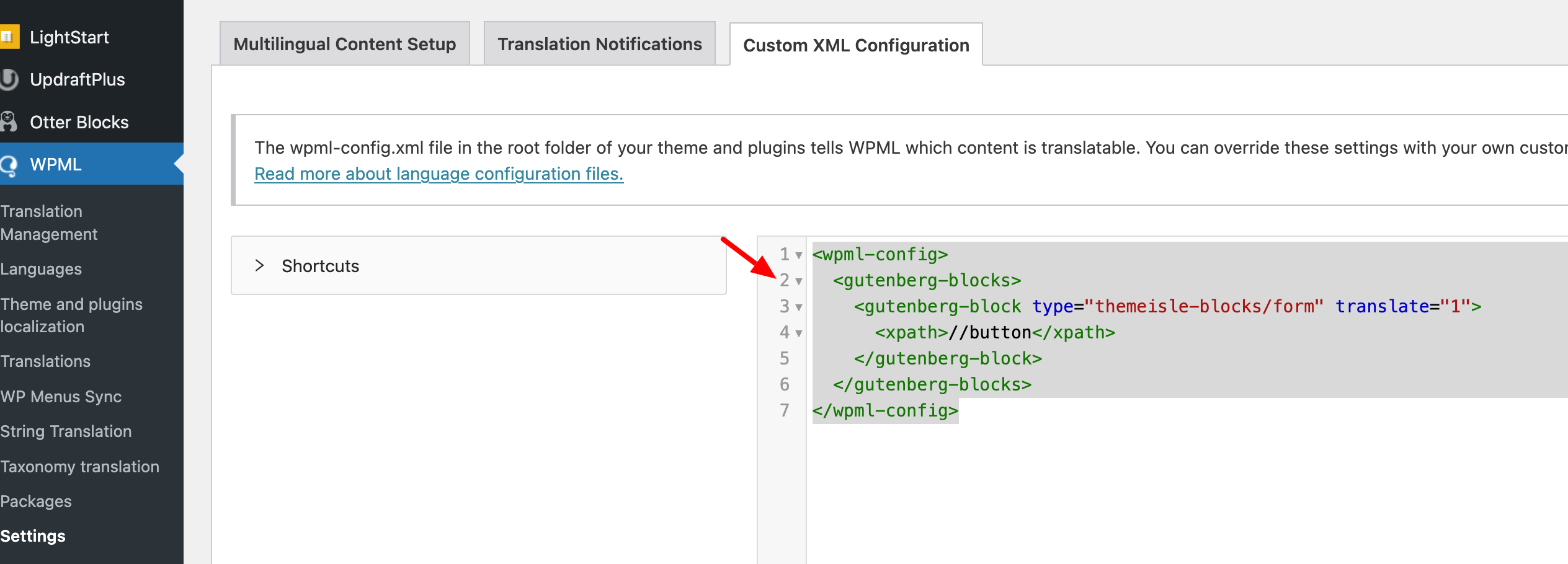

If you're experiencing an issue where the 'Send' button on the contact form of your Main Page is not showing translations in Russian (RU) and Uzbek (UZ) despite being translated in String Translation, the issue might be due to a missing configuration.
We recommend adding a custom XML configuration to make the 'Send' button translatable. This involves using the Otter—Page Builder Blocks & Extensions for Gutenberg plugin. You can add the following configuration in WPML → Settings → Custom XML Configuration:
<wpml-config>
  <gutenberg-blocks>
    <gutenberg-block type="themeisle-blocks/form" translate="1">
      <xpath>//button</xpath>
    </gutenberg-block>
  </gutenberg-blocks>
</wpml-config>
After adding this configuration, trigger the translation by making a slight change to the homepage, updating it, and saving the translation. For detailed guidance, refer to the documentation on making custom Gutenberg blocks translatable.

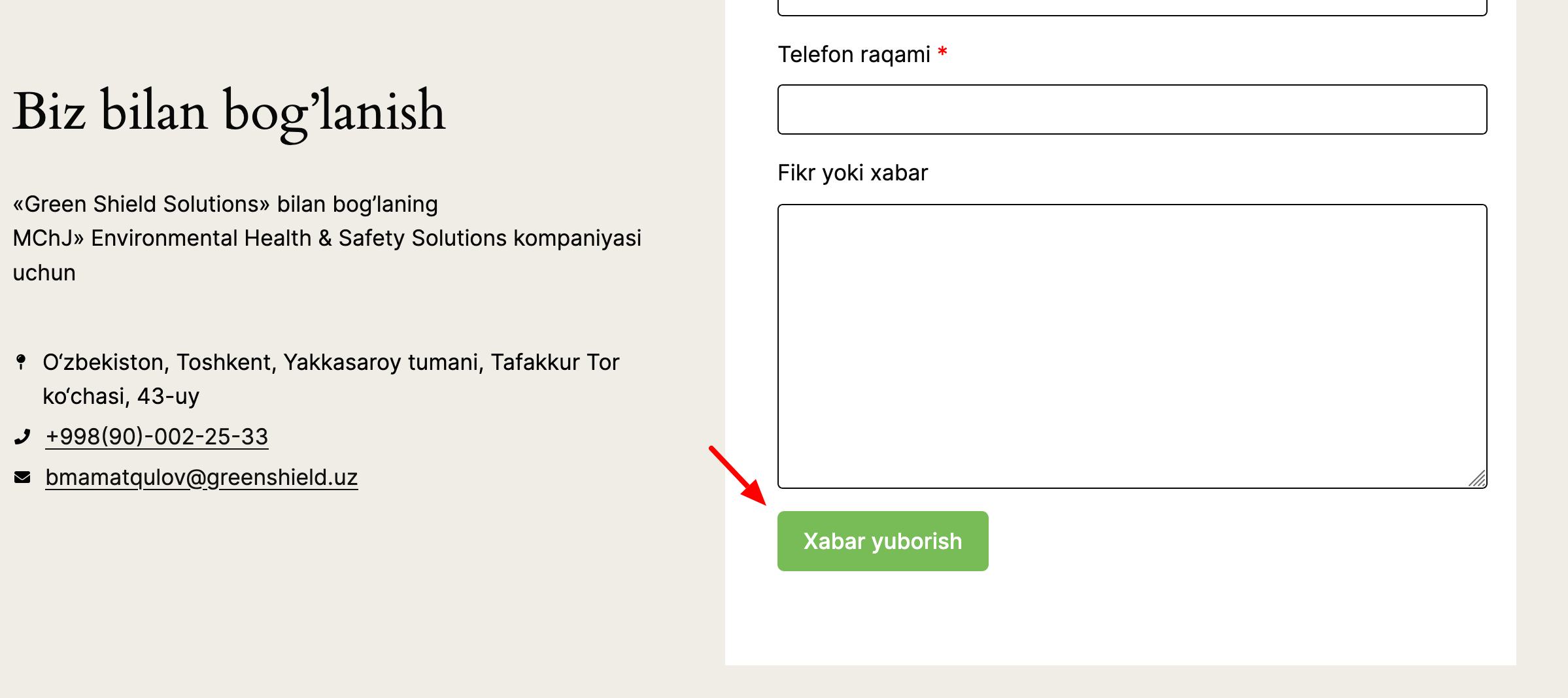

February 28, 2025 at 2:48 pm #16761457
akmaljonU
Hi Andrey,
I've noticed one more issue with translation Send button of contact form on Main Page, on RU and UZ pages Send button doesn't show translation however it's translated on String Translation for each language. Can you help me with fixing this issue also?
You can see this issue also on screenshots earlier on this ticket (reply #16752595)

I have reviewed this issue, but I don't see an obvious reason at this time. Could you please update the Otter – Page Builder Blocks & Extensions for Gutenberg plugin to the latest version? The form is dependent on it.
Please let me know when the update is complete.

March 3, 2025 at 12:33 pm #16769087
Andrey
I appreciate your patience. I had to look deeper into this problem.
I found that the send button text wasn't translated because a configuration was missing that added the button from the Otter—Page Builder Blocks & Extensions for Gutenberg plugin to the translation.
Using the article linked below, I created the necessary configuration and added it to WPML → Settings → Custom XML Configuration.
https://wpml.org/documentation/support/language-configuration-files/make-custom-gutenberg-blocks-translatable/
Here is the configuration I added:
<wpml-config>
  <gutenberg-blocks>
    </gutenberg-block>
  </gutenberg-blocks>
</wpml-config>
Then, I triggered the translation of the homepage by making a slight change, updating it, and saving the translation. I will report to my team so they can inform the plugin's author.
