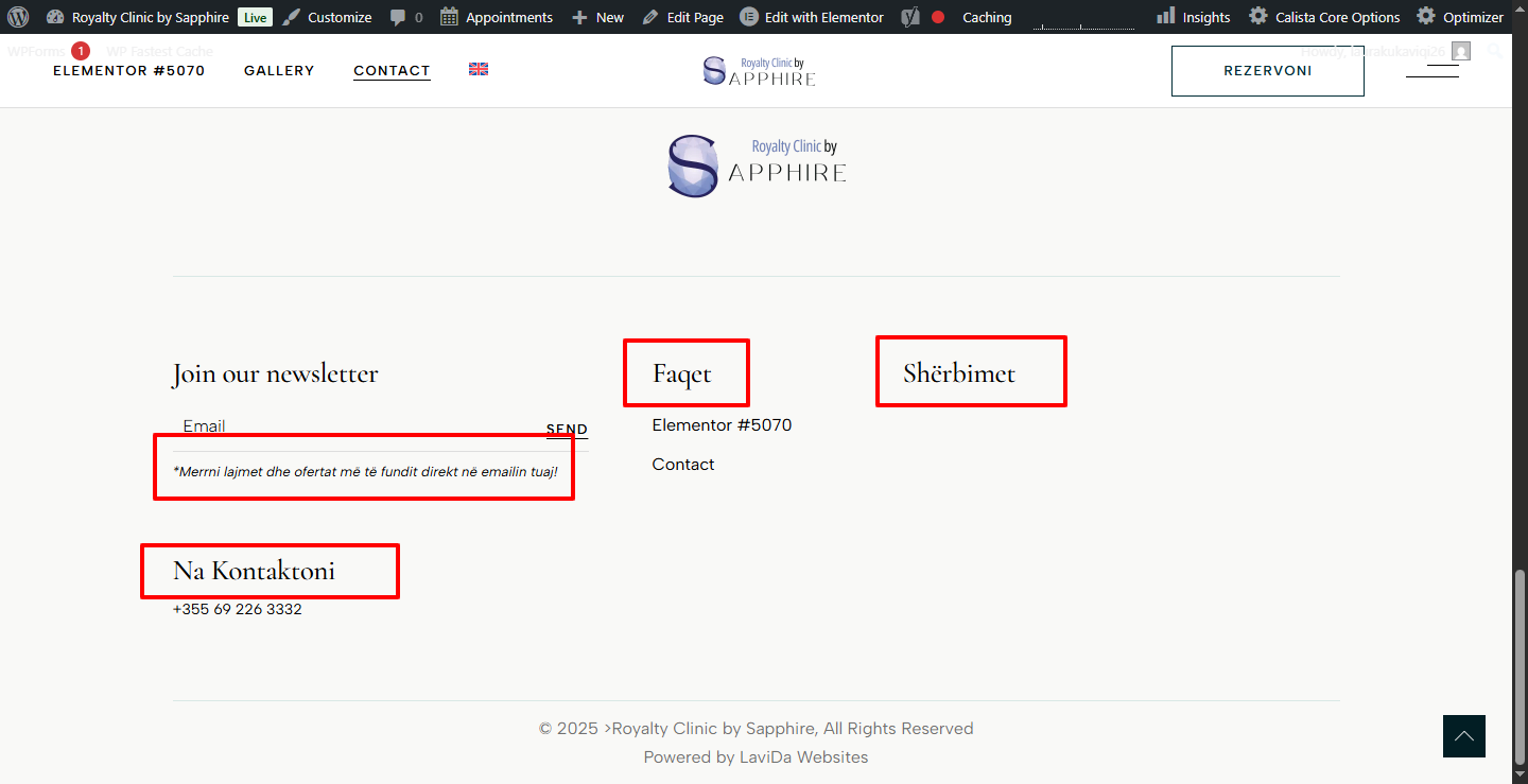

June 10, 2025 at 9:39 am #17121126
lauraK-16
Yes perfect, but one more thing, what about the footer which is at Appearance - Widget

June 10, 2025 at 4:14 pm #17122923
lauraK-16
Before we go at slider and widget issues, The design is still being destroyed when I try to translate it. Is there a problem? How did you do it the the Contact page?
