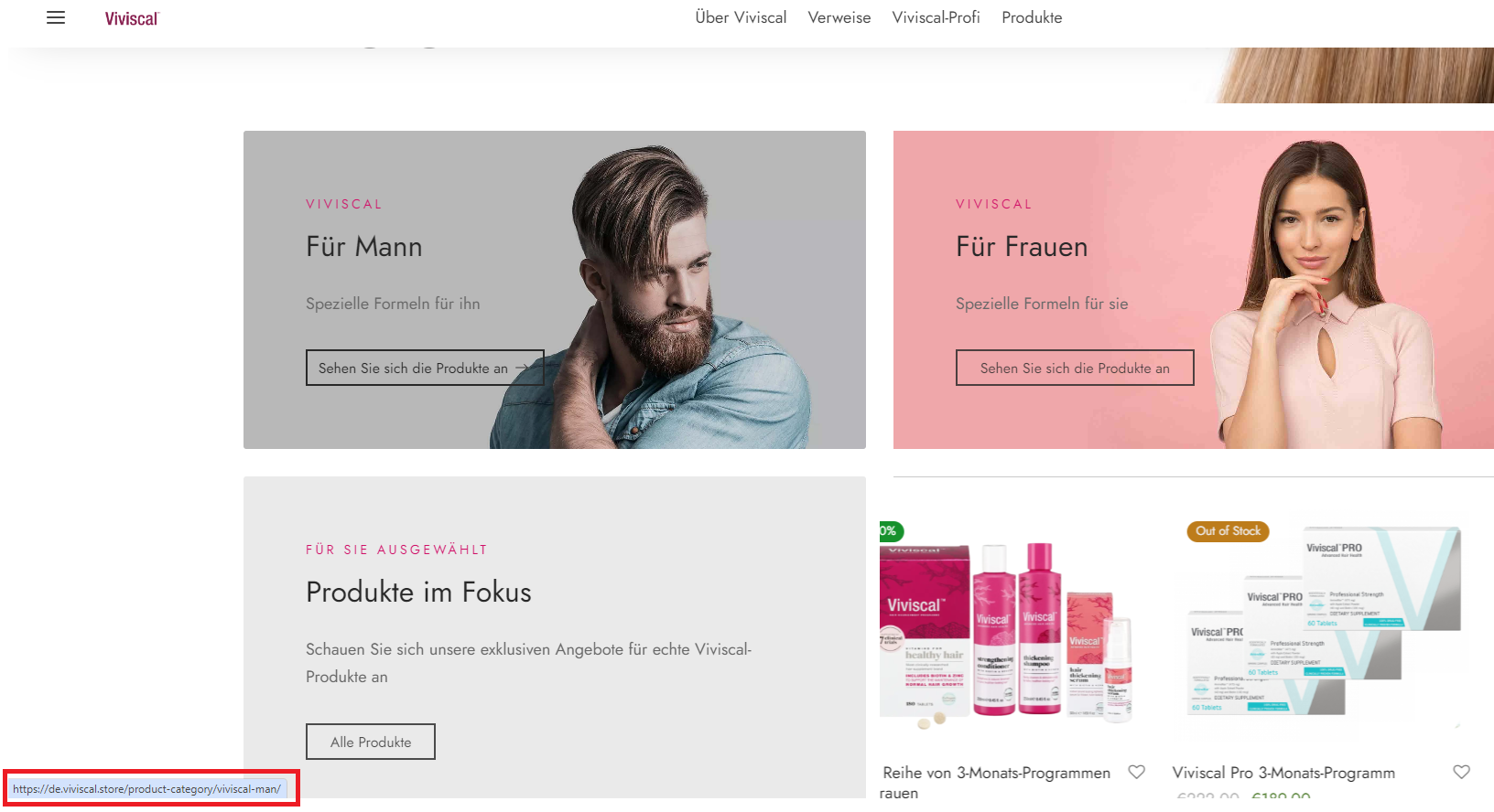

Mateus Getulio
Hello there,

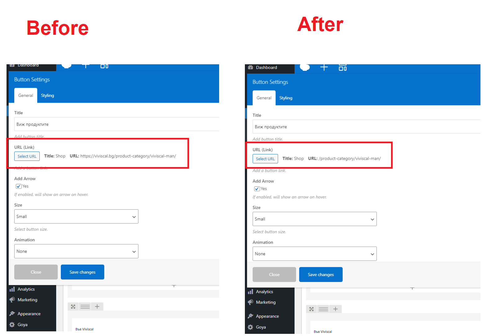

I checked it and it looks like the links are added as absolute/full links. In order for WPML to translate it automatically for you, you can edit the links in the main language and set them as relative links. Eg.: I edited the link in the button "Sehen Sie sich die Produkte an" from hidden link to /product-category/viviscal-man/.
After that, I saved the page in the main language, edited the German translation as a test and just saved it as it is. Now when I check the link of that button in the German language, it is pointing to the correct domain.
Please check the screenshots I attached to my reply.
In order to fix it, you need to edit the links in the main language, remove the domain and save them as relative links as shown in the screenshot. Then you edit the translations one by one and just save them as they are without having to edit the translation.
After that the issue with the links should be fixed.
Thank you,
Mateus

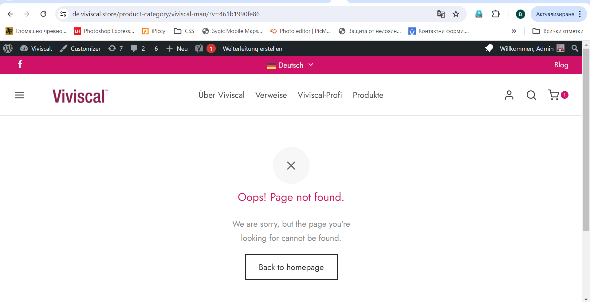

Hello, as an example, I am sending a picture of the link in German. Before that I cleared the cache.
May 29, 2024 at 8:45 am #15682151
boyanK
The link does not redirect correctly

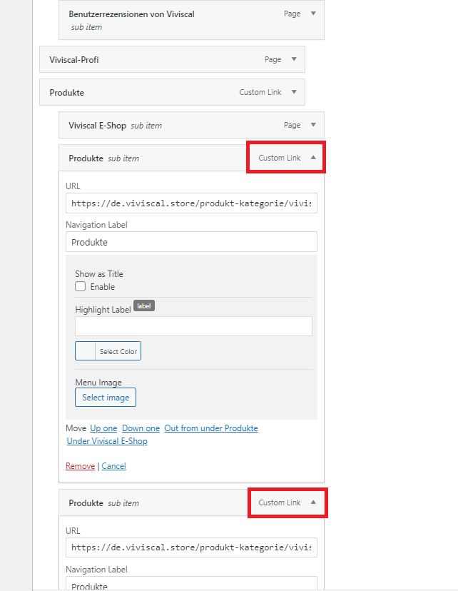

I checked it and the issue with this specific link is that it was created as a custom link.
To see it you can go to Appearances > Menu > Главно - Немски (Main) or please check the screenshot to view it.
I reviewed this issue and the links were incorrect in the menu, to fix it I followed the steps:
- Go to Appearances > Menu > Главно - Немски
- Switch to German in the admin top bar
- Edit the link Viviscal für Männer changing it from hidden link to hidden link
- Edit the link Viviscal für Frauen changing it from hidden link to hidden link
After that I tested it and the links are working correctly.
Please notice that WPML can't automatically adjust custom links. It is possible to translate/edit the URLs and labels of custom links in two ways:
1) Manually from the Appearance → Menu page like I did above.
https://wpml.org/documentation/getting-started-guide/translating-menus/#option-2-translating-menus-manually
2) By syncing the menu structure and then using WPML String Translation to translate the URL and label of the custom menu item.
https://wpml.org/documentation/getting-started-guide/translating-menus/#translating-custom-links
Thank you,
Mateus

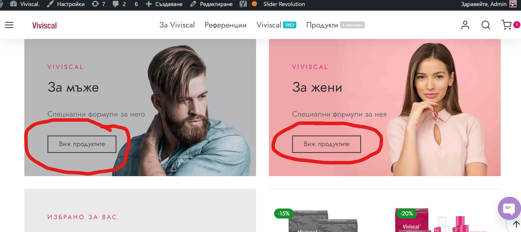

I think I can solve the menu problem. Apparently I didn't ask the question correctly. I mean the problem with the links to the buttons. I am attaching a photo. I did what you advised, but only the links in Greek work correctly.
