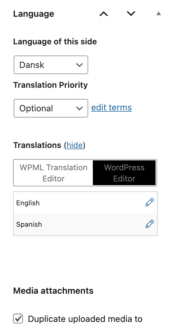

1) I have published the Danish version of the frontpage and translated it manually and edit manually on the Spanish and English version. The persons from the support I have spoken to earlier told me, that they have set the page so it wouldn't be overwritten when I update the Danish version. It have worked fine until recently. Then it startet mixing content in lanugages and links again. I don't know if the issue with the plugin have to do with it.

I have set the page as it says in the documentation, it has been set like that since some of your collegues has helped me witth the issue before. It worked for several months, but suddenly it switched again. It didn't even copied from the Danish version of the page, but put old images and links into the layout.
You can see the settings at the screen shot.

So the solution is to keep WordPress editor switch if you are going do do translation manual, otherwise you can have issue with content being overwritten.
I am not sure for frontage do you have same issue, if you do, please make sure to do the switch and adjust the translated page accordingly.

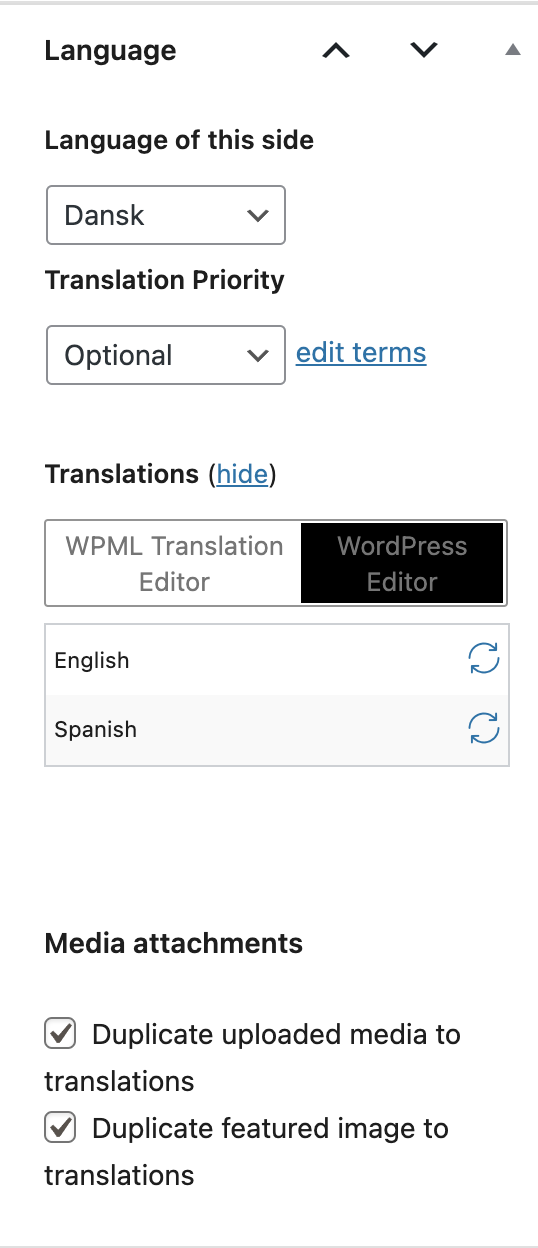

I do have the same issue on the front page, even though the Word Press editor is switched on - and it has been all the time. I did that months ago, when another supporter told me to do so. As I wrote earlier, it has worked for a long time, but now is doesn't work anymore. It keeps mixing the links and languages.

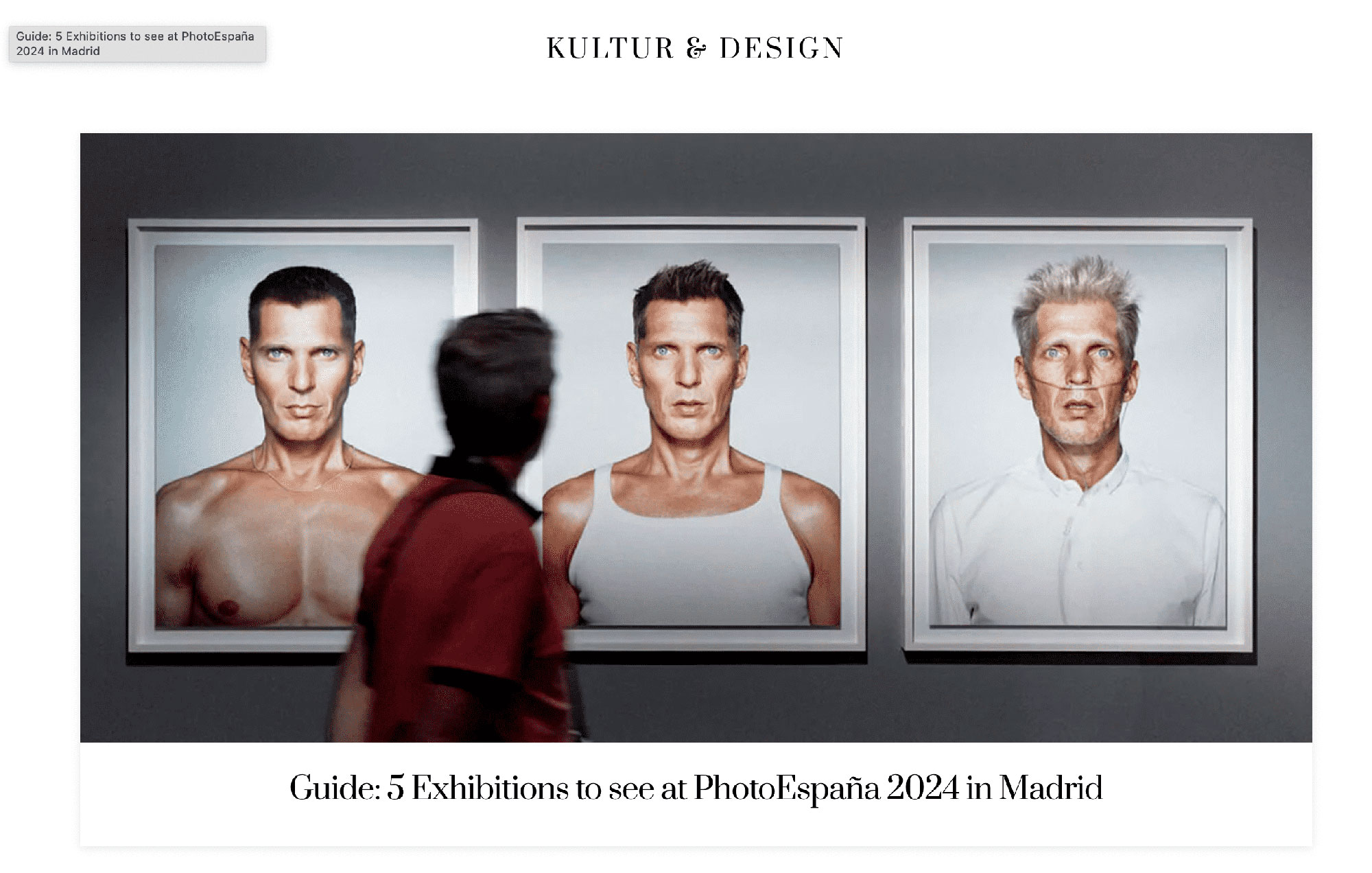

1. Here is what I do after checking correct settings backend. I edit in builder frontend.
2: Here is the results on the translated page. A layout part I did not edit and which is old and outdated shows up together with mixed language and Danish link

Here you have a video of what I have done while editing the Danish version. And it is set to wordpress editor backend
