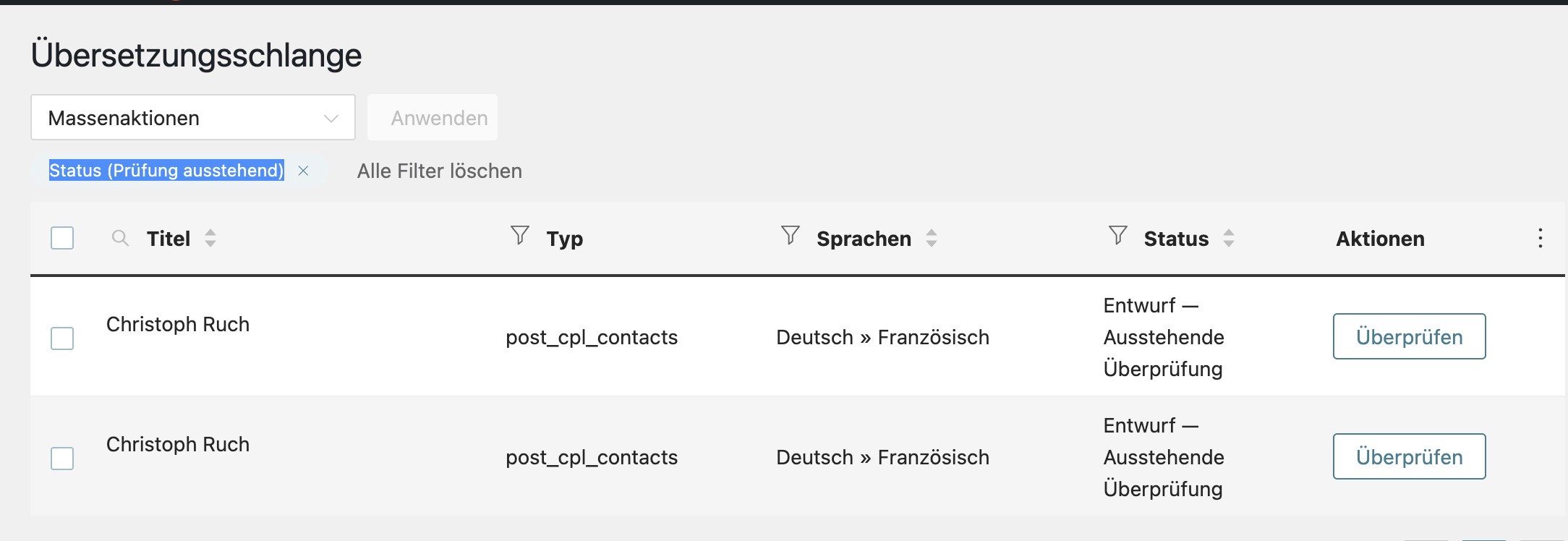

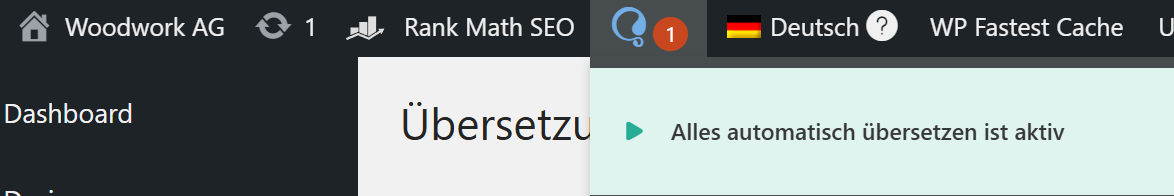

two problems: the first is that there are two items marked as «status: pending review» in the translation queue that are showing a endlessly spinning icon (see images 1 and 2).

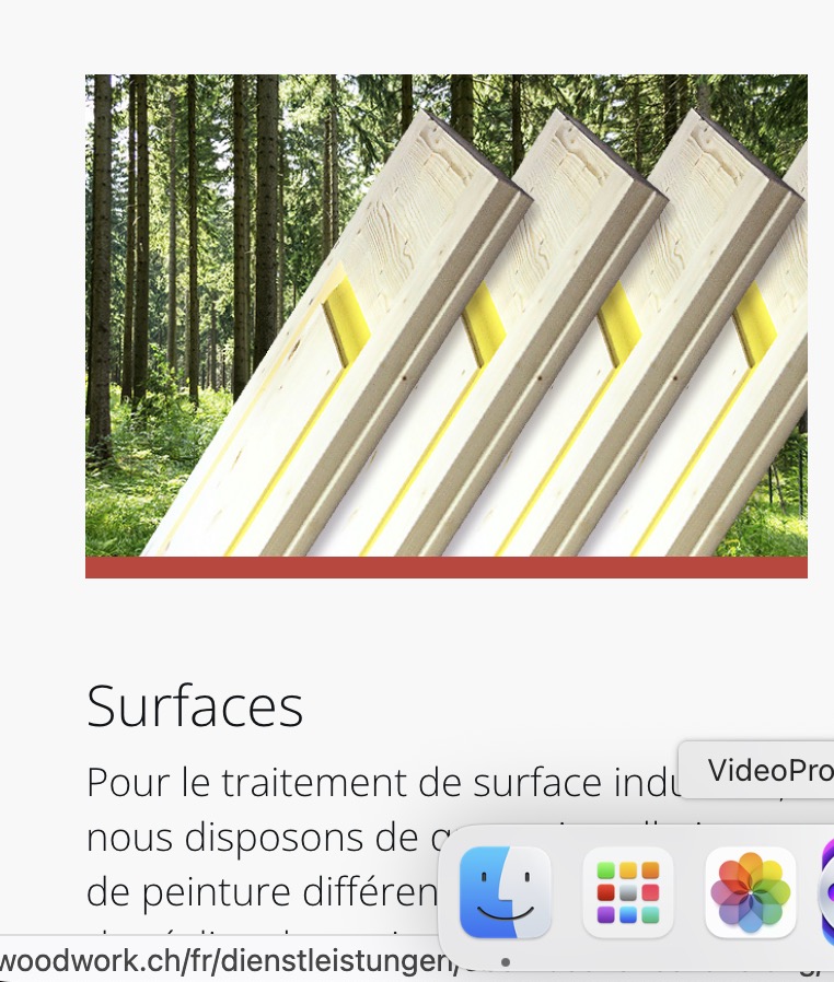

The second is that french links are leading to pages with URls that are not being translated to french. It is a site that I took over from anagency so I do not know exactly what they did (or didn't do).

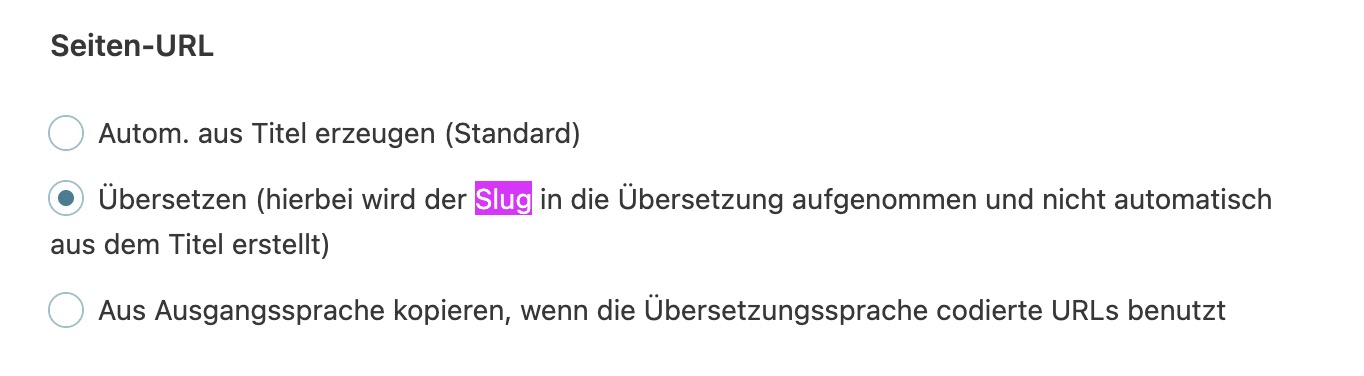

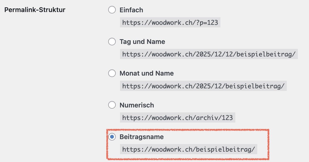

The setting «Translate slugs» was checked before already (see image).
Permalinks were set to «post name» before.
December 12, 2025 at 7:35 pm #17660725

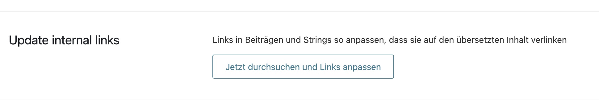

And I have updated internal links.

Let's focus on the first issue. Please try to cancel the stuck translation job and resend the page to translation.

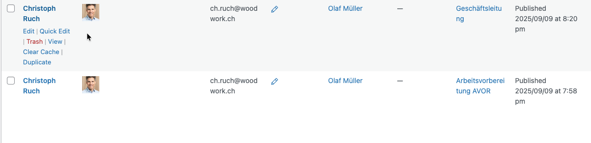

Thanks for the access details. I checked the issue and found two posts with the same name: one was published, and the other was not published correctly. I ran the WPML troubleshooting options, which resolved the issue.
Please review them and delete the duplicate.

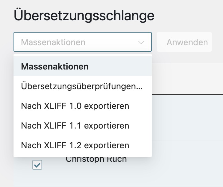

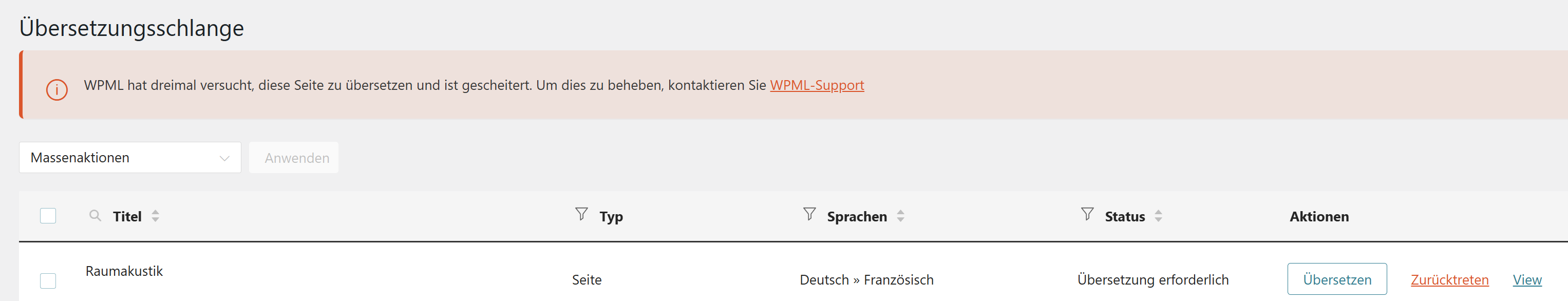

a. there is one job to be checked showing, but the link is inactive (image).
b. 3 failed translation attempts in queue, which cannot be canceled or worked on
c. there is no possibility to cancel from dropdown-menu
d. button-links on the french homepage lead to german content

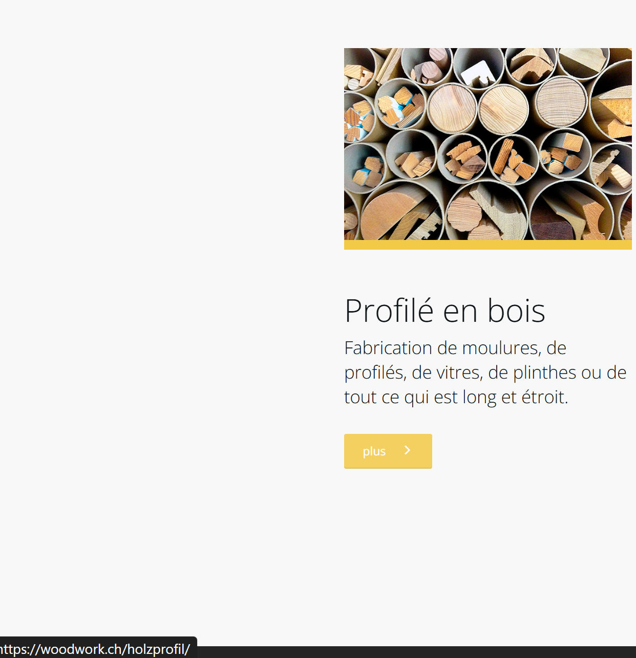

Does that help?

1) In order to cancel stuck jobs, please check the following steps:
1- Go to WPML-> Translation Dashboard
2- Switch off, translate everything automatically
3- Refresh the page
4- Go to the Translation Jobs tab
Kindly check this hidden link">screenshot.
2) The URLs were not translated inside ATE, so I translated them. Please check if they work as expected on the translated home page.

this switch away from ATE got rid of the reminder flag. But what if I preferred automatic translation: Can I switch it back on again?

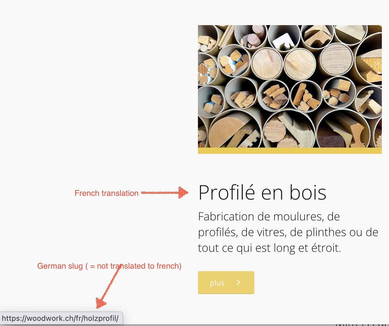

The slugs of the french pages are still not translated (see image). There is just the country code in front of the german slug. Translation should be profilbois or something like that. Should I manually translate these slugs in the backend? Or in the translation editor?

Another thing: Why are these jobs (see image) listed in «Translation queue» as needing translation?
Best regards
Olaf

2) The URLs need to be edited in the translation editor. (Kindly check this hidden link">screenshot)
3) These jobs might not be complete; you can take and complete these jobs or cancel them if you don't want to edit those translations.
