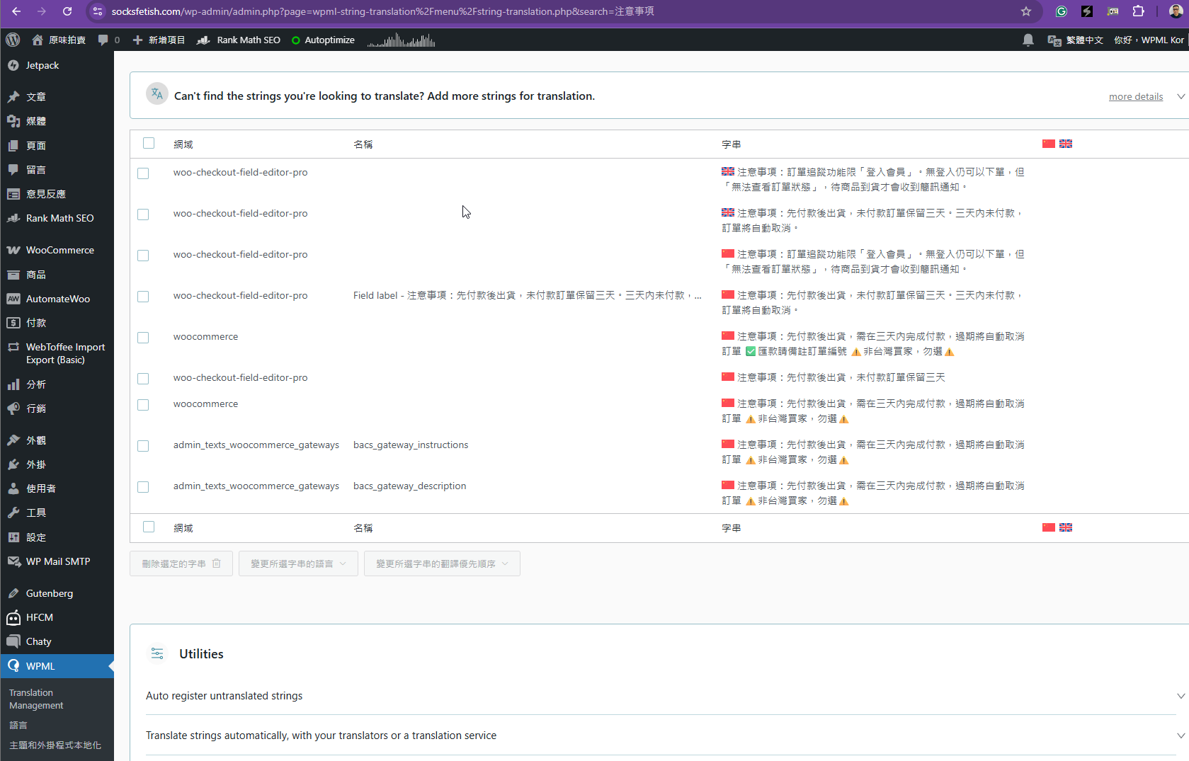

The client was unable to see the pencil icon for editing translations in the WPML string translation feature. This issue was suspected to be due to a conflict or a database collation issue.

May 15, 2025 at 11:31 am #17036596
chun-haoH
I was trying to use the string translation feature in WPML. When I accessed the page at hidden link, I noticed an issue.
The translation language edit button, which usually appears as a pencil icon, has disappeared.
Why is the translation language edit button missing?
How can I restore the edit pencil icon for string translation?

May 21, 2025 at 5:29 pm #17058638
Thanks for your patience. I can see the issue now here in string translation hidden link

May 27, 2025 at 8:01 am #17076138
Thanks for your patience. Our 2nd Tier Support checked and it looks like the WPML tables are using the wrong database collation. Please ask your hosting provider to change the database collation to utf8mb4_unicode_520_ci if the server supports it.
