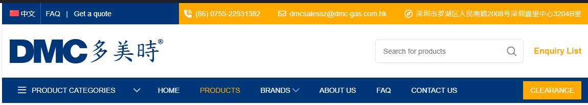

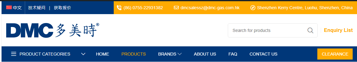

I am working on a site under development where the original language is Chinese, and I need to translate four strings in the header to English using WPML. The strings are 'FAQ | Get a quote', 'Enquiry List', 'Clearance', and an address.
When I translate 'FAQ | Get a quote', the translation of the 'address' reverts to Chinese. Conversely, if I translate the 'address', 'FAQ | Get a quote' reverts to Chinese. This creates a loop that I cannot fix.

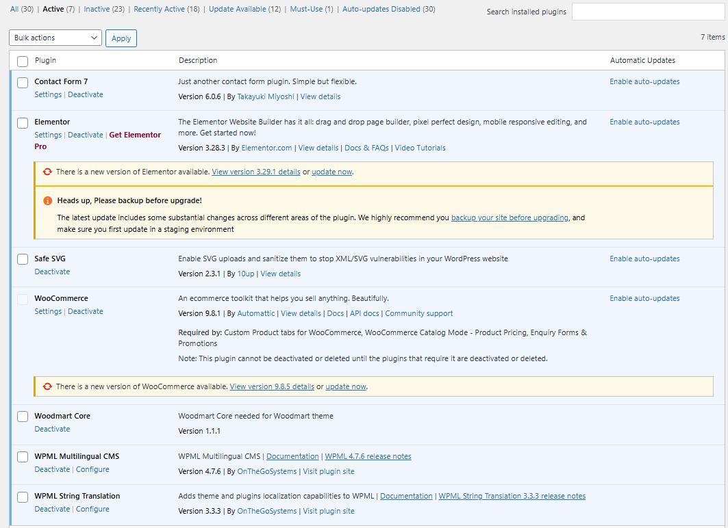

this the the plugins on my website now.

Ok thanks, so this seems to be something happening only on your installation.
Would you please check that all the plugins used and the theme you use (Woodmart) is updated to their latest version?
