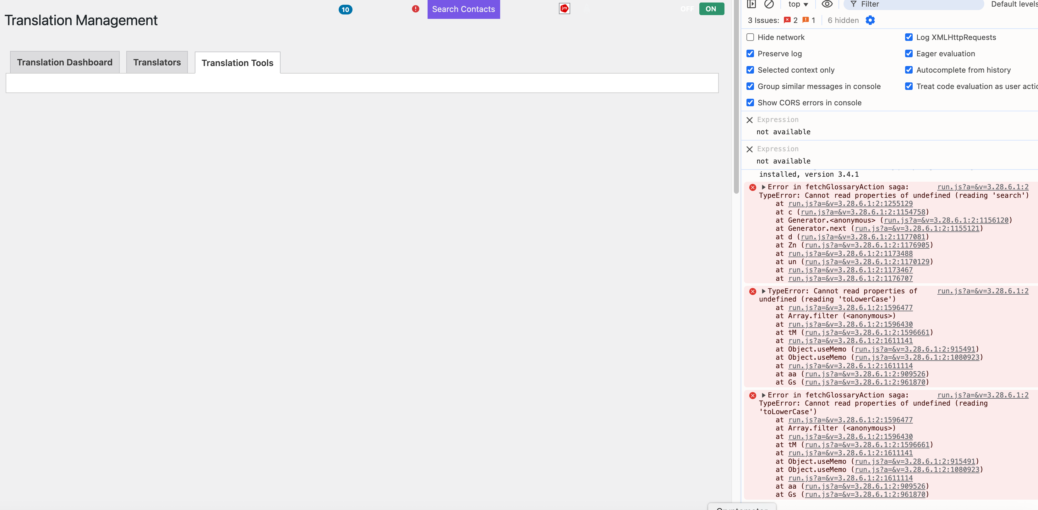

May 20, 2025 at 3:05 pm #17053456
ericH-23
I did this and after reconnection, the glossary is shown empty.
Then, after adding a test entry immediatley the error is shown.
