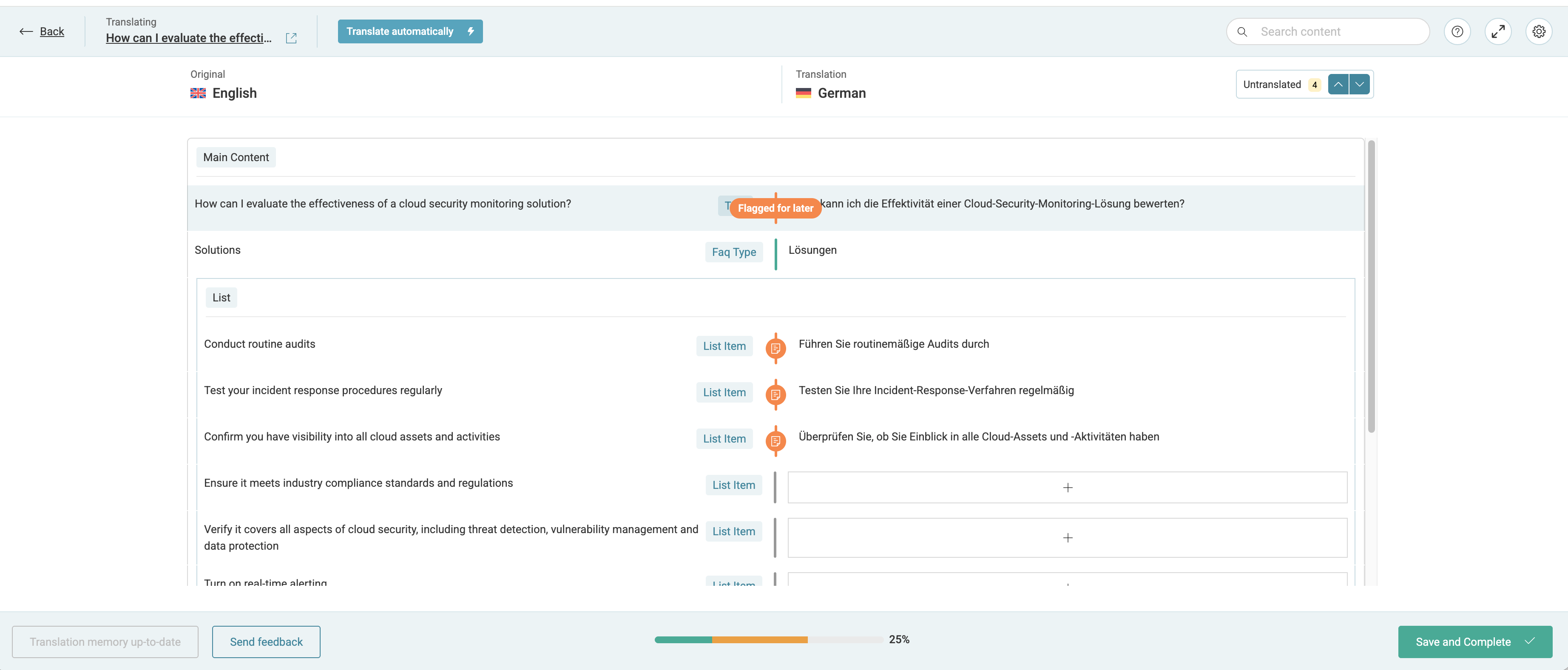

I watched your video. If I understand correctly, the problem occurs with translations received from the Blend Translation Service. I mention this because, according to your video, resending those translation jobs through our Advanced Translation Editor fixes the problem. We will, of course, investigate the issue and, if needed, communicate with the Blend Translation Service about it. For this, we have Translation Service experts. But before moving this issue to our Translation Service experts, we need your access to your site and a few examples of translation jobs with these problems (double slashes in a URL and http instead of https).

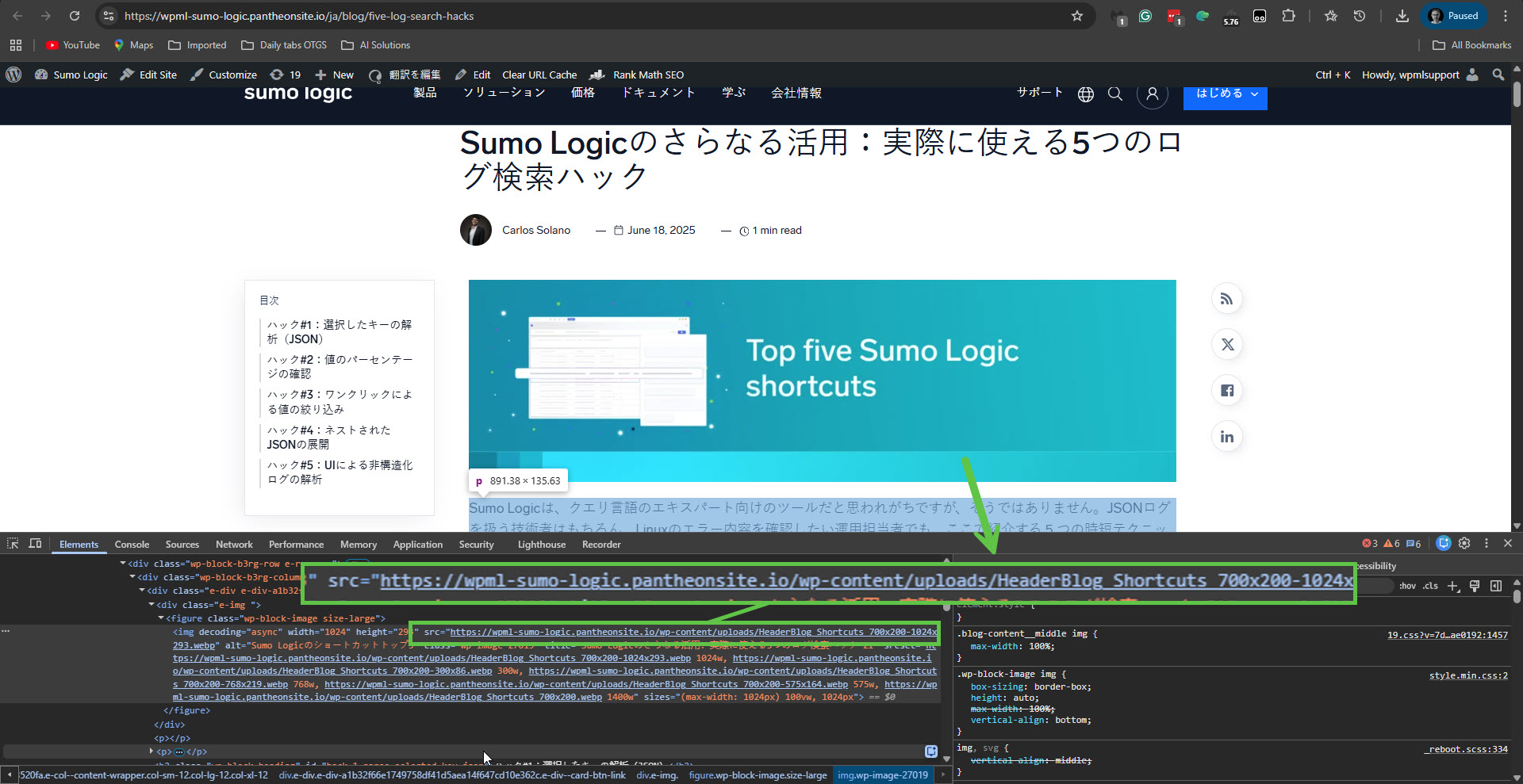

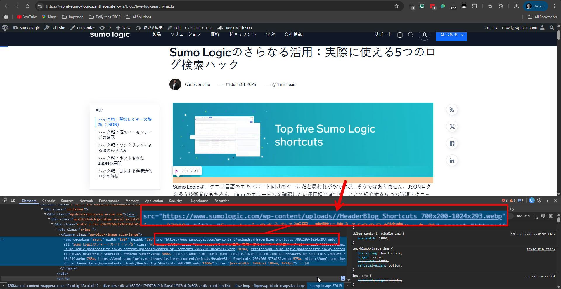

2) Here are some examples. I recently sent to Blend, but they returned with the same issue. On our site reports, I had over 3000 of these, and now we're down to just a couple hundred. So, I know this trick worked before. For some reason it's not working any more. I make the SEO fix to the US version, then send it to Blend. The DE, KO and JP versions come back with the original issue.
Examples - Page has image URL with double slash
- hidden link
- hidden link
- hidden link
- hidden link
- hidden link
- hidden link

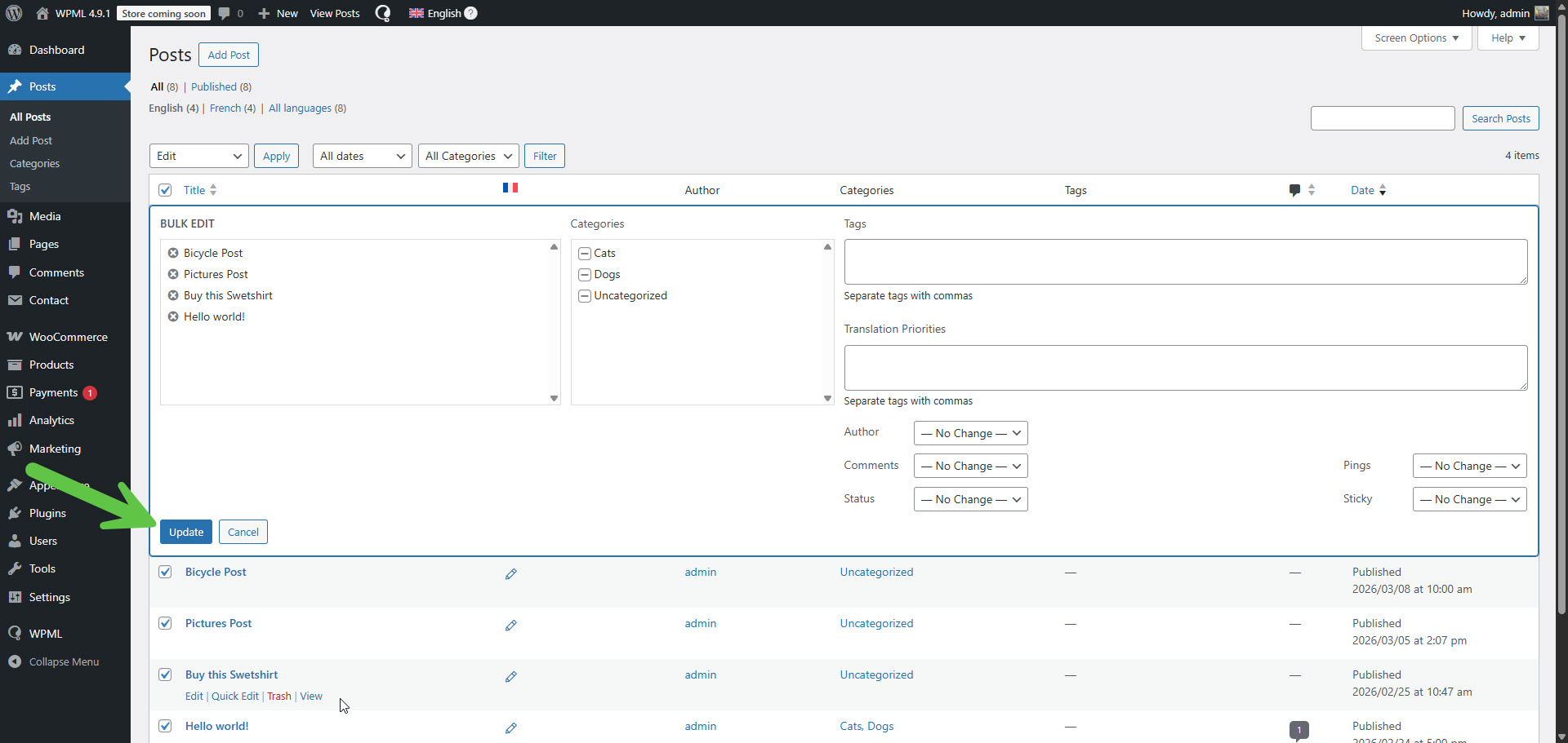

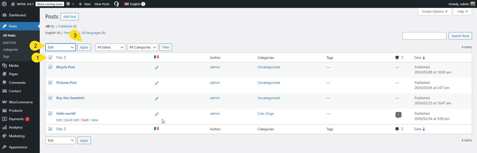

As mentioned in the errata, the suggested workaround is to avoid this problem for new translations. However, I tested the workaround on my local test site and on your staging site. After applying the workaround and updating the original post, the problem was fixed in the translations. For example, this post is in Japanese and was translated by Blend: hidden link. Please see the attached screenshots double-slash-before-fix.jpg and single-slash-after-fix.jpg.
With WordPress, you can update translations in bulk by selecting all posts and editing them at once. Please see the attached screenshot select-to-edit.jpg. Then all you have to do is click the Update button. Please see the attached screenshot update-in-bulk.jpg. This is the batch process you can take to correct the problem. However, if resending the translations to Blend is easier for you, does not carry any extra cost, and fixes the problem, then you can proceed in this way.

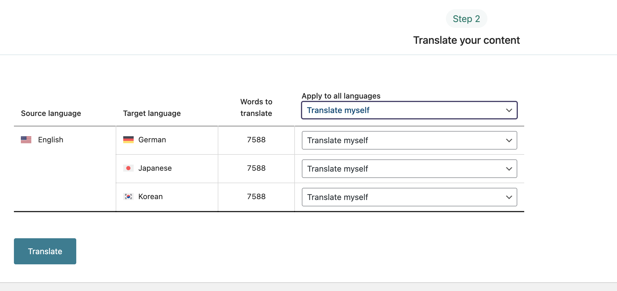

Your screenshots are showing a way to bulk edit posts, which is fine. I was trying to figure out a way to bulk "Save" multiple files once they're assigned to me for translation. This would be on the WPML dashboard, not the posts. If there's a way, let me know. See screenshots. Unfortunately, whenever I send a translation to myself, this whole process can take up to a minute to click through all the screens. if I'm fixing 100 files on the US side, then it'll be 300 files I have to Save individually to update the DE, KO and JP sites.

Assuming that the workaround has been applied, the method I suggested, updating the original English posts in bulk using the WordPress option, should fix the translations as well without doing anything else. This is true regardless of whether the translations were made by Blend.
You are correct, there is no equivalent method or option in WPML -> Translation Dashboard. Furthermore, translations that have been translated with the Blend Translation Service, or any Translation Servicefor that matter, should not be edited afterwards using the Advanced Translation Editor. Doing this is prone to problems. We explain this here: https://wpml.org/documentation/translating-your-contents/using-the-translation-editor/switching-from-classic-to-advanced-translation-editor/#frequently-asked-questions. Please see the question: Can I use the Advanced Translation Editor for pages I translated using another method?
