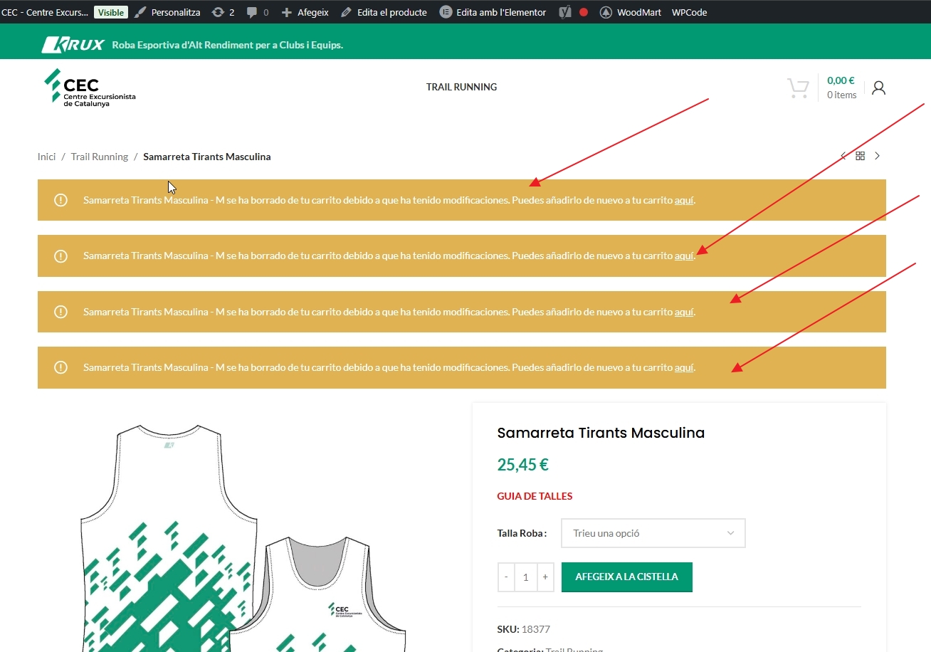

I am trying to switch languages on my website when there are items in the cart. The issue can be seen on this page: hidden link.

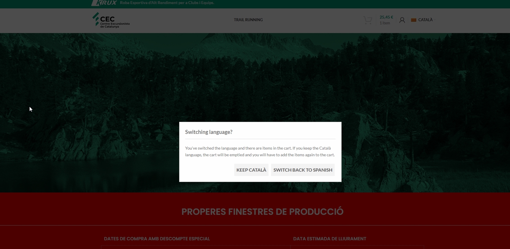

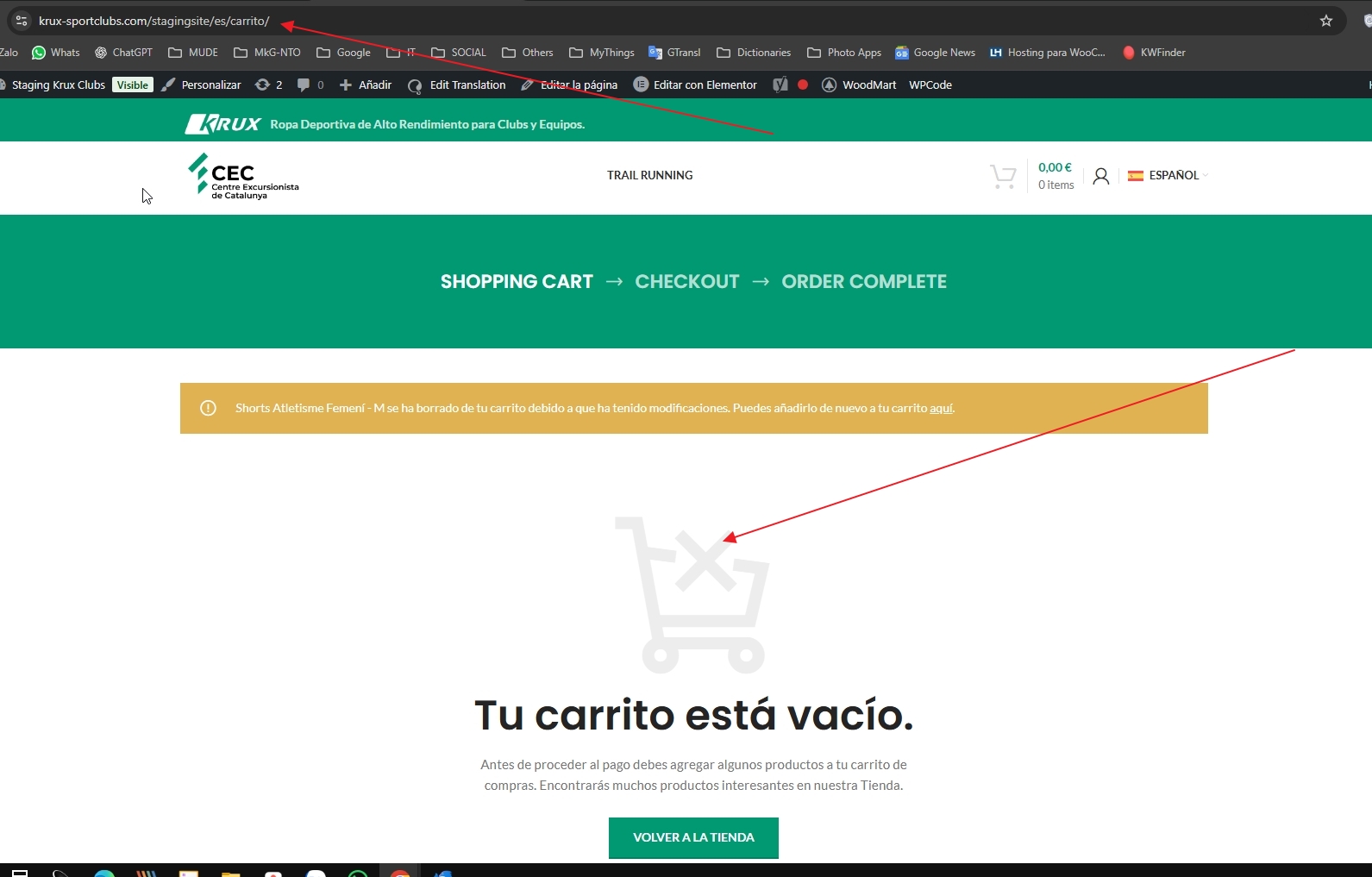

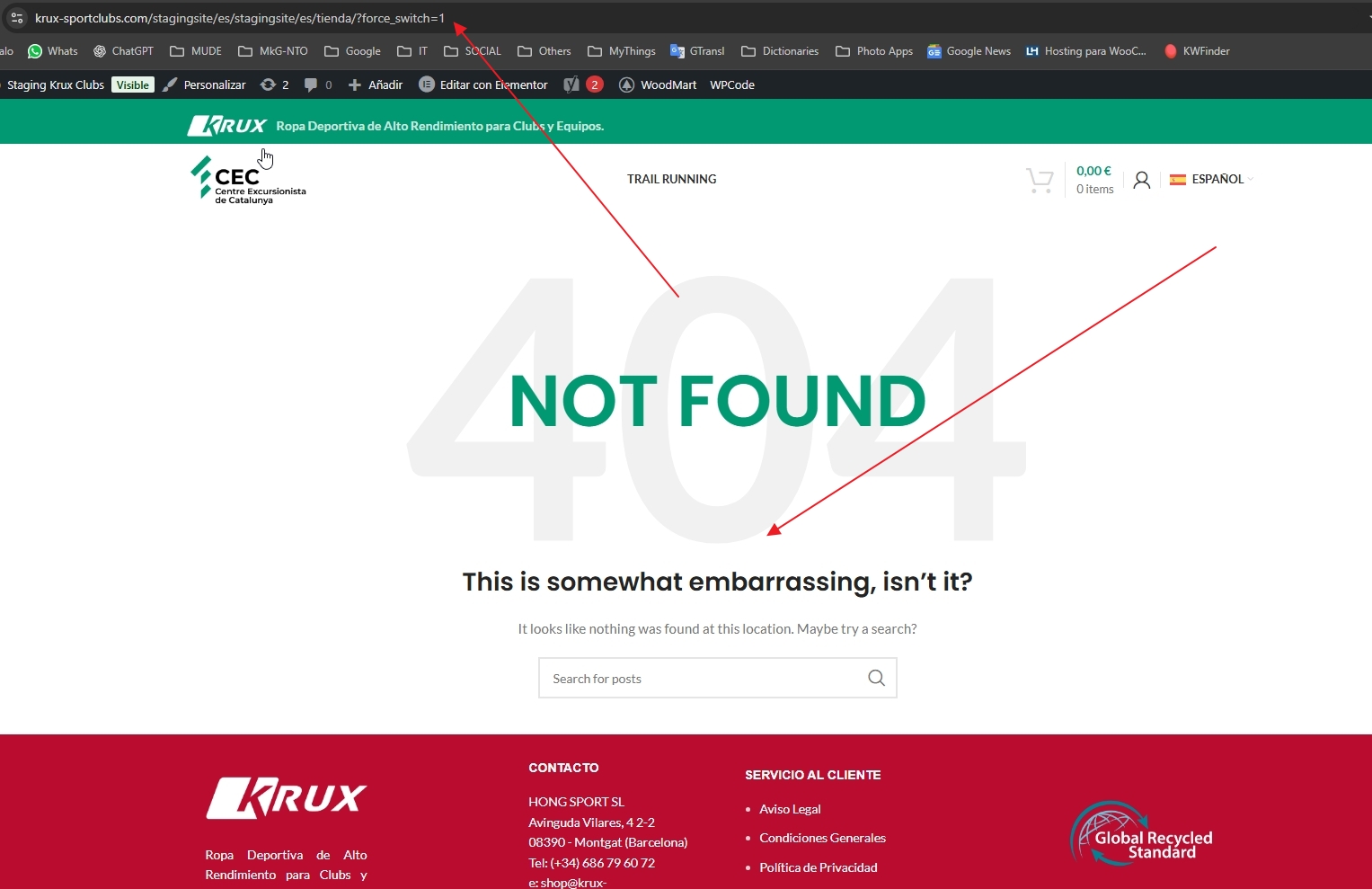

I expected to see a prompt for confirmation before the cart resets. Instead, no prompt appears before the cart resets. After the cart resets, if I do not back to the Shop page and I switch languages, the prompt notice appears but redirects to a wrong URL. Additionally, the removed items notice stays on the screen and cannot be removed.
Why does the prompt not appear before the cart resets when switching languages?
Why does the prompt notice redirect to a wrong URL after the cart resets?
How can I remove the notice about removed items from the screen?

our 2nd Tier team has reviewed your case and determined that a modification to get_current_url is required. This involves replacing the code in:
woocommerce-multilingual/inc/class-wcml-cart-switch-lang-functions.php
Before proceeding, I’d like to confirm whether we have your permission to apply this change. If so, please ensure a backup is created beforehand and let us know once it has been completed.

1) Please make a backup.
2) Modify the function get_current_url in woocommerce-multilingual/inc/class-wcml-cart-switch-lang-functions.php, completely replacing it with this:
	public function get_current_url() {
		/* phpcs:ignore WordPress.CSRF.NonceVerification.NoNonceVerification, WordPress.VIP.SuperGlobalInputUsage.AccessDetected, WordPress.VIP.ValidatedSanitizedInput.InputNotValidated, WordPress.VIP.ValidatedSanitizedInput.MissingUnslash */
		$scheme = is_ssl() ? 'https' : 'http';
		$host   = $_SERVER['HTTP_HOST'] ?? parse_url( home_url(), PHP_URL_HOST );
		$uri    = $_SERVER['REQUEST_URI'] ?? '/'; // already includes the query string if present
		return esc_url_raw( $scheme . '://' . $host . $uri );
3) Test if this works for you.
