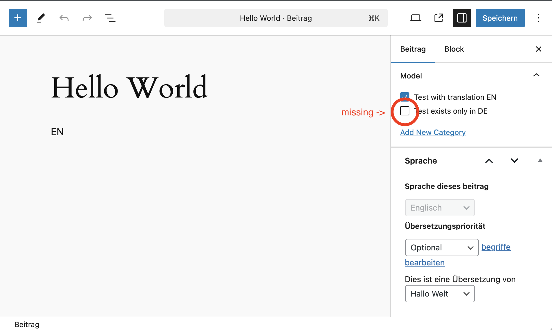

I have a custom taxonomy set to 'Translatable (use translation if available or fallback to default language)'. When I create a post and assign terms of this taxonomy, these terms should be synced across all translations of this post.
Instead, only terms that have a translation in the corresponding language are synced. In languages where the term is shown with its fallback (default language), it is not correctly assigned to the post.
Why are terms not syncing across all translations when using fallback to default language?
How can I ensure terms are correctly assigned in all languages, including those using fallback?

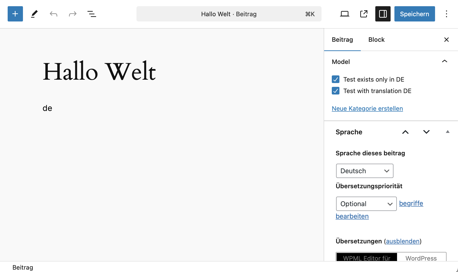

thank you for your reply. You are right, when the post itself is not translated it works. However our use case is a translated post with a taxonomy set to translatable (with fallback). This is important, because the custom taxonomy has over 400 terms where most are the same across all languages.
I think the current behavior is not expected but a bug. As you can see in the second screenshot, WordPress displays the fallback ("Test exists only in DE") as an available term for the english translation. It is just not selected as it should be. If I manually select the term, it is correctly saved to the english translation. Hence I would expect WPML to sync it, as it does with the other terms.

- The term that has an English translation is correctly synced to the English post, the other one is missing (see screenshots in my first message).
