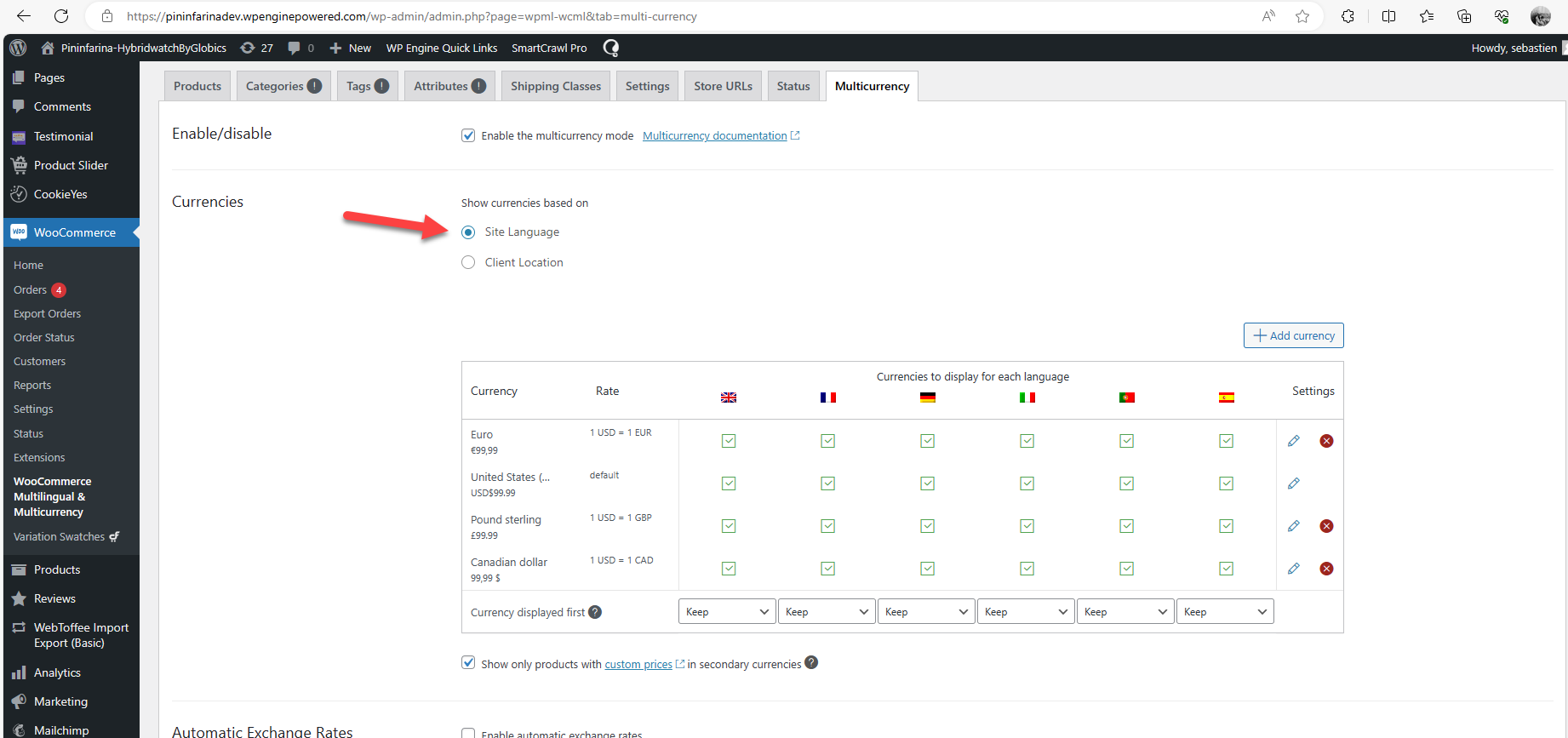

You wrote: "This works when we switch to "Client Location".
I must mention that I based my answer on this fact - "Site Language" is set on the site. I saw this on your site when I checked it while we were in chat. And this is also the setting I see on your site now. Please see the attached screenshot.
