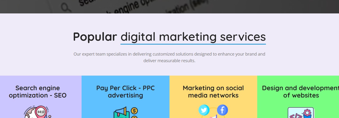

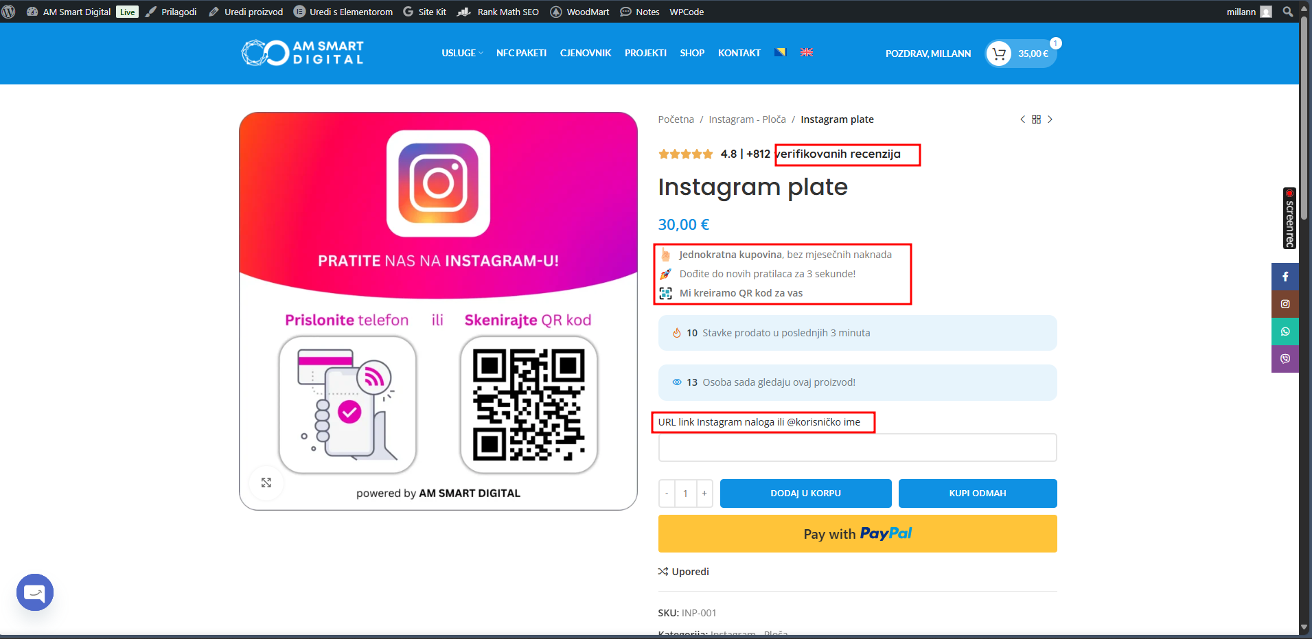

May 21, 2025 at 8:45 pm #17059053
milijanM
See for example this problem here, this text I've boxed in red doesn't appear in the Translate editor. Look at picture 1 and 2.
The text that is framed in red is in the Product Template and as such it is not possible to translate it through elementor and it does not appear in the Translate editor nor can I find it in any way through WPML! Watch the video. hidden link
Product Layout controls the appearance of the first part of the product where the Add to Cart button is, while the second part with tabs and descriptions is fully customizable and can be translated according to current practice using Elementor!
