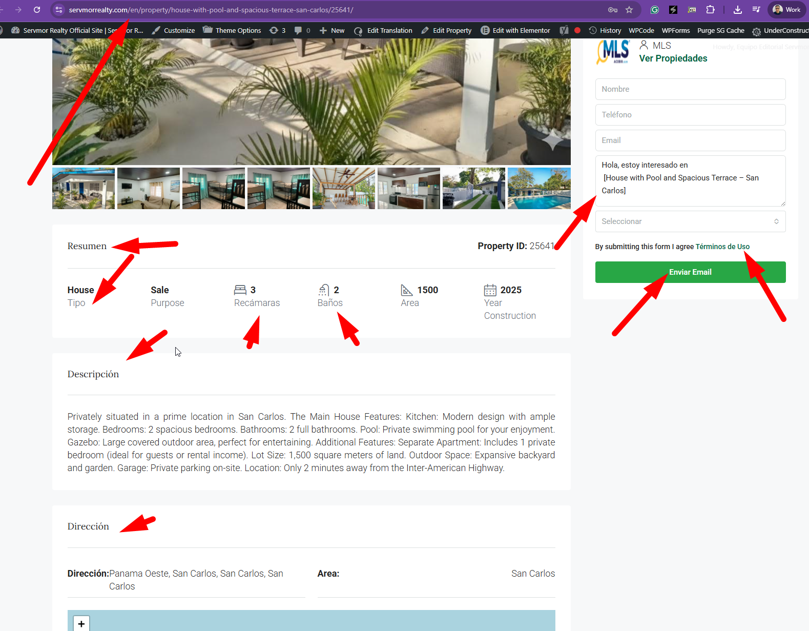

The translations of properties in English are changing and disappearing. I've changed this a thousand times, reported it to your support team in other tickets, and it still hasn't been resolved. The filter for:

I want to assure you that we're doing our best to help resolve this. I’ve rechecked the property page here: hidden link and I can confirm that the strings have reverted back to Spanish, even on the English version of the page.

For this ticket, we’ll focus specifically on Theme Options → Translations that are affecting the strings on the English page here:
(as shown in the attached screenshot).
Our 2nd Tier Support has made progress on your site:
-They confirmed that the strings displayed on the property page are correctly set in Spanish within the Theme Options.
-In String Translation, I also verified that all strings under the domain admin_texts_houzez_options are set to Spanish as the source language.
To change how these strings appear in English, please follow this workflow:
-Go to Theme Options in the Spanish language and update the text in Spanish, then save the changes.
-Navigate to WPML → String Translation and translate those strings into English.
This is the correct and expected workflow for handling these translations.

Thanks, it seems the translations are stable now. I ran the imports and they didn't reset. Let's see how it behaves in a few days.
