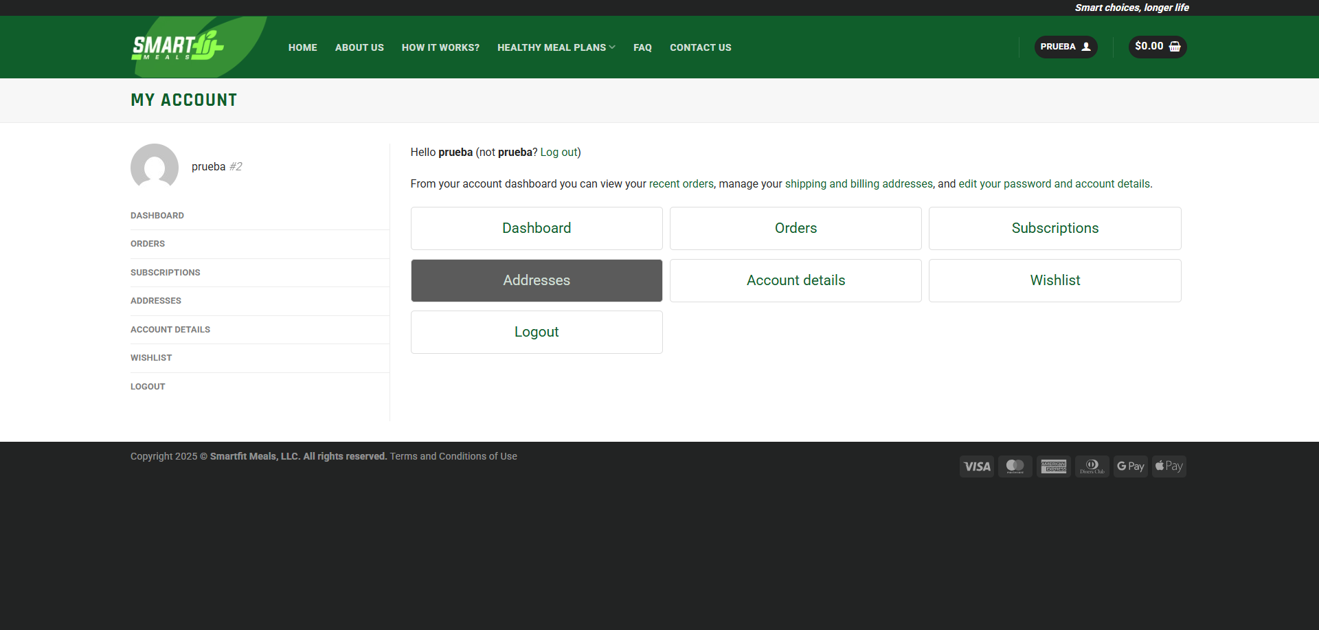

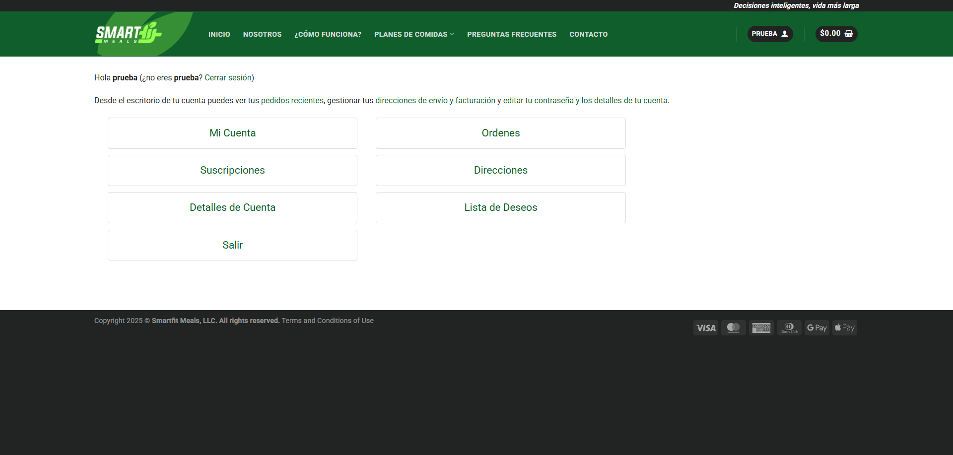

I am trying to ensure that WooCommerce's lateral menu in My Account is visible in the Spanish version. You can see the issue on this page: hidden link
WooCommerce's lateral menu in My Account is not visible in the Spanish version.
Why is the WooCommerce lateral menu not showing in the Spanish version?
How can I make the WooCommerce lateral menu visible in the Spanish version?

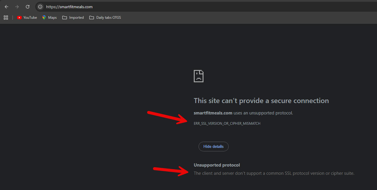

I can see your site hidden link, I get the ERR_SSL_VERSION_OR_CIPHER_MISMATCH error with these details: Unsupported protocol
The client and server don't support a common SSL protocol version or cipher suite.
Please see the attached screenshot. I tried with another browser and the same happens.
Please proceed with the following.
We suspect a collision with the theme or another plugin might cause this problem. If possible, get your site into a minimum environment, switching to the default WooCommerce theme Storfront and having no plugins activated except WPML.
First, you must check if the problem persists when just the theme is switched to the https://wordpress.org/themes/storefront/ theme. If it persists, deactivate all plugins except WPML and its add-ons and WooCommerce without any extensions. Then, please check if the problem persists. If it does not continue, start by activating the plugins individually and checking when the issue comes back, then report to me which plugin was the culprit.
If this does not help to lead to the problematic plugin, please correct the problem on your site (ERR_SSL_VERSION_OR_CIPHER_MISMATCH) and give me access to it.

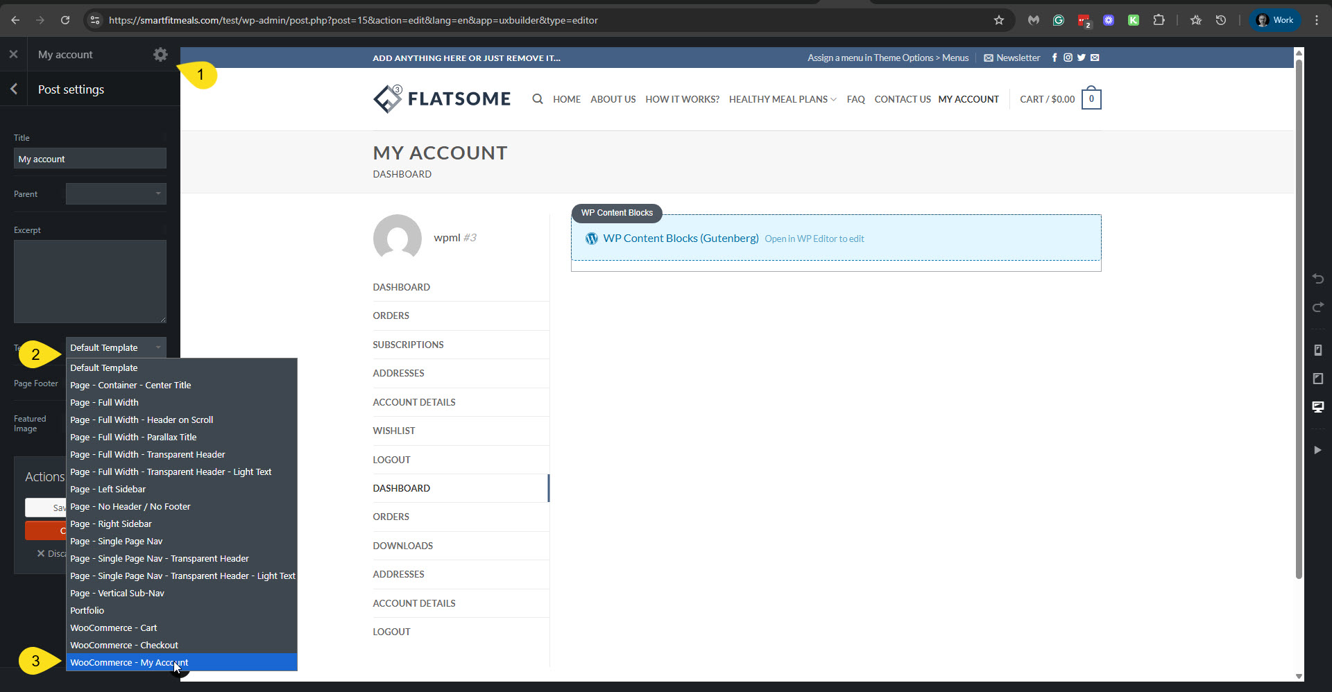

1. Edit the English page with the UX Builder.
2. Edit the post settings.
3. Change the template from 'Default Template' to 'WooCommerce - My Account' template. Please see the attached screenshot.
4. Exit the settings and update the changes.

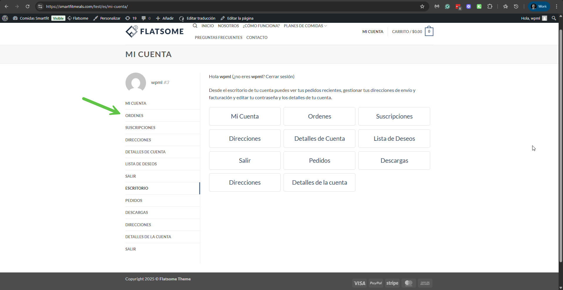

Refresh the Spanish My Account page and see that the sidebar is showing. hidden link. Please see the attached screenshot.
Please confirm that this issue is fixed now.
Please be aware that this issue is not because of WPML.
Itamar.
August 28, 2025 at 11:44 am #17354859
alaidA
Thanks, it works now.
