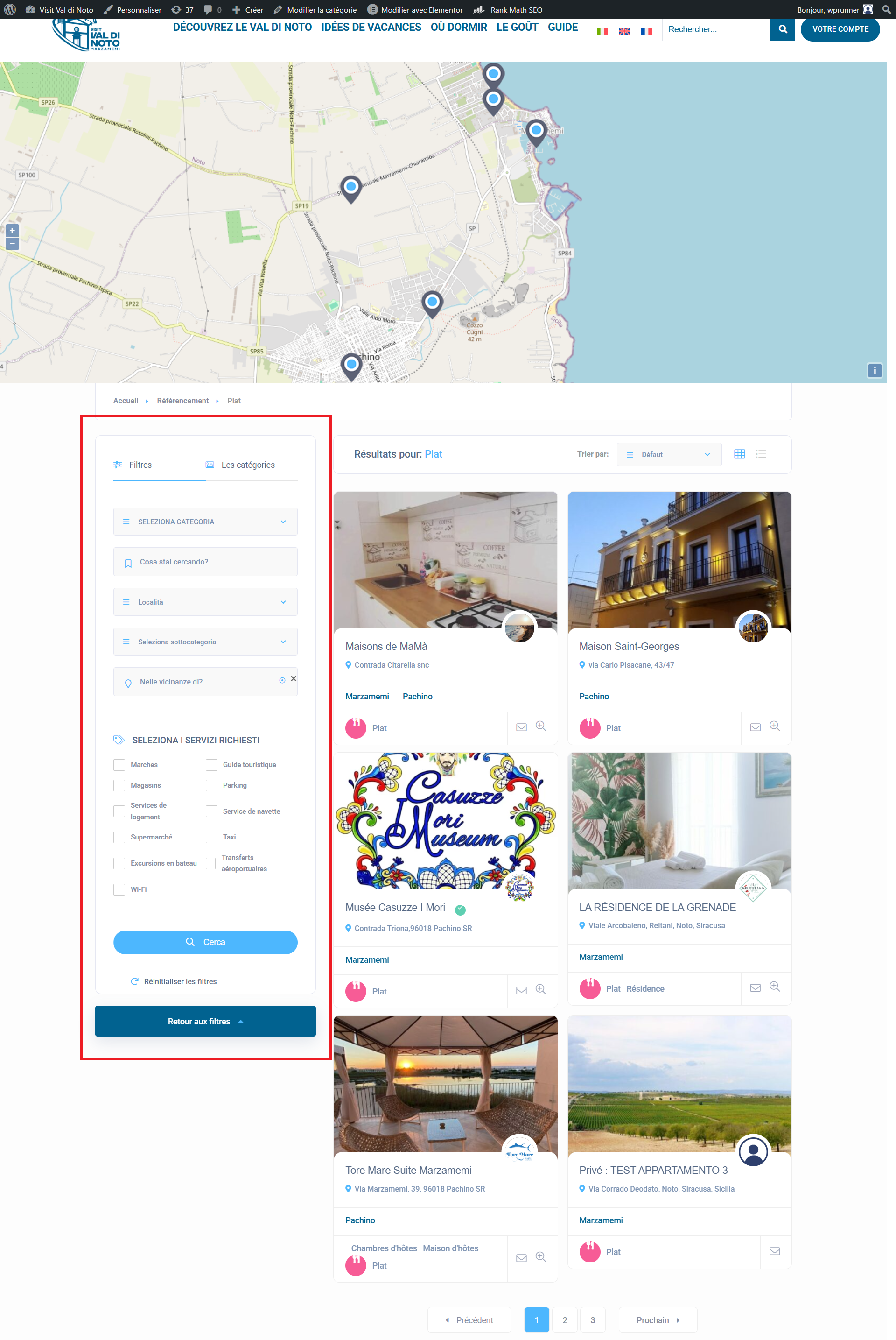

I am trying to translate the listing category search filters on my site hidden link using WPML. I have provided a link to the specific page where the issue occurs: hidden link. I have also provided a screenshot.
The listing category search filters are not translating.
Why are the listing category search filters not translating on my site?
How can I fix the translation issue with the listing category search filters?

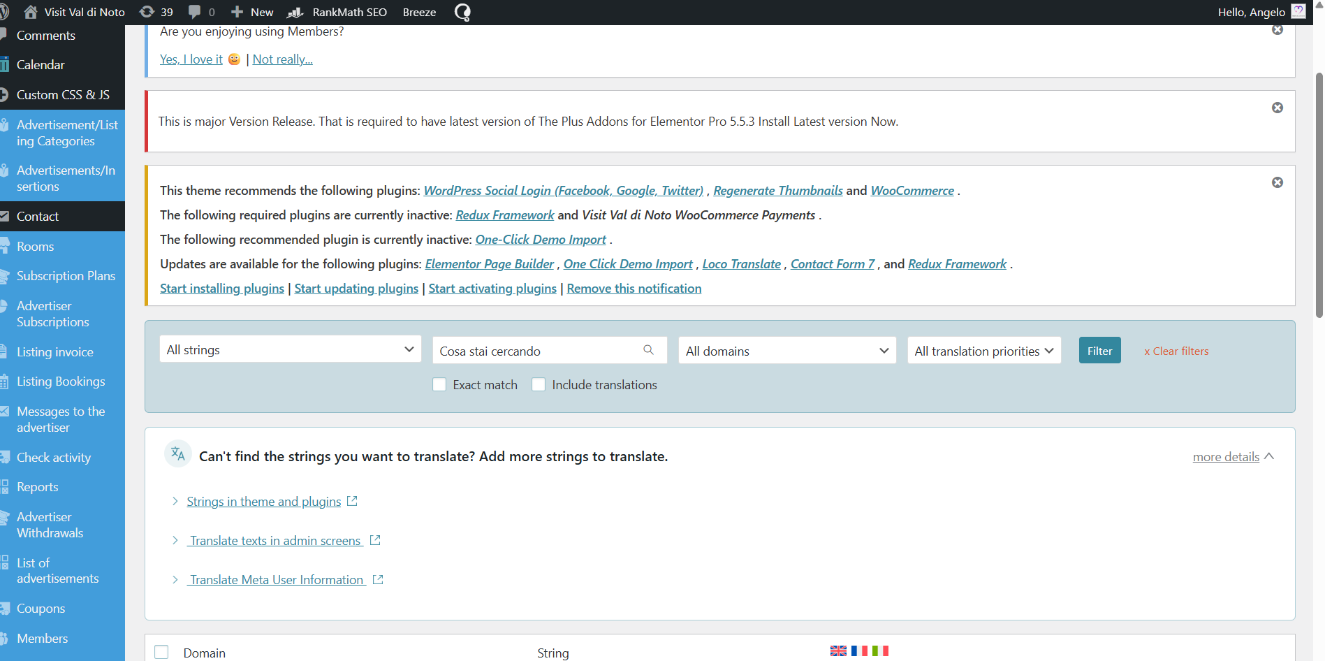

angeloS-19
Hi Kor,
Thank you for your reply, I've scanned the theme strings however, the labels are not available on string translation. If you could please check this for us?
