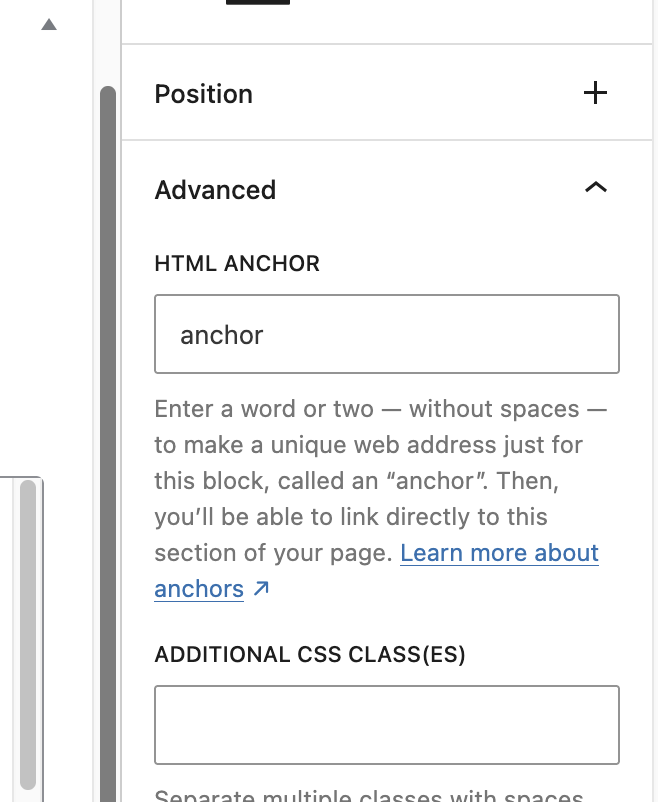

To reproduce:
- add a group block
- change the HTML element in the advanced settings from div to section
- add an ID / HTML anchor to the group
- translate the page using ATE
The anchors don't show up as translatable. They are manually translatable using the WordPress editor, but those changes are overwritten as soon as I use the ATE again.

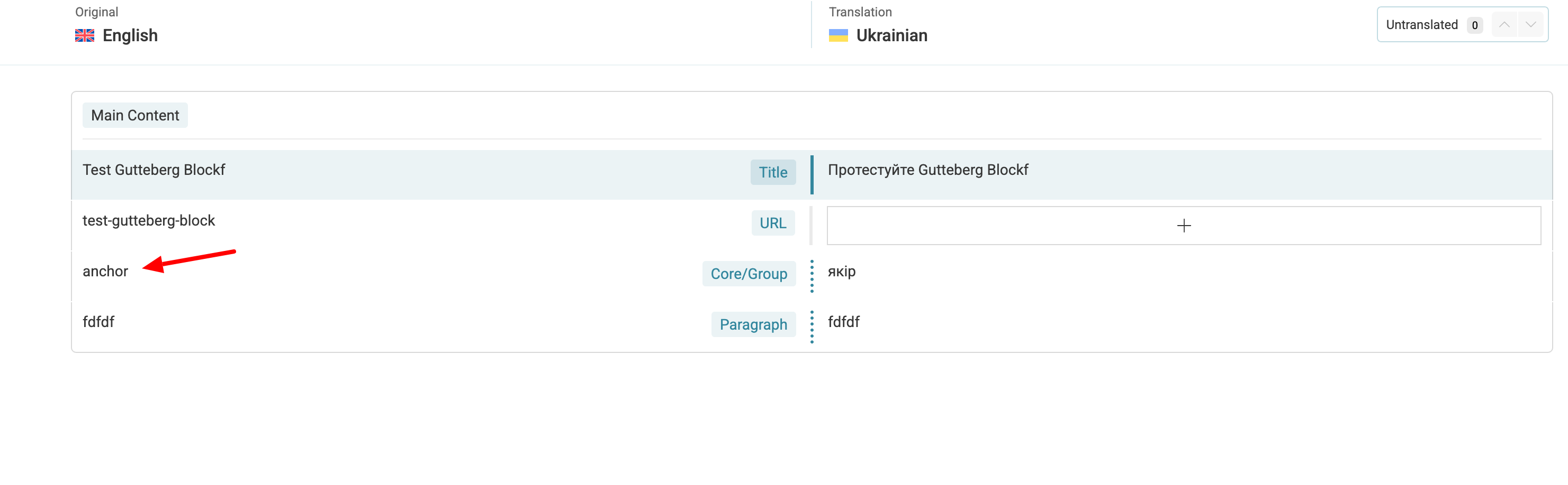

I have done a few tests, and the following config should work:
<wpml-config>
  <gutenberg-blocks>
    <gutenberg-block type="core/group" translate="1">
      <xpath>//section/@id</xpath>
    </gutenberg-block>
  </gutenberg-blocks>
</wpml-config>
I have attached the screenshots for your review.
