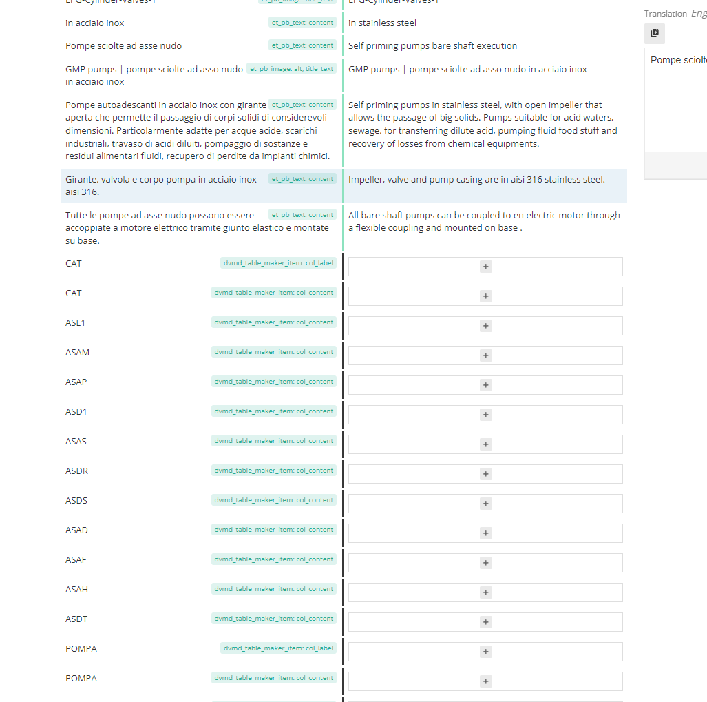

I've inserted the custom XML configuration here hidden link and it should display on the "Advanced Translation Editor" now as shown in the attached screenshot.

Hello, thanks for your support. Now the translation of the tables works on that page.
But we still cannot see the table header terms (and other datas) on pages like this one:
for example, there is no "prestazioni" term, in the Advanced WPML Editor, for that page.
How could we translate terms like that?

You need to make minor changes to the page so that it refreshes the "Advanced Translation Editor". You can check now.

Hello, I re-saved the IT page to make the table strings appear in the editor.
I modified the texts through the editor, ticking off those that did not change and translating only one header column for test (MOTOREX EN).
The result however is not good, you can see all the codes inside the cells, as you can check here:
Thanks.

I have feedback and this is the correct XML configuration file. Kindly insert the custom XML configuration below into WPML > Settings > Custom XMl Configuration. Then, make minor edits to the primary language page and translate the page again and it will display correctly.

Hello, now it works well! I close the task.
