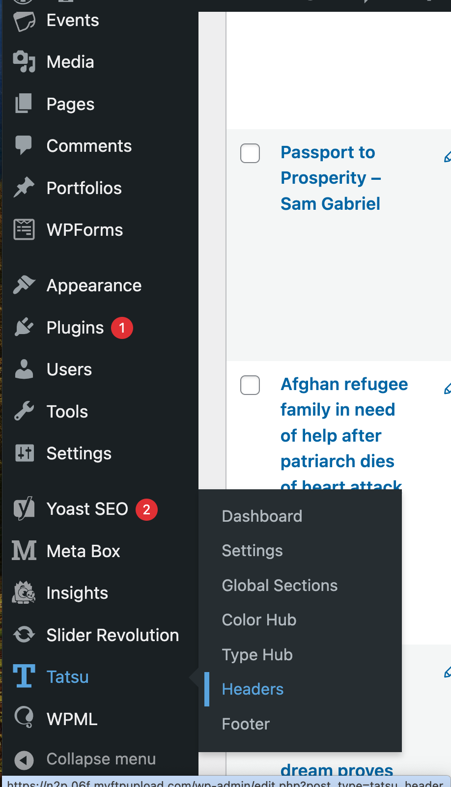

Also, if there was a "duplicate " check box or a "pencil" icon, what is the next step after that? Because when I click inside "Tatsu" editor, there is no place to add manual language translations.
Also, in addition to the 8 pages.... how would I translate the language of the 9 posts, 1 contact form, and the Tatsu header and Tatsu footer? The Contact form is created with WP Forms and the Tatsu Header and Tatsu footer are located in the WordPress dashboard underneath Tatsu > Header and Tatsu > Footer (screenshot attached).
That would be SO amazing if you could perform the manual translation from beginning to end for one of the pages & the Tatsu > header in real-time and record it for me, just so I can see the process from beginning to end and then I would not have to bother you anymore. haha. 🙂
