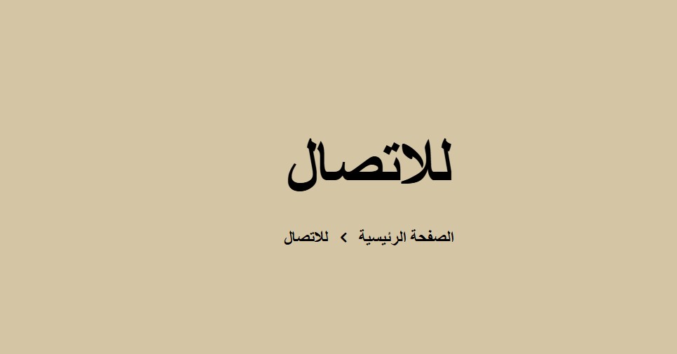

I am trying to translate the Google breadcrumb on my website after scanning the themes and plugins multiple times. I have attempted various solutions before reaching out to support. The issue is with the translation of the 'home' keyword, which seems stuck. I have already made the necessary changes in string translations and the admin area, but it still shows in English when the website is in Arabic. Here is a screenshot of the issue: hidden link. The issue can be seen on this page: hidden link
The 'home' keyword in the Google breadcrumb is not translating to Arabic and remains in English despite making changes in string translations and the admin area.
How can I translate the 'home' keyword in the Google breadcrumb to Arabic?
Why is the translation not appearing despite making changes in string translations and the admin area?

Thanks for sharing the login details. I followed the below steps:
1. Went to WPML >> Theme and Plugins localization page.
2. Scan the parent “RiseHand” theme.
3. Went to WPML >> String Translation page.
4. Searched for the “Home” string, added the translation, and now it seems to be working correctly. You should be able to update the translation from here, if needed: hidden link
Could you please check and confirm?
May 5, 2025 at 6:51 am #16994568
emirates-literatureF
NOMAN i did this and it was not showing in string translation, and I tried to scan the theme many times, I don't know, but anyway, problem fixed now al hamdulilah. Thank you so much brother, much appreciate it and have a great one!
