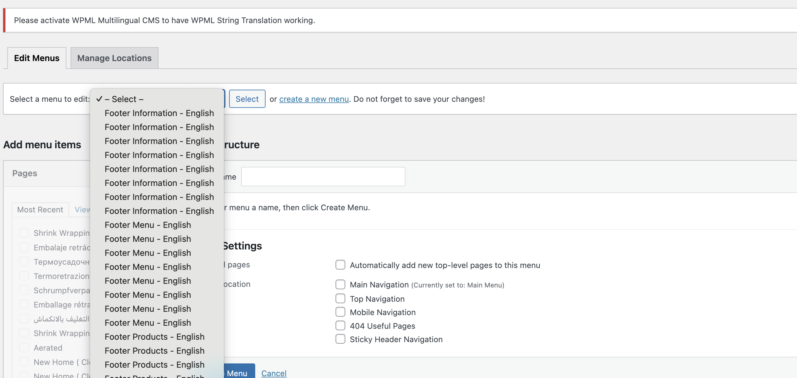

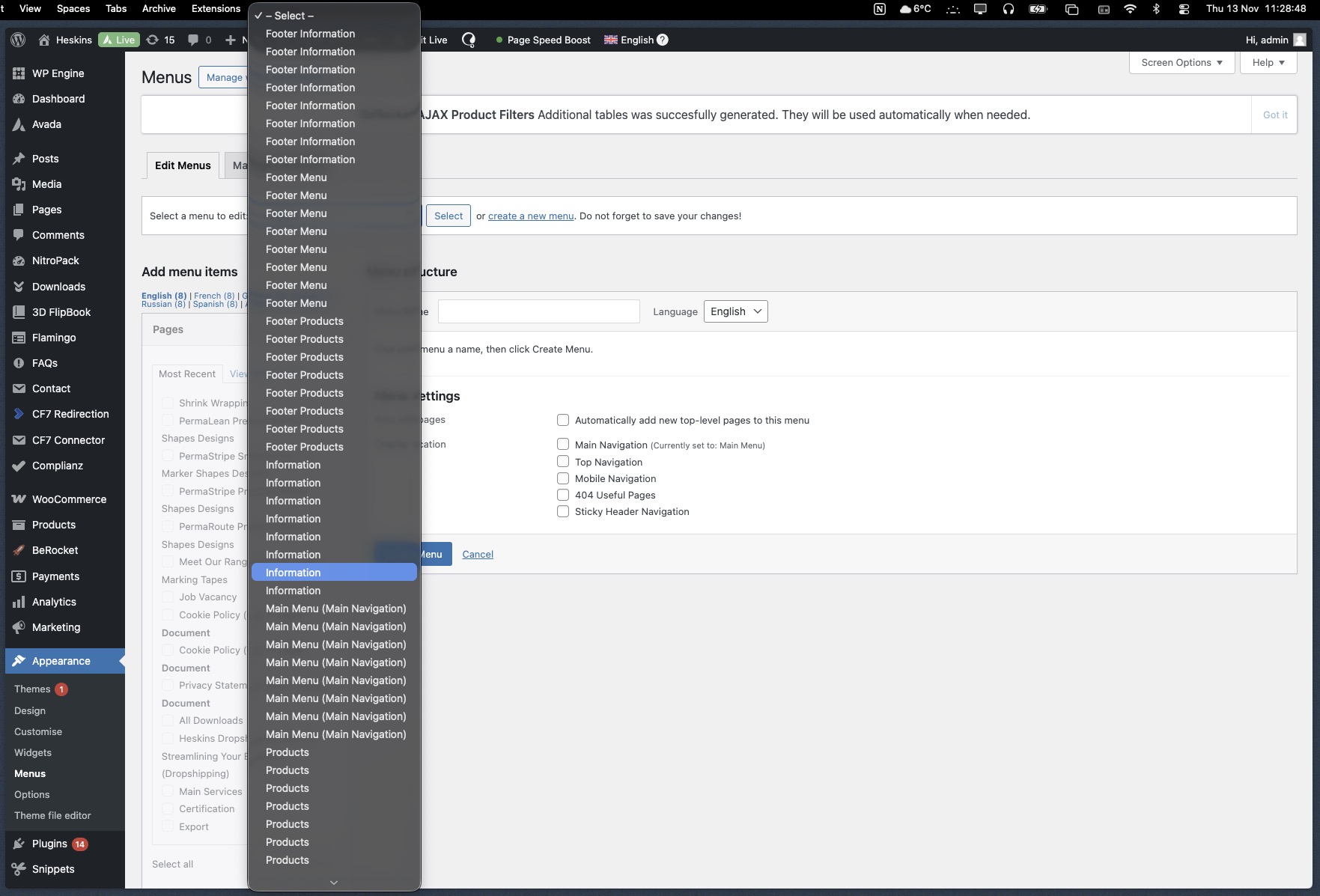

It works. Nonetheless, the issue is not present on the staging website, so there's nothing for me to check there as well. I re-analyzed the live website and noted that the multiple items that show inside the menu, are not actually menus from other languages, but repeated occurrences of the existing menus for the selected language. Check the image.
Ensure to have a backup, and please make the following test:
1. Open Appearance > Menu, so that you see the multiple repeated menus. The issue in the image.
2. Deactivate WPML and reload the Menus page. Check if the issue is still there;
Let me know how it goes.

Yes that screenshot happens a lot and is the main part of the problem. We either get that screen or no menus…
I’m away from the desk but is there a reason that it either fine for 10mins yesterday?

November 13, 2025 at 2:04 pm #17575292
larryL-9
I deactivated the PML plugin and visited the menus - screenshot attached. This is exactly what I expected to see because without WPML to categorise them - the menus still exist?
