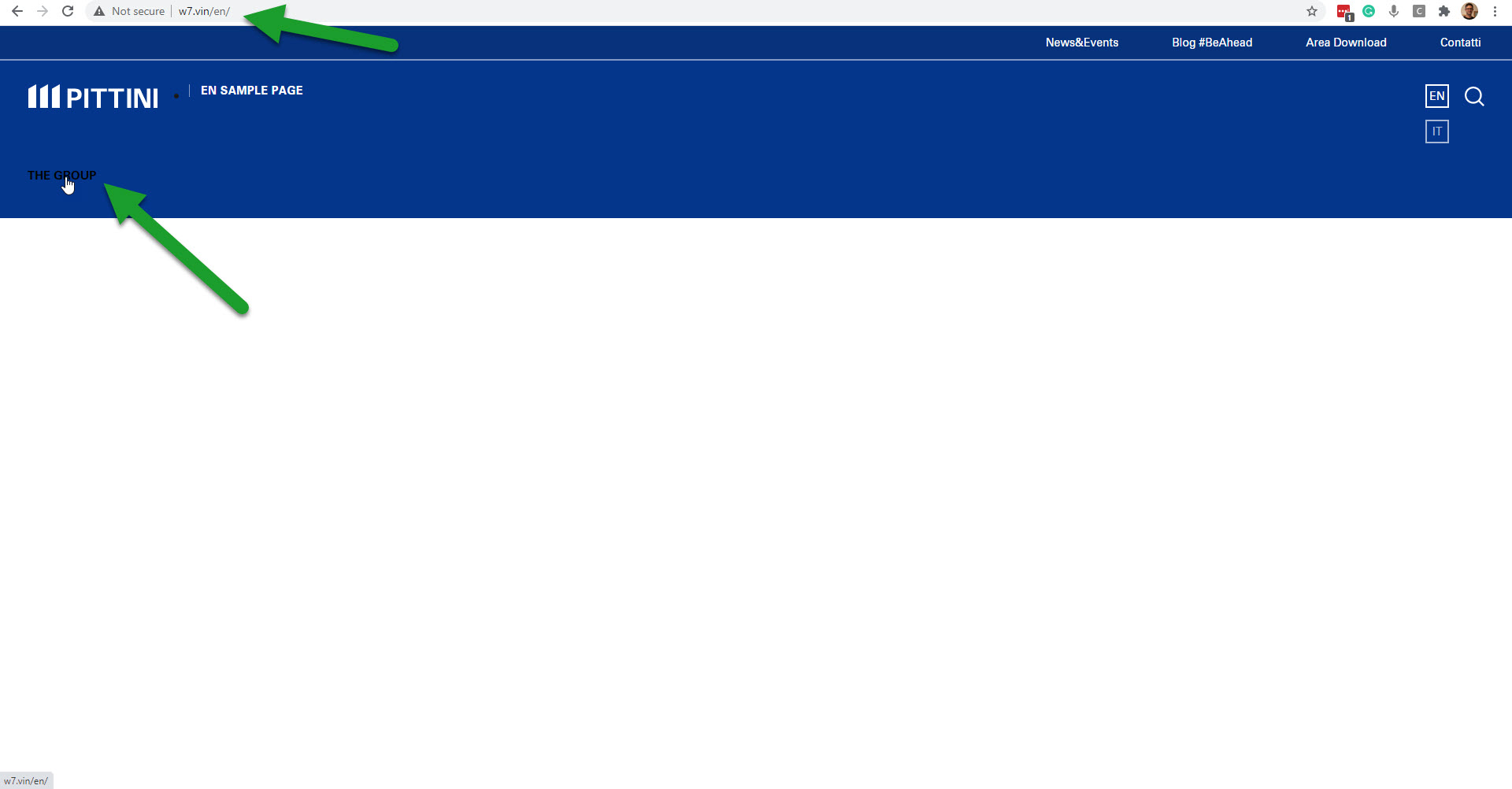

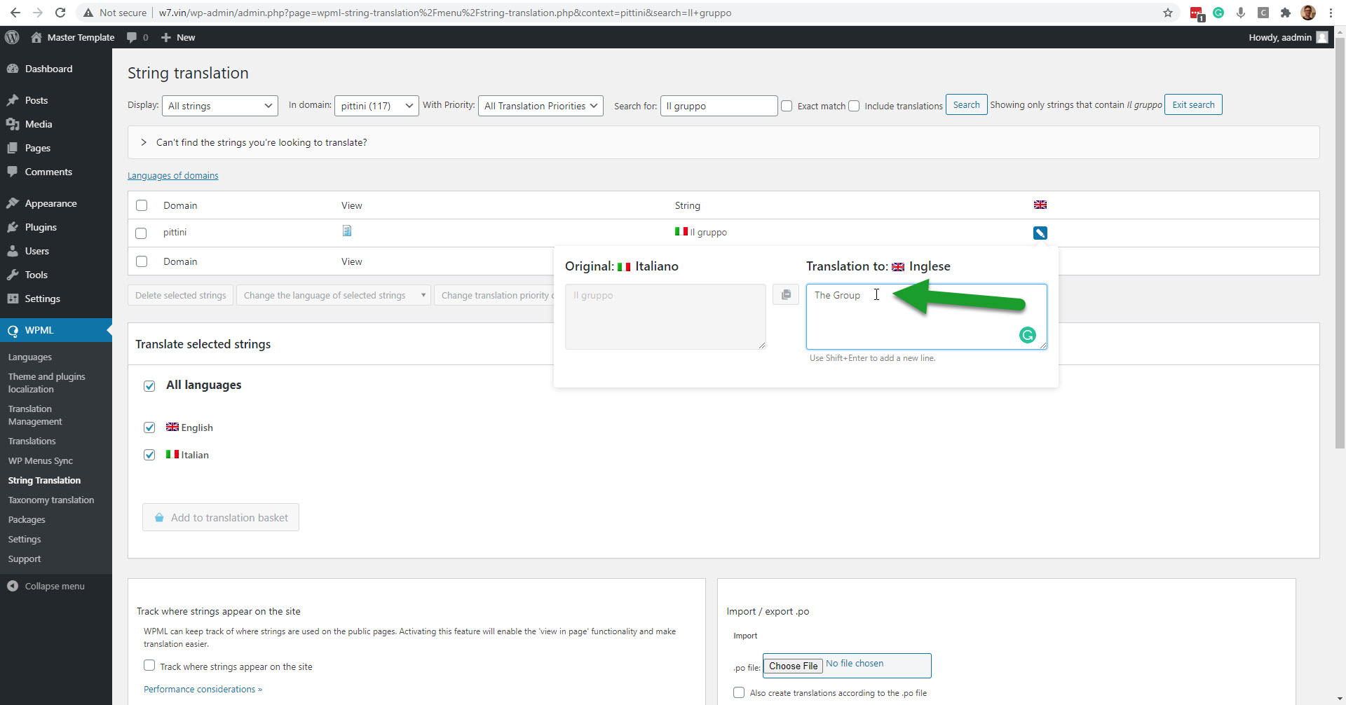

I was able to install it on my local test site. It didn't work well probably because of some custom settings that you have on your site. Nevertheless, I was able to check the issue with the strings that are not showing the translation on the front-end. For example, I used this string:
<li><a href="<?php echo get_page_link(icl_object_id(20, 'page', false)); ?>"><?php esc_html_e('Il gruppo','pittini'); ?></a></li>
And when I translate it in String Translation after switching the language of the string into Italian the translation shows on the front-end. Please see the attached screenshots Il-gruppo-in-st.jpg and the-group-in-en.jpg.

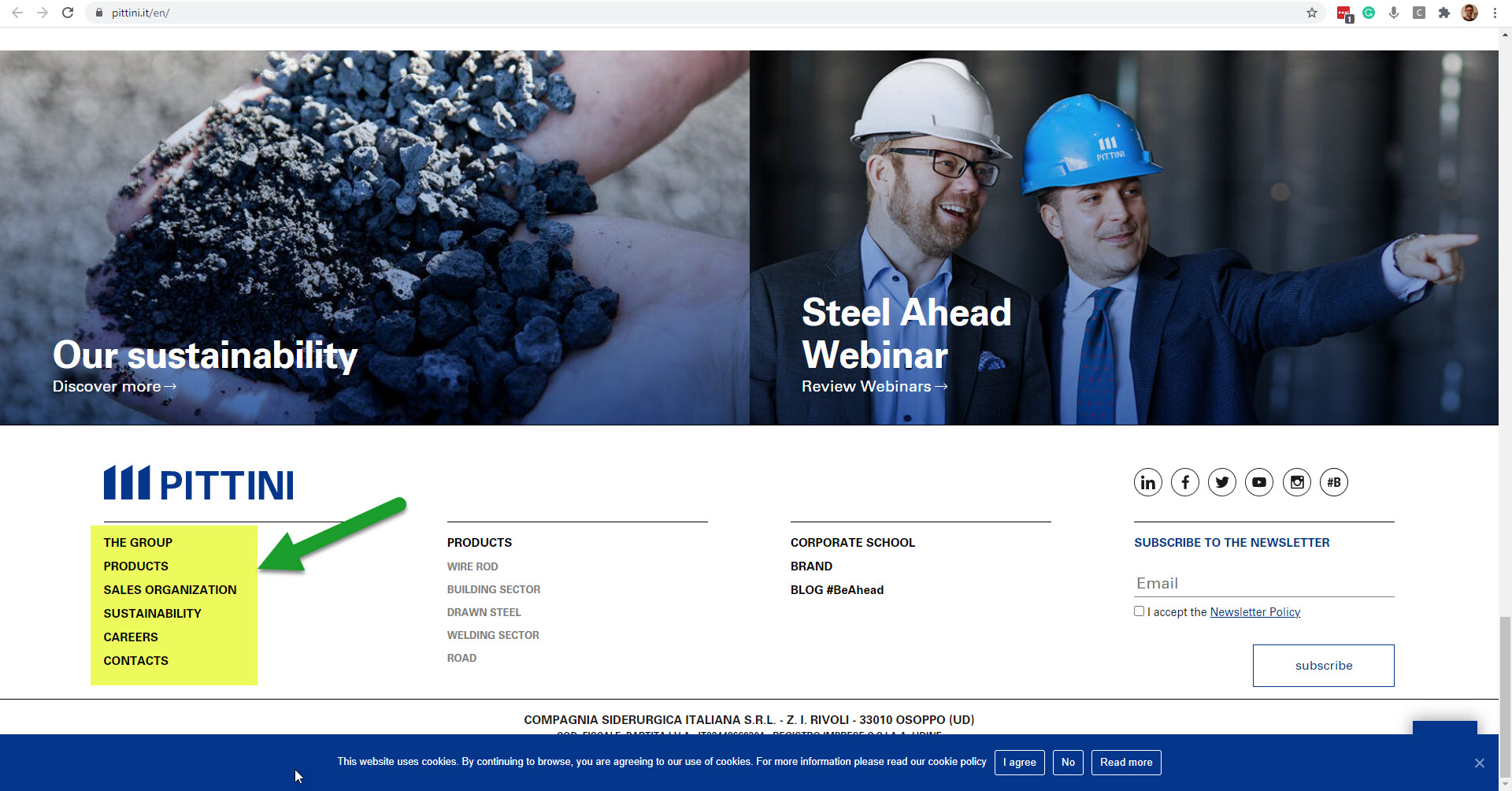

Then I rechecked it on your site, and I can see that those strings in the footer are now also translated. Please see the attached screenshot footer-ok.jpg.
Have you solved this problem already?

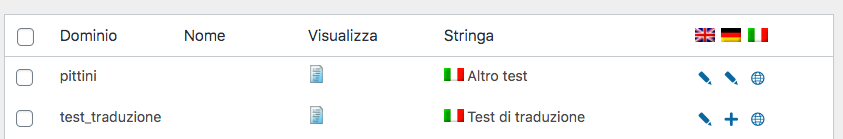

I wasn't able to fix the problem, I went on and used Loco Translate to quickly address the issue of missing string translation. As of now I still don't find a way to fix it, I tried various solution but, while in the backend I see all the strings and I can even scan for new ones, in the front end they are not translated. I'm testing only for my user id some strings in the footer:
<?php  $user = wp_get_current_user(); if ($user->ID == 1) { ?>
<?php _e('Test di traduzione','test_traduzione'); ?>
<?php _e('Altro test','pittini'); ?>
<?php } ?>
so these are new and not scanned by Loco, just by WPML String translation.
As you see in the screenshot those are translated but still show up in the original version.

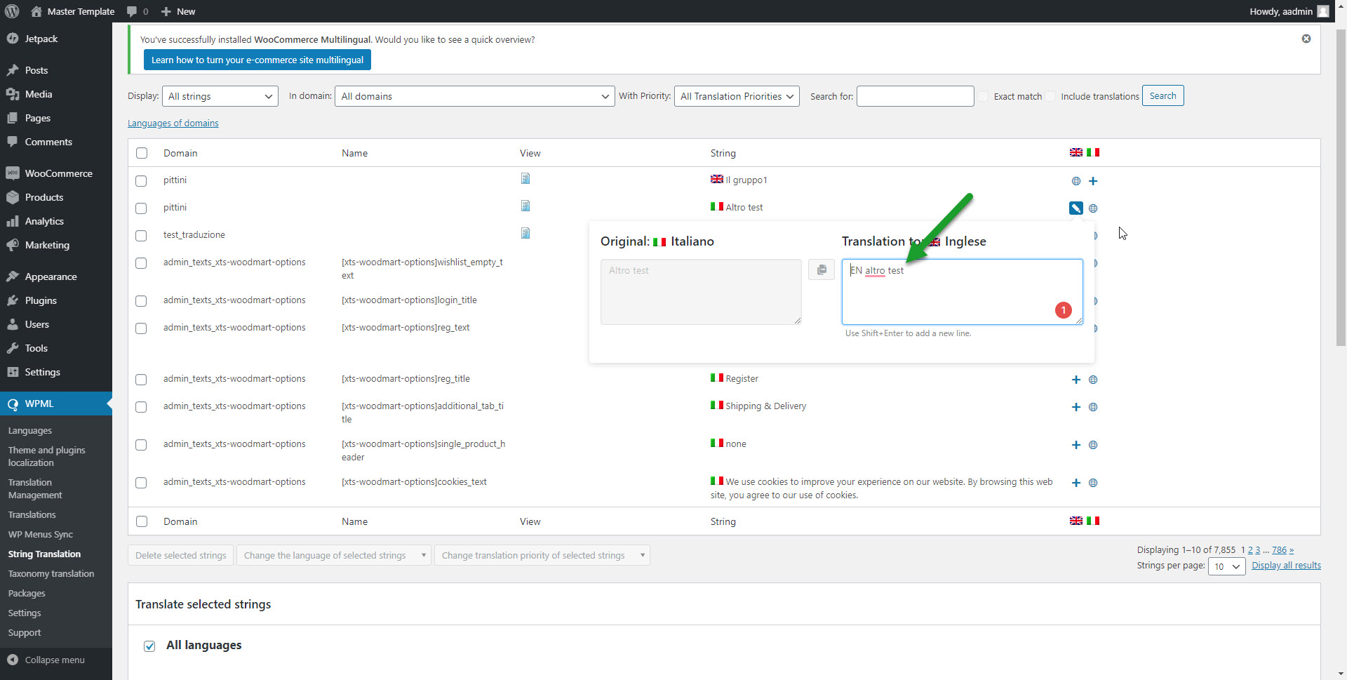

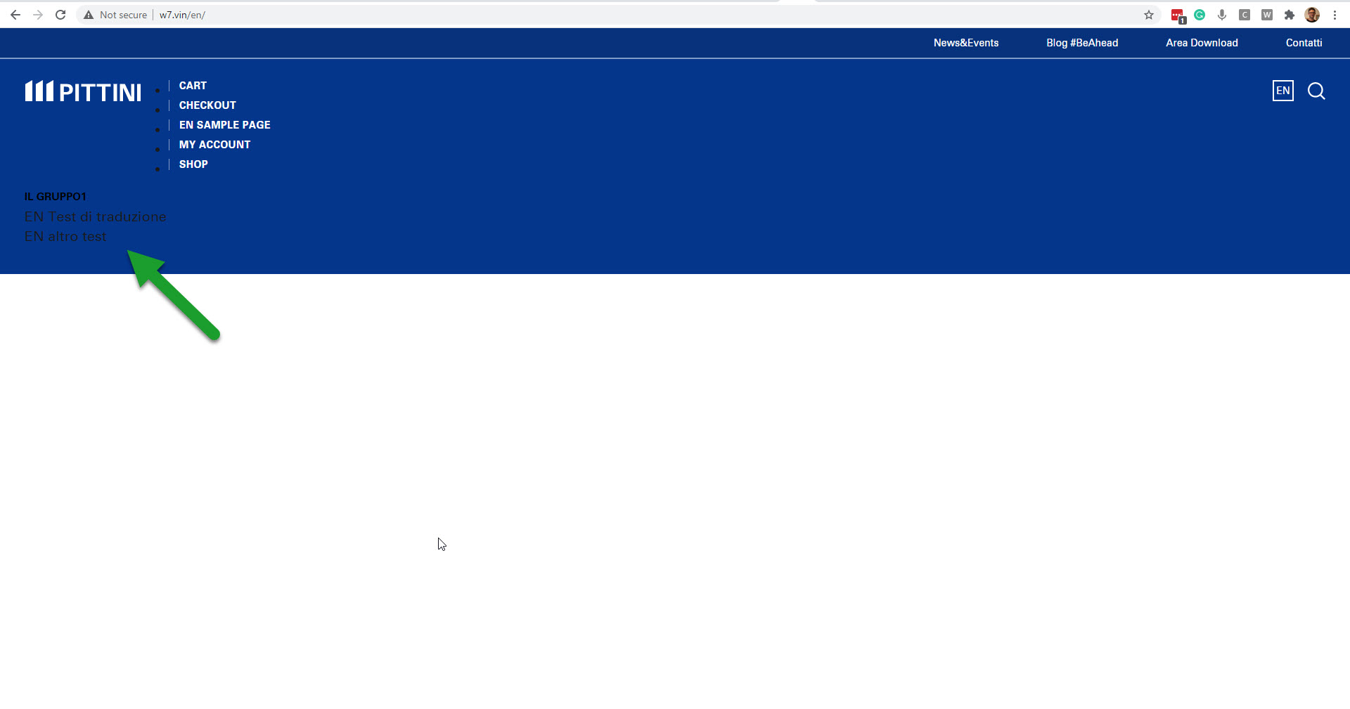

Still, I was not able to replicate this problem on my test site. As I mentioned, I could not make your theme work as it works on your site. For example, the footer is not showing on my local site. But I added those same strings to the header of the site by inserting them on the header.php file like that.
<li><?php _e('Test di traduzione','test_traduzione'); ?></li>
<li><?php _e('Altro test','pittini'); ?></li>
So in this case, it working and I can see the translations from String Translation on the front-end. Please see the attached screenshots.
