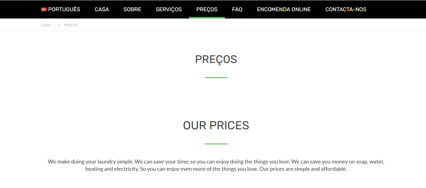

I created the site in English and then installed WPML to translate it to Portuguese and potentially other languages. I followed the documentation provided by WPML.
The home page didn't translate. On other pages, such as hidden link, the title was added in Portuguese but the English one remained, and the content didn't translate. The site uses Elementor.
What am I doing wrong?

Carlos Rojas
WPML Supporter since 03/2017
Thank you for sharing the access credentials.
The Elementor elements used in the page weren't registered. I registered the ones in the Prices page by following the steps described in this guide: https://wpml.org/documentation/support/multilingual-tools/
Can you confirm that the issue is solved?
