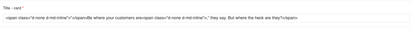

I have checked the XLIFF file extracted from your hidden link and found it is invalid because of this line
<span class="d-none d-md-inline">"</span>Be where your customers are<span class="d-none d-md-inline">," they say. But where the heck are they?</span>
I think if you removed the span that surrounds the quotes and sent the content again the issue will be resolved as it is confusing the segmenter.
Please change this line to be:
"Be where your customers are" <span class="d-none d-md-inline">, they say. But where the heck are they?</span>
Like this, the quotes are handled in a better way. Please send the content again and let me know how it goes.

Hi. I have tried to remove that string and send it to smartling but I still can't see it in smartling.
I've removed the translation + the strings you mentioned and a few more strings and still it doesn't show up.
