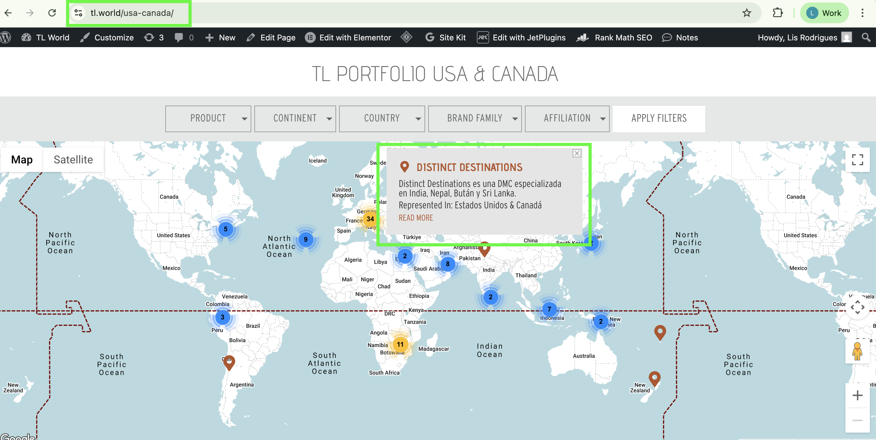

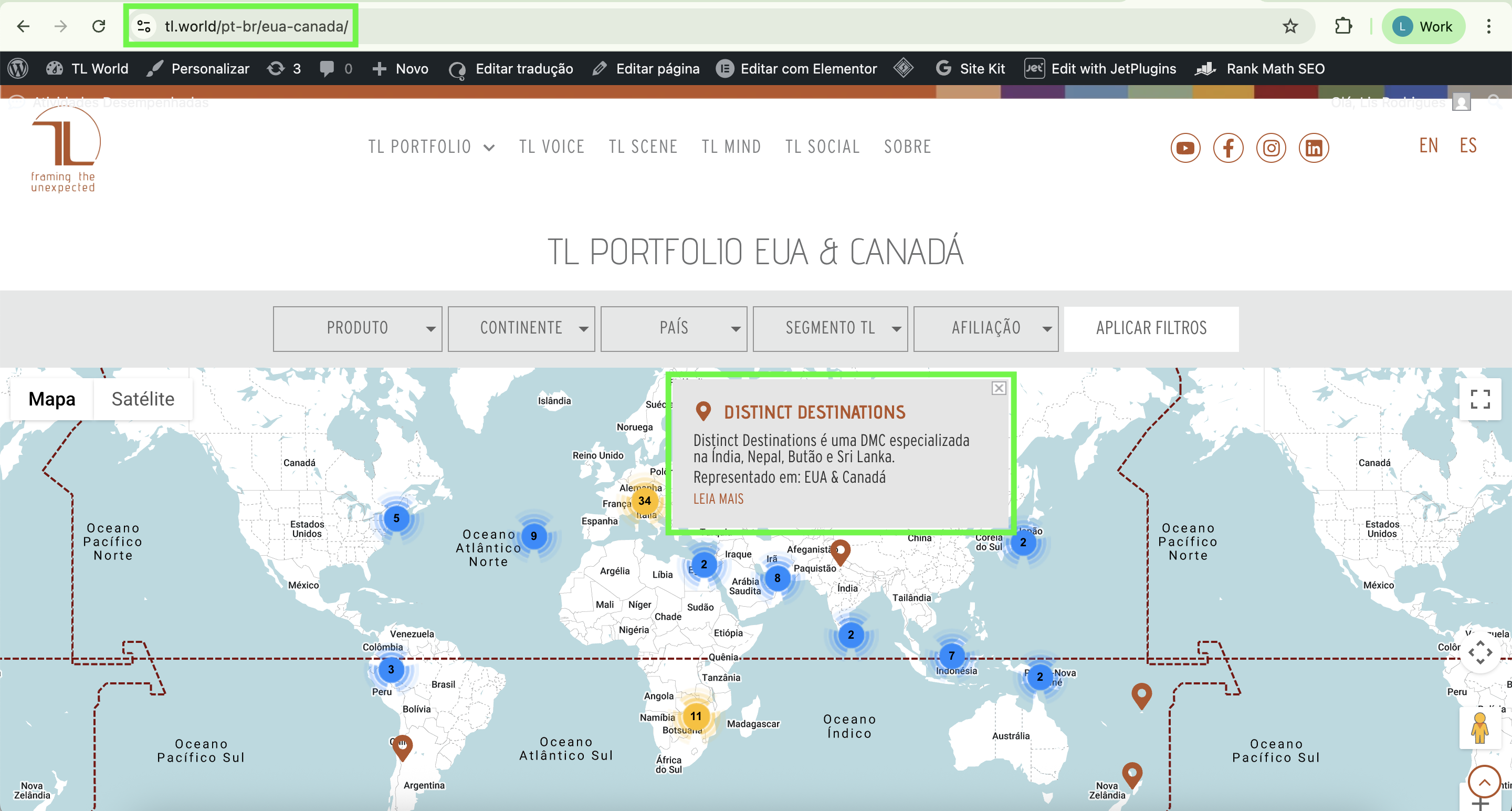

The pop-ups within the maps are not being translated correctly. For example, in the English version, it displays the text in Spanish. In the Portuguese and Spanish versions it displays the results correctly. The main language is English.
I translated the listing and also the posts.
* The content of the pop-ups is the result of a relation in Jet Engine: CPT Products vs CPT Products Location.

After analyzing your website more thoroughly, I noticed that inside the Elementor editor for the listing item (List Products Location MAP), the information is already being pulled in Spanish, when it should be in English. This indicates to me, that the issue arises from the JetEngine Relation.
I've explained it in more detail below. Please check the video:
To confirm that, I need you to please test if pulling the information for the Listing directly from the Post Types, instead of the relation, will change the behavior. Make sure to have a full website backup before testing anything, and let me know how it goes. Thanks in advance for your cooperation.

Yes, when I change the meta fields to match the current post, the behavior changes and the English language is displayed in the listing (in the Elementor editor). However, this doesn't work correctly on the front-end. The fields appear empty or in the wrong language.
* The question here is the Pin on the map comes from Products Location CPT and Excerpt field comes from Products CPT, because many times I do have more than one address to each Product. That is the reason of using Jet Engine Relation. It worked well before translation.
