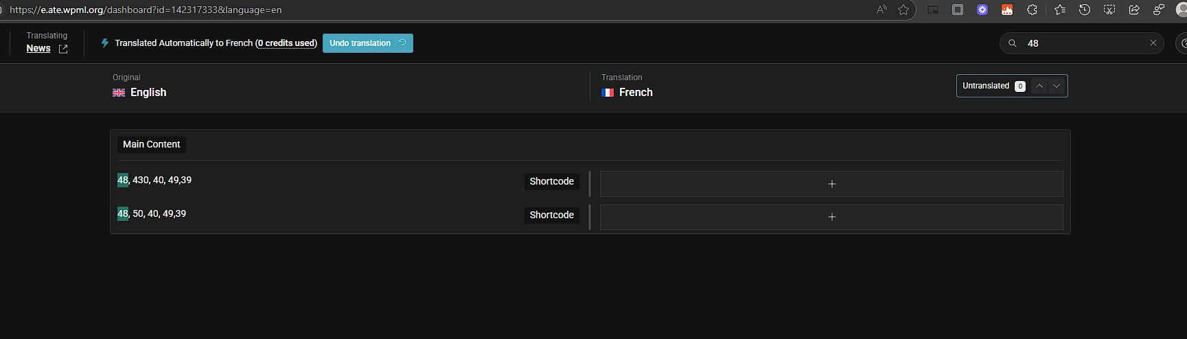

May 13, 2025 at 1:02 pm #17027771
The config and code snippet appear to work.
On your website, the shortcode for the Blog Filter includes the categories with the following IDs:
"48, 430, 40, 49,39"
You need to search for the IDs and translate them with the IDs of the translated categories.
