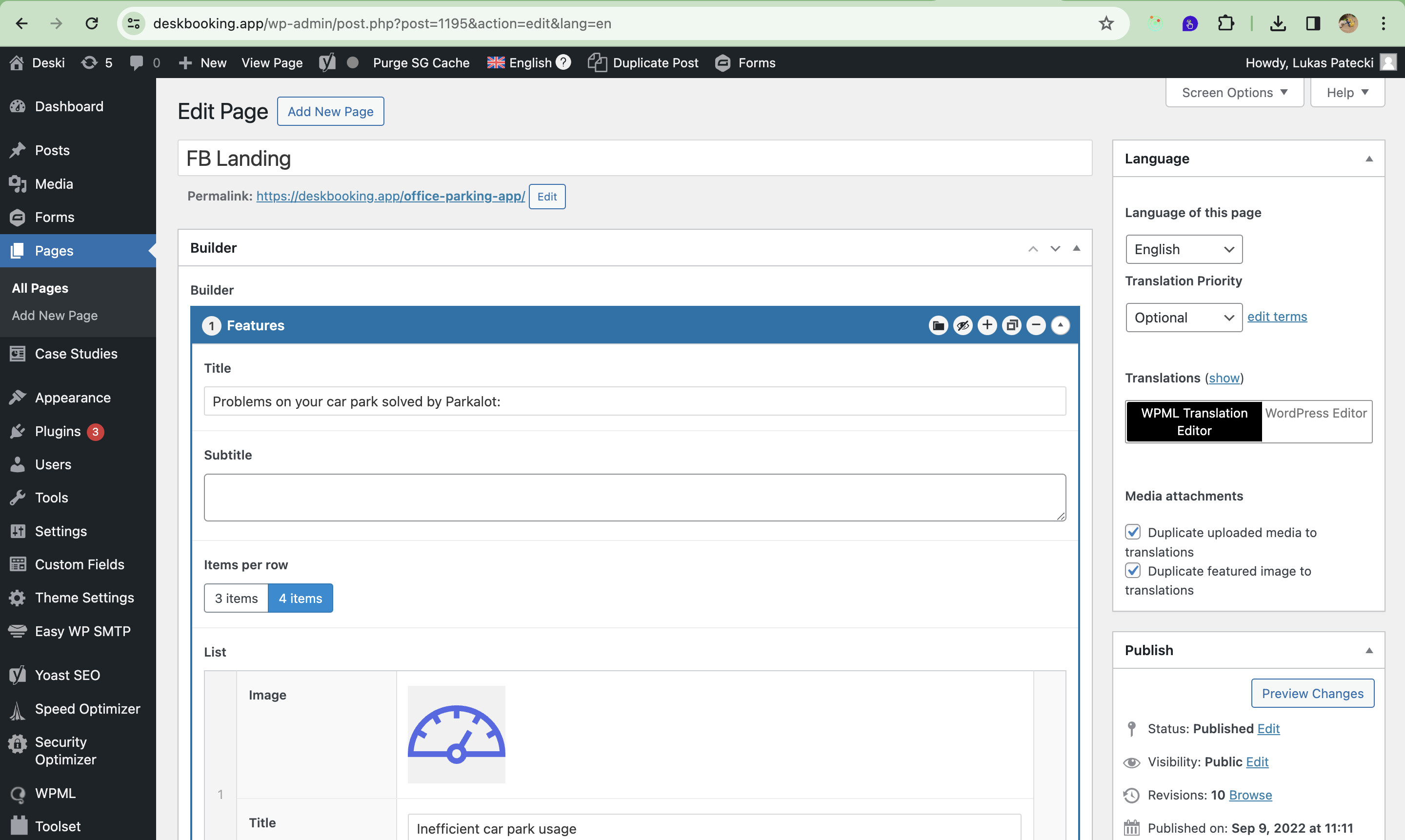

I have a site that is created using a "builder" of some kind. Everything I can currently translate using WPML is the page title.
How should I proceed to translate/ create a copy of the content?

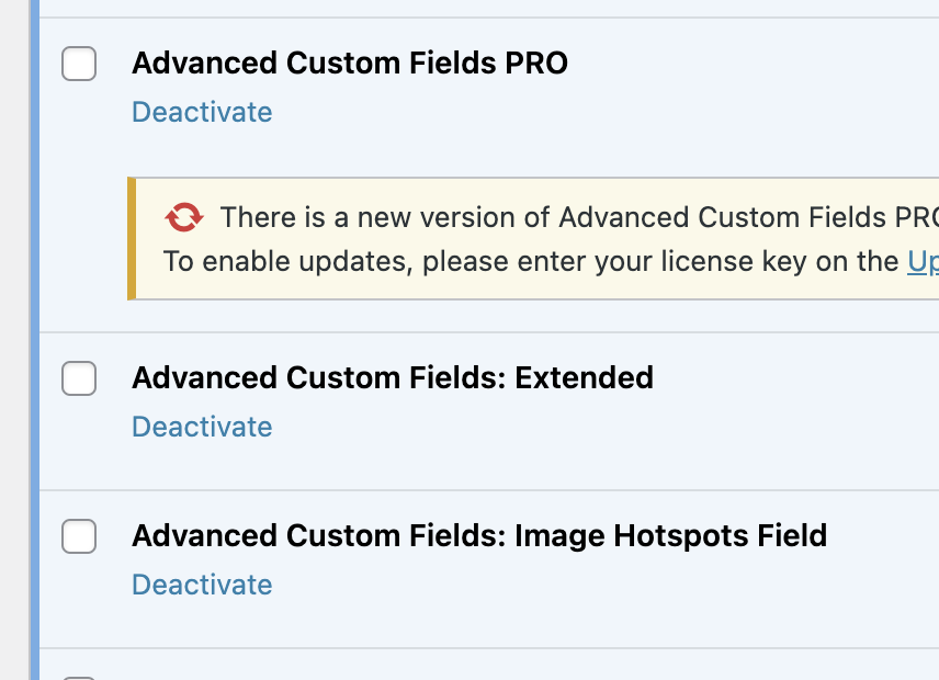

What I found out is that it's probably built on top of Advanced Custom Fields. I see a lot of plugins that seem related:
- Advanced Custom Fields PRO
- Advanced Custom Fields: Extended
- Advanced Custom Fields: Image Hotspots Field
I belive the only was to manage the translations is to copy the content - and I'm ok with that. It's sufficient for me if WPML handles urls, menus and redirects

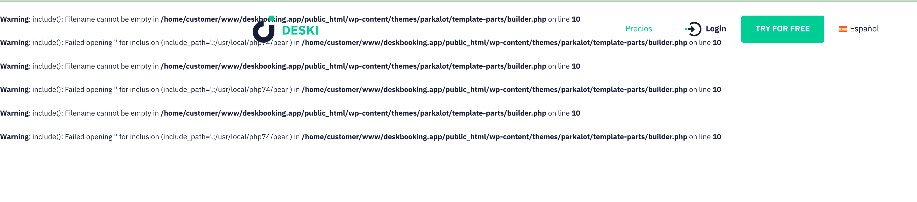

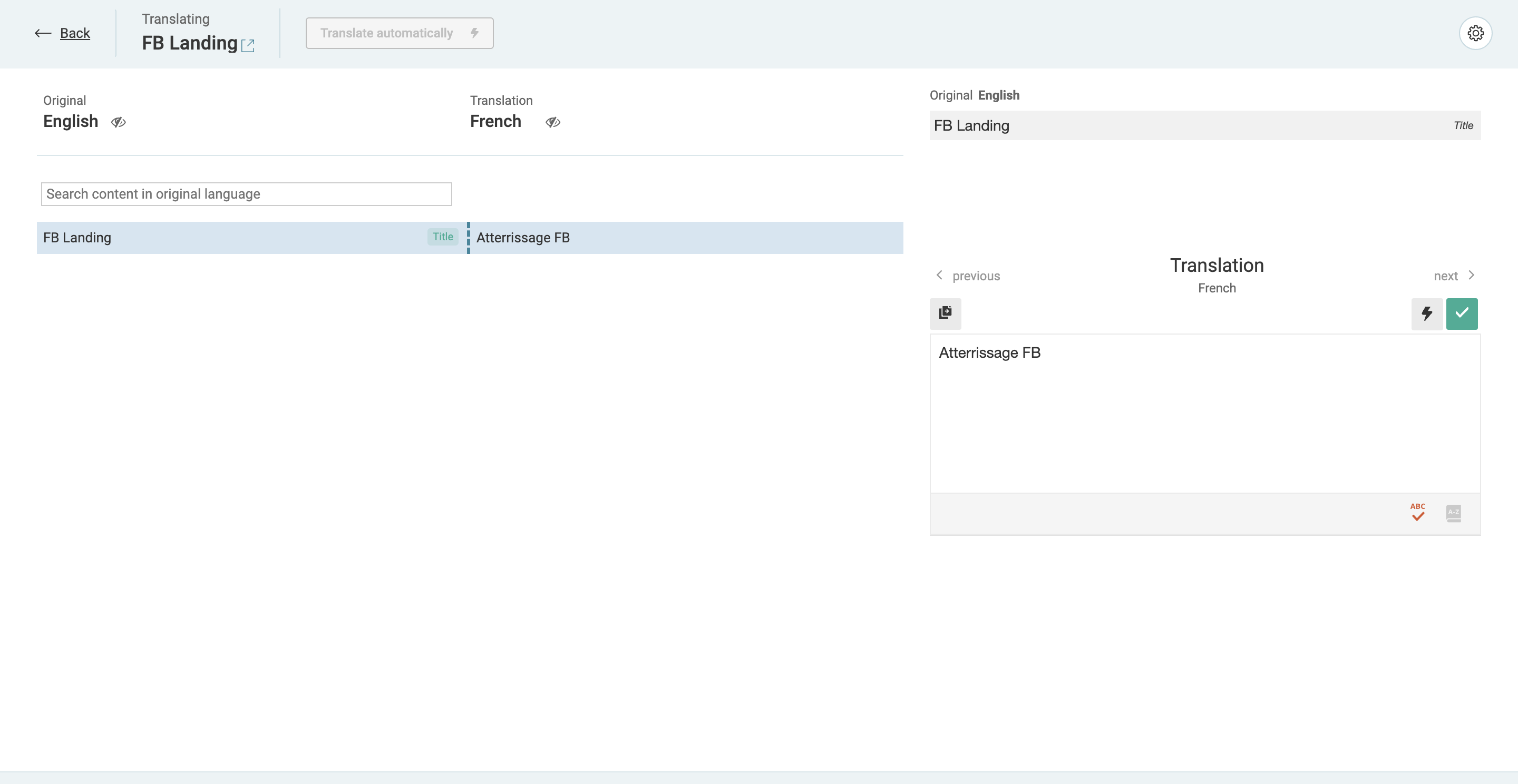

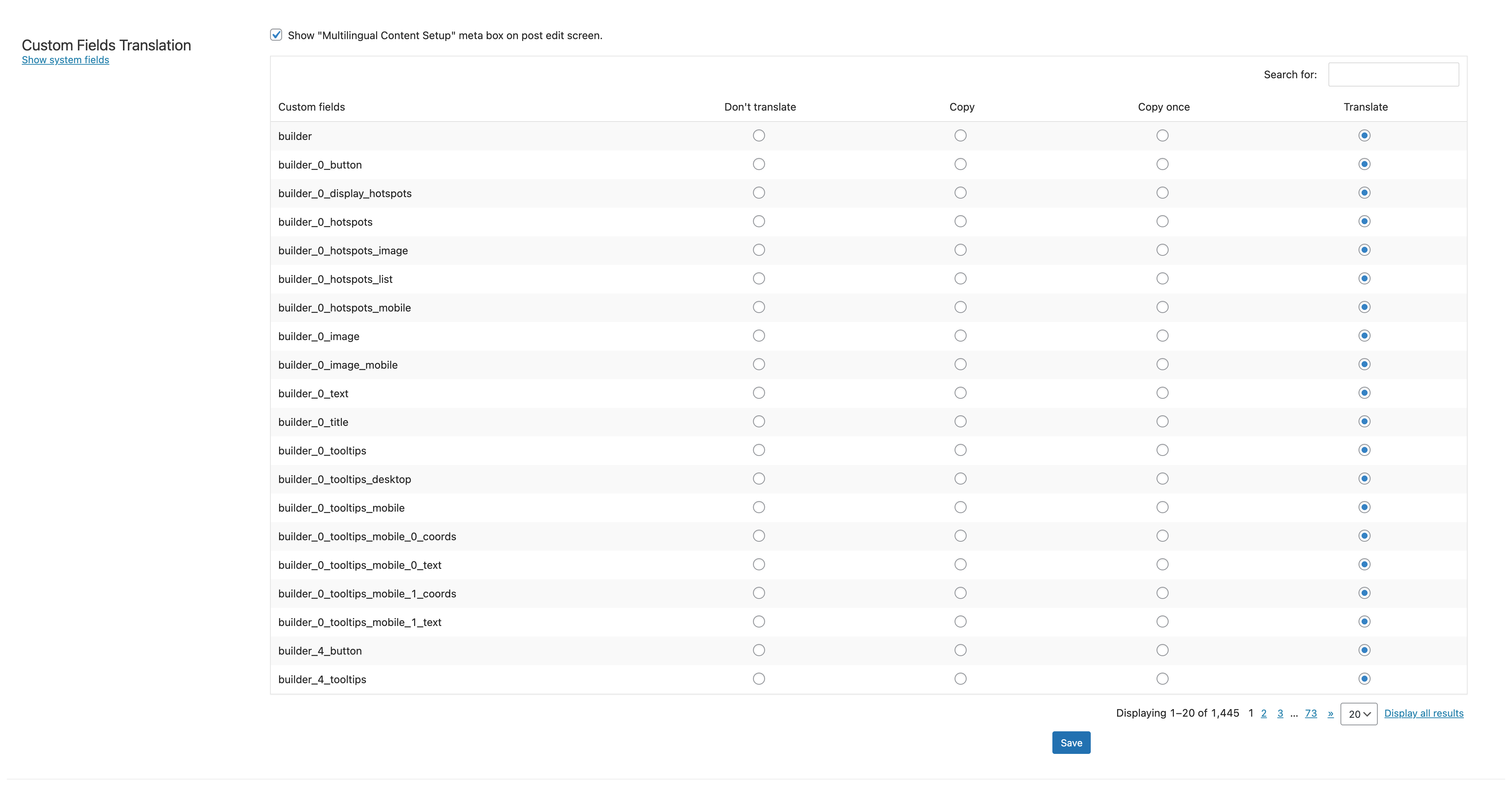

There is a list of over 1400 custom field. I added all that start with builder to "translate". I'm now able to create a copy of the content somehow via WPML. I'm even able to translate it manually, by editing the page. However if i even accidentally >>open<< it in Translation Editor the page breaks.

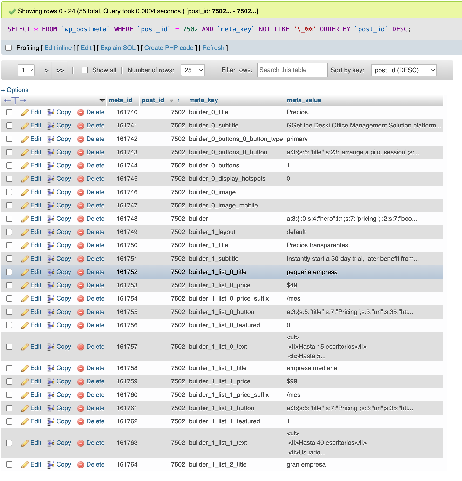

In the screenshots I attached a screenshot for the database of custom fields that refer to a single page.
Maybe the solution is to allow editing of fields that follow the pattern below in the editor:
SELECT *
FROM `wp_postmeta`
WHERE `post_id` = 7502
AND `meta_key` NOT LIKE '\_%%'
AND `meta_key` REGEXP '_title$|_subtitle$|_suffix$|_price$|_text$'
ORDER BY `post_id` DESC;
Edit valus of meta_key that end with "_title", "_subtitle", "_suffix", "_prices", "_text" and don't start with "_".

If the content of the pages you're working on was built with Advanced Custom Fields, you need to use the following guide (and sub-guides if necessary) to make proper settings for future translations: https://wpml.org/documentation/related-projects/translate-sites-built-with-acf/.
Editing something directly in the database is not recommended, as I cannot guarantee that it will work at all. I encourage you to read articles carefully, make the correct settings to custom fields, in order to add necessary fields to the translation and other custom fields to be copied, and afterward make sure translations are 100% complete.
