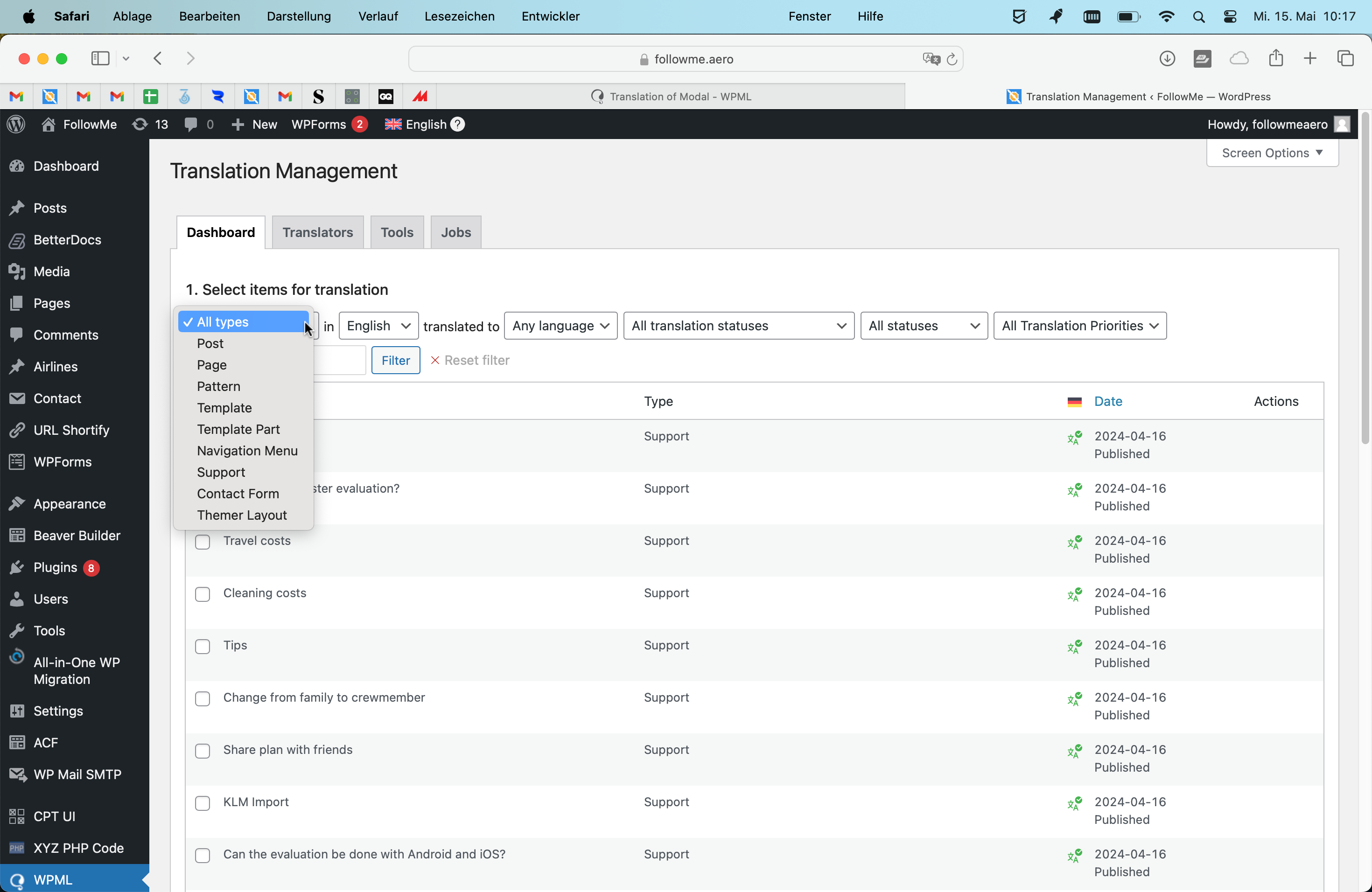

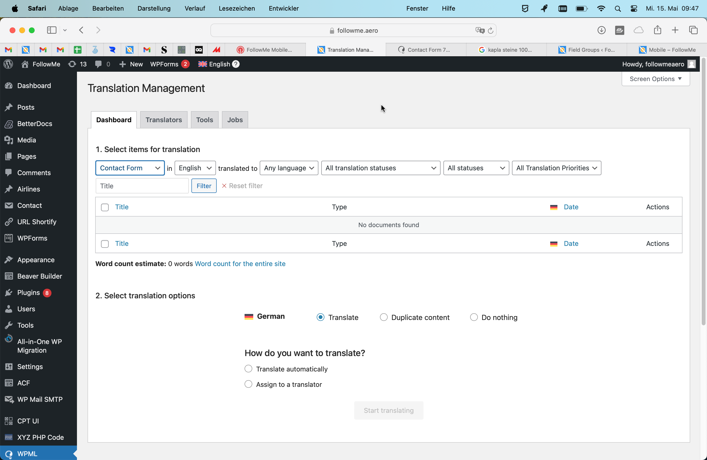

May 15, 2024 at 7:48 am #15628078
andreasN-23
I installed the contact form 7 wpml but there is nothing to translate...
May 15, 2024 at 7:55 am #15628104
Marcel
the source code says "Contact Form 7", and the top bar of your screenshot is "WP Forms". Do you have 2 form plugins installed? Please check if you can find another "Contact Form" entry in the dropdown. If you have 2x plugins installed, you might not see the data from Contact Form 7.
Best Regards
Marcel
May 15, 2024 at 8:19 am #15628211
andreasN-23
no, actually I don't see any. But strangely, when opening contact froms, there is none there. I wonder if the installation of contact form multilingual after all screwed up the old forms?
the forms still work in the front end but in the backend, they are not visible anymore. That might be also the reason I don't see anything to translate?

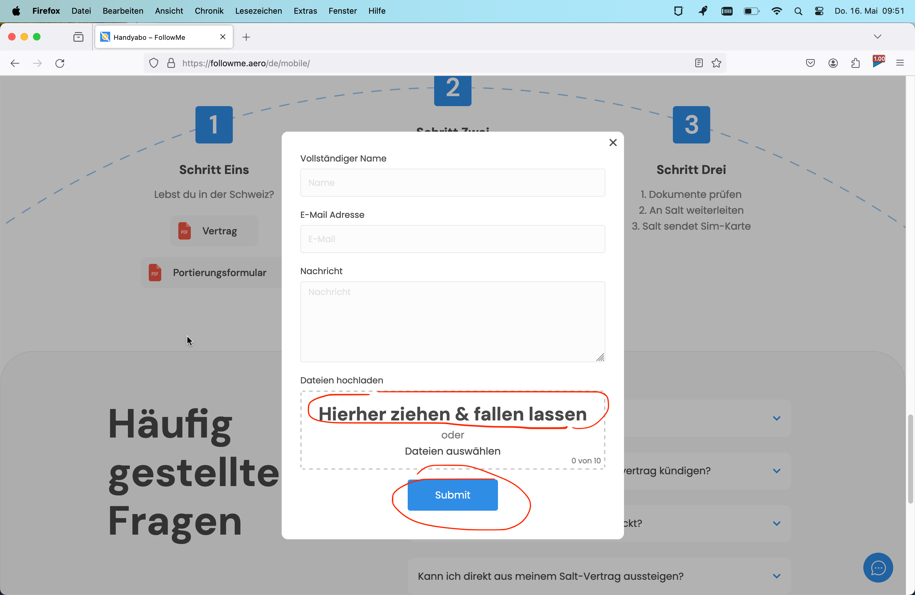

May 16, 2024 at 7:53 am #15633329
andreasN-23
Hi Marcel, thanks for the help. I did translate it, but I struggle to find where I can change the circled text in the screenshot attached.
May 16, 2024 at 10:29 am #15634416
Marcel
that content is handle via a plugin called "drag-and-drop-multiple-file-upload-contact-form-7, which seems to be not fully supporting multilingual use.
The text you mentioned is part of the included translation file of that plugin, but there is no translation for the button included.
I just tested and replacing the strings worked, it will output a "DE" before the string. You can change the string here: hidden link.
Other strings are coming from here: hidden link, you can also change them here.
But the Translation button itself seems to be not translatable right now. It needs to follow i18n developer standards to be translatable for a translation plugin. I recommend you contacting the authors about that.
Best Regards
Marcel

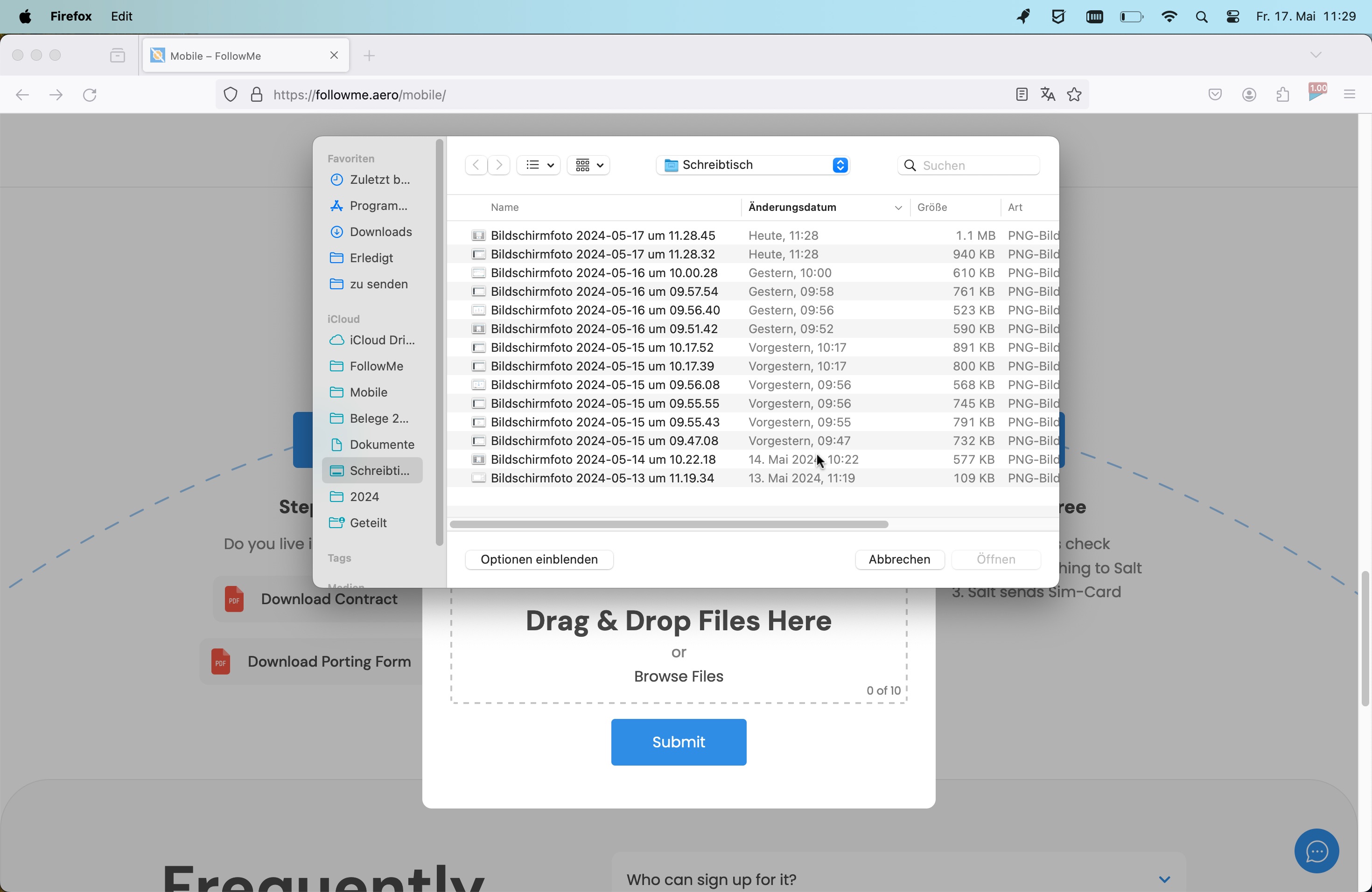

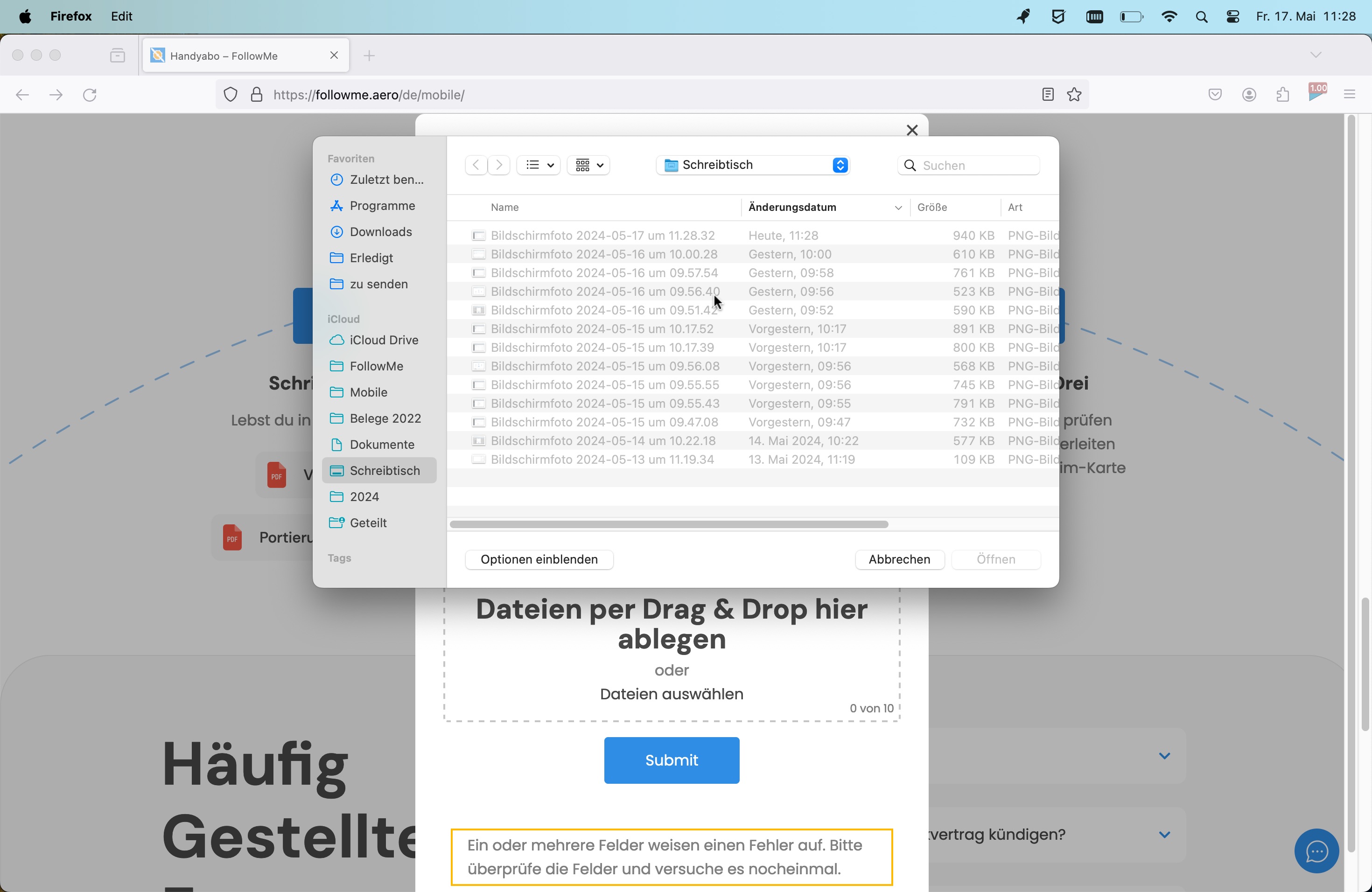

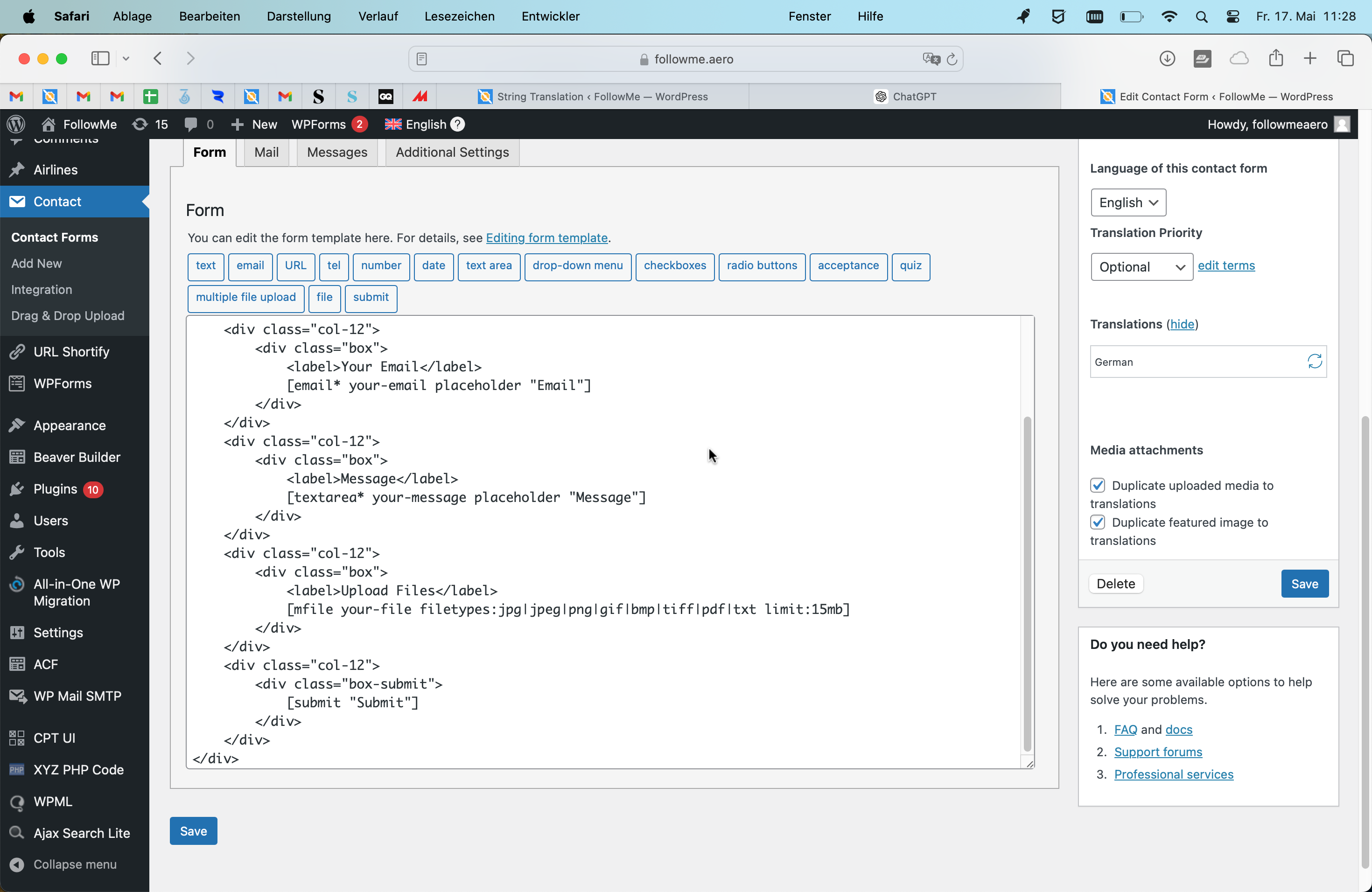

May 17, 2024 at 9:32 am #15638510
andreasN-23
Okay, thanks Marcel, I am going to contact the developers about the button.
But I struggle still with the contact form in Firefox. While I can upload files without a problem in the english original version of the page, I cannot do so in the german version.
Check out screenshot. Does this
[mfile your-file filetypes:jpg|jpeg|png|gif|bmp|tiff|pdf|txt limit:15mb]
need to be translated also somewhere? I believe the upload in the german version doesn't work because this is missing.
Andreas
May 17, 2024 at 3:34 pm #15640339
Marcel
Yes, I checked the embedded form, and this shortcode was not included. I searched for "filetype" on the search box and finished the translation with 100%: hidden link.
It's now active on hidden link (see English as a reference here: hidden link.
Does it work for you? If not, you can also copy the same code to German to the form on the link above as a fast workaround.
