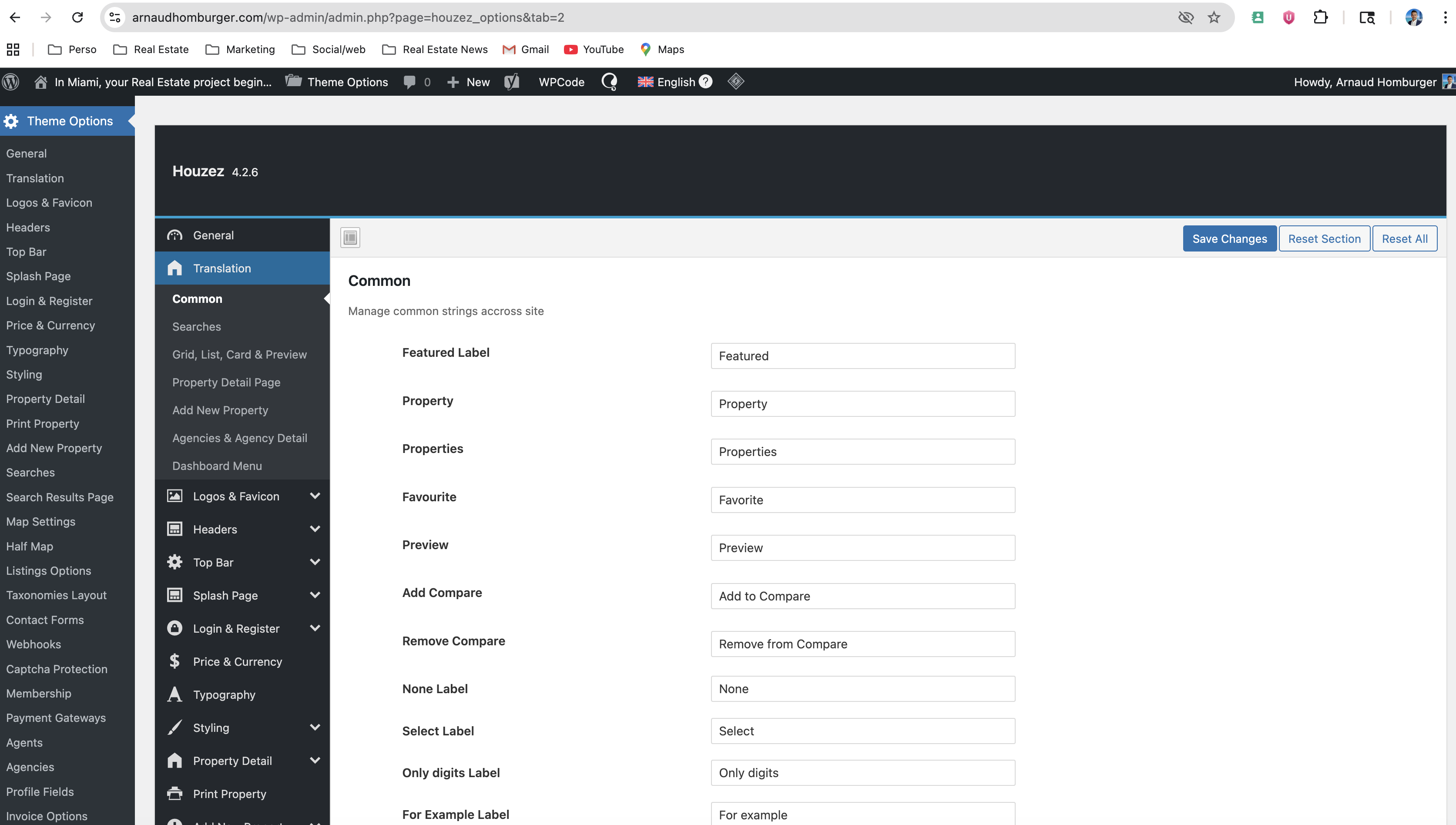

Since I promote properties on a daily basis, I cannot allow my website to look unprofessional with mixed languages for too long. So, I went ahead and fixed the translations myself.
Please see the attached screenshots showing where I updated the translations. As we have discussed several times, the Houzez theme has its own translation tools under Theme Options. My understanding is that because I am using the WPML plugin to translate the Houzez website, the Houzez theme translations should not be touched. However, for some reason, many terms in that section were translated from English to French again (Not my action).
As I have already done at least 10 times since purchasing WPML about a year ago, I had to undo all translations in that section so that my English properties display only in English. This process took me about 40 minutes this time, which means roughly 400 minutes, or more than 6 hours, spent retranslating the same section over time.
At this point, I would really like to fix this issue once and for all. I am sure you can understand my frustration. It is simply not sustainable to keep correcting the same problem repeatedly.

In here : hidden link
This built-in translation tab is meant for users who use languages other than English as the default language, so it should not be used in your case nor these fields should be translated from there as you were already aware.
Then all these fields are translatable from String Translation to french here : hidden link
I'm not entirely sure how they were translated from Houzez translation tab but if I recall correctly, initially, these were translated by mistake when you first reported this issue.
In this case, either some of the fields were not corrected back to english (likely I missed them the first time) or some of the fields are getting translated to french by themselves (very unlikely and I cannot replicate so far)
I see no trace of any other french fields in houzez backend and from my experience with this, I doubt it to be a persistant issue, just a field we missed from back then. But I will keep an eye and test with different houzez versions trying to trigger such behavior.

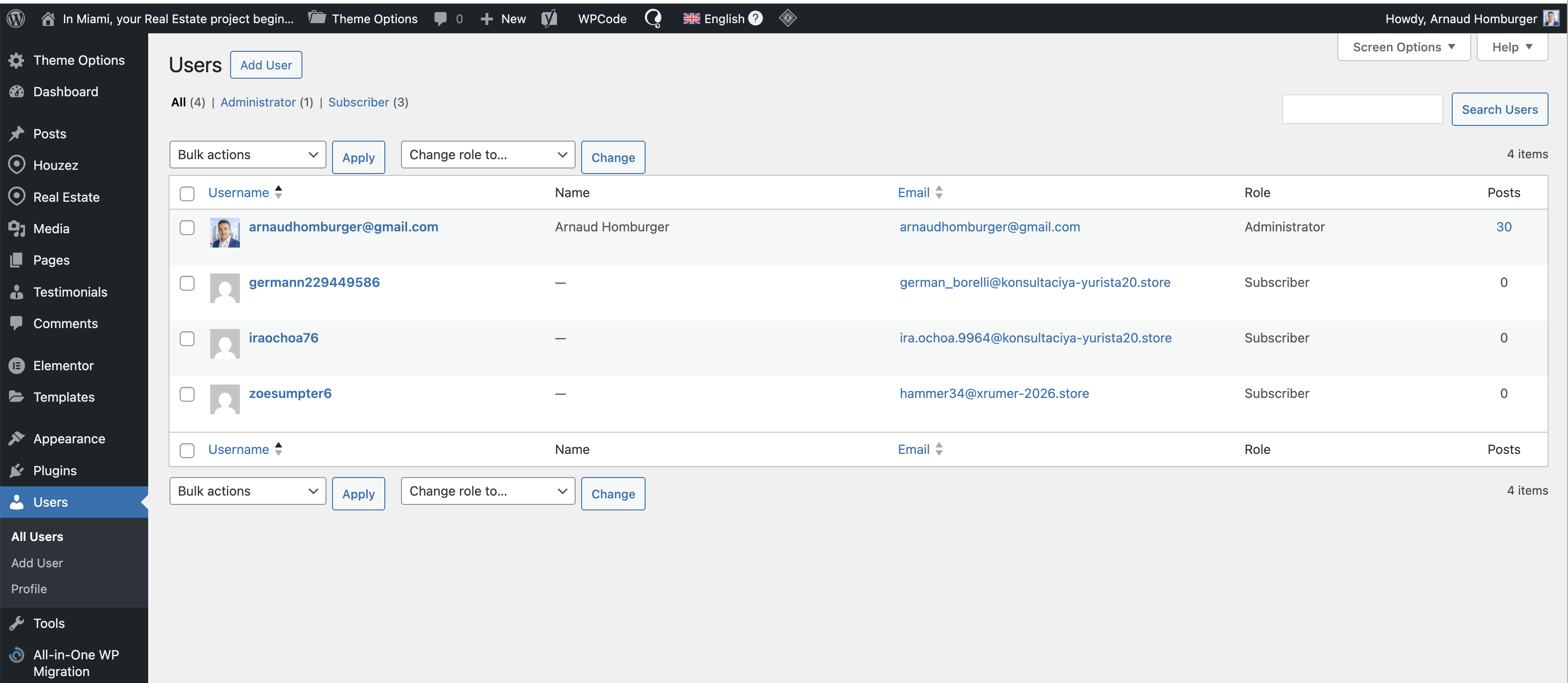

Also, I am getting fake users all day long creating accounts into my site (see screenshot attached). I have to delete them everyday. What do you recommend for that?
Thank you for your assistance!
