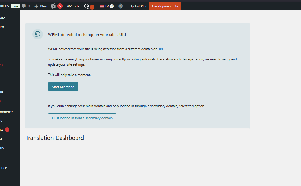

LABIETIS.LV now is pointing to the dev site [staging2.sektahouse], which did not have any issues [so far].
Since the real cause for issues on the 10web hosted site is still unknown, we're going to save the effort. If you guys still want to experiment with erroneous 10web site with huge database, I can give you my credentials for a while - just so you can investigate.
With the change, we need to sort out the domain thing - it kinda stays the same - labietis.lv, but WPML, obviously, screams at me, that something has changed. What do I do? Those wasted translation points on old 10web site can go fuck themselves - I'll swallow it as a production cost. Question is, what do I click? I am just afraid that it does not sync unwanted stuff - just the account, dev/production status and, if possible, payment method and info.

option nr.2, right? it'll switch, right?
March 10, 2026 at 1:11 pm #17885604
Lucas Vidal de Andrade
Hey there,
I think we are losing track here. We need a stable environment to check for errors. Please do not make any large changes on hidden link for the moment. I'll forward the information that we have right now to the devs and let you know.
As for the other website, you can click to Start Migration, say No to sharing credits, and create a new key for the website. In the end, the safest way is always to create a new key for websites.
