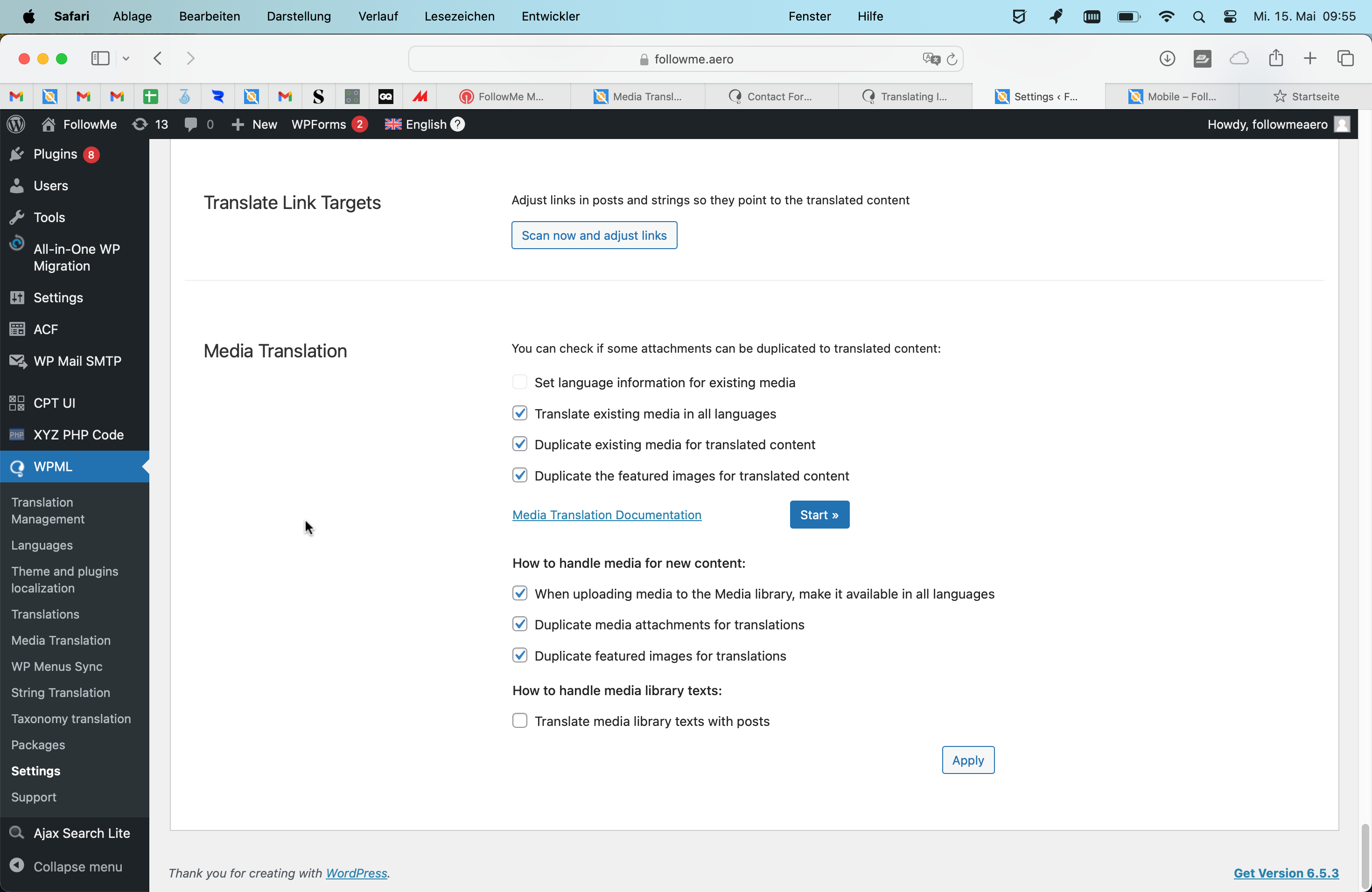

thanks for the info. Did you also try with WPML Media Translation? So long the MIME-type is activated in WP, you can also try to replace it using our Add-On: https://wpml.org/documentation/getting-started-guide/media-translation/#activating-wpml-media-translation
Best Regards
Marcel

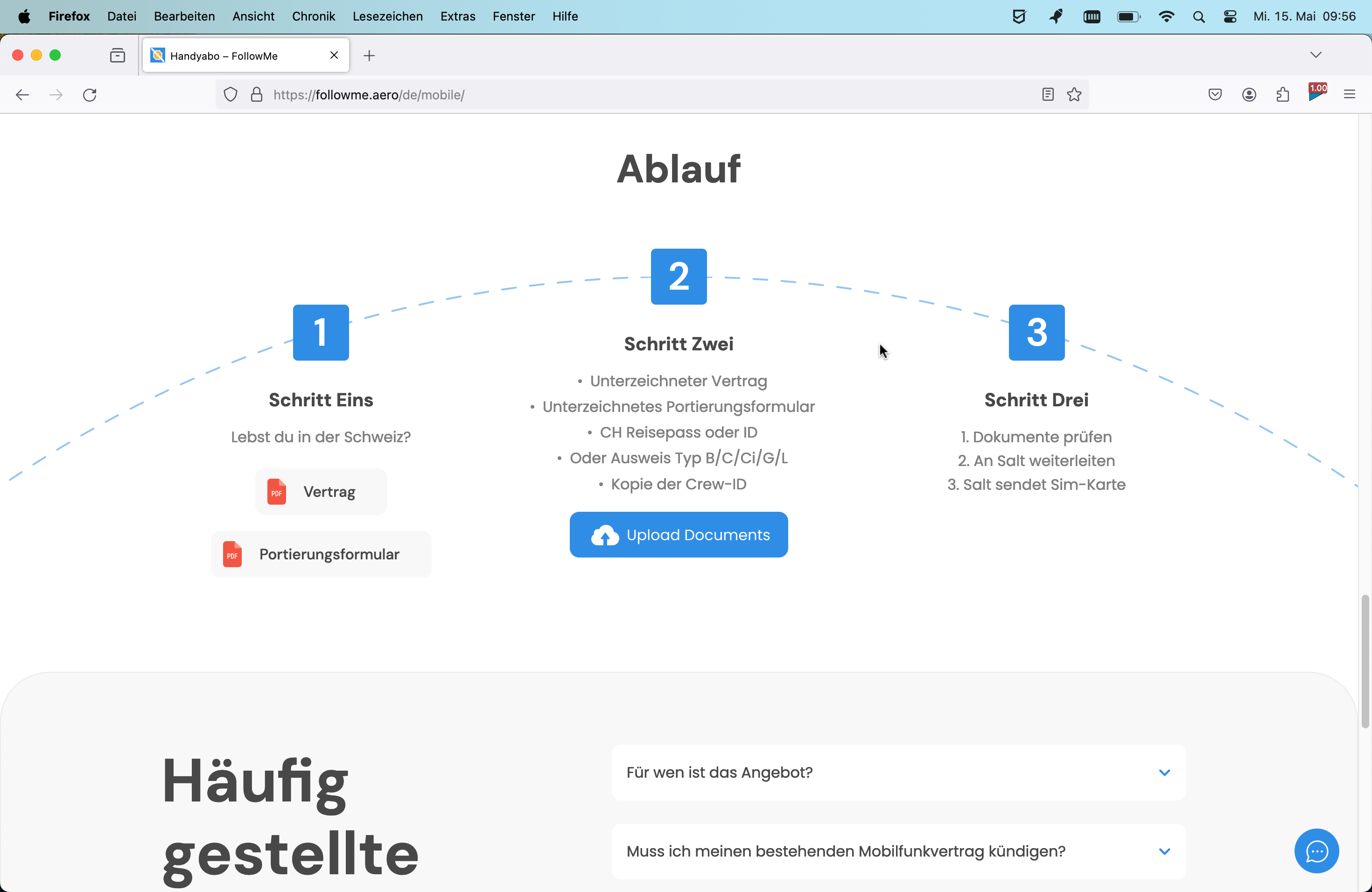

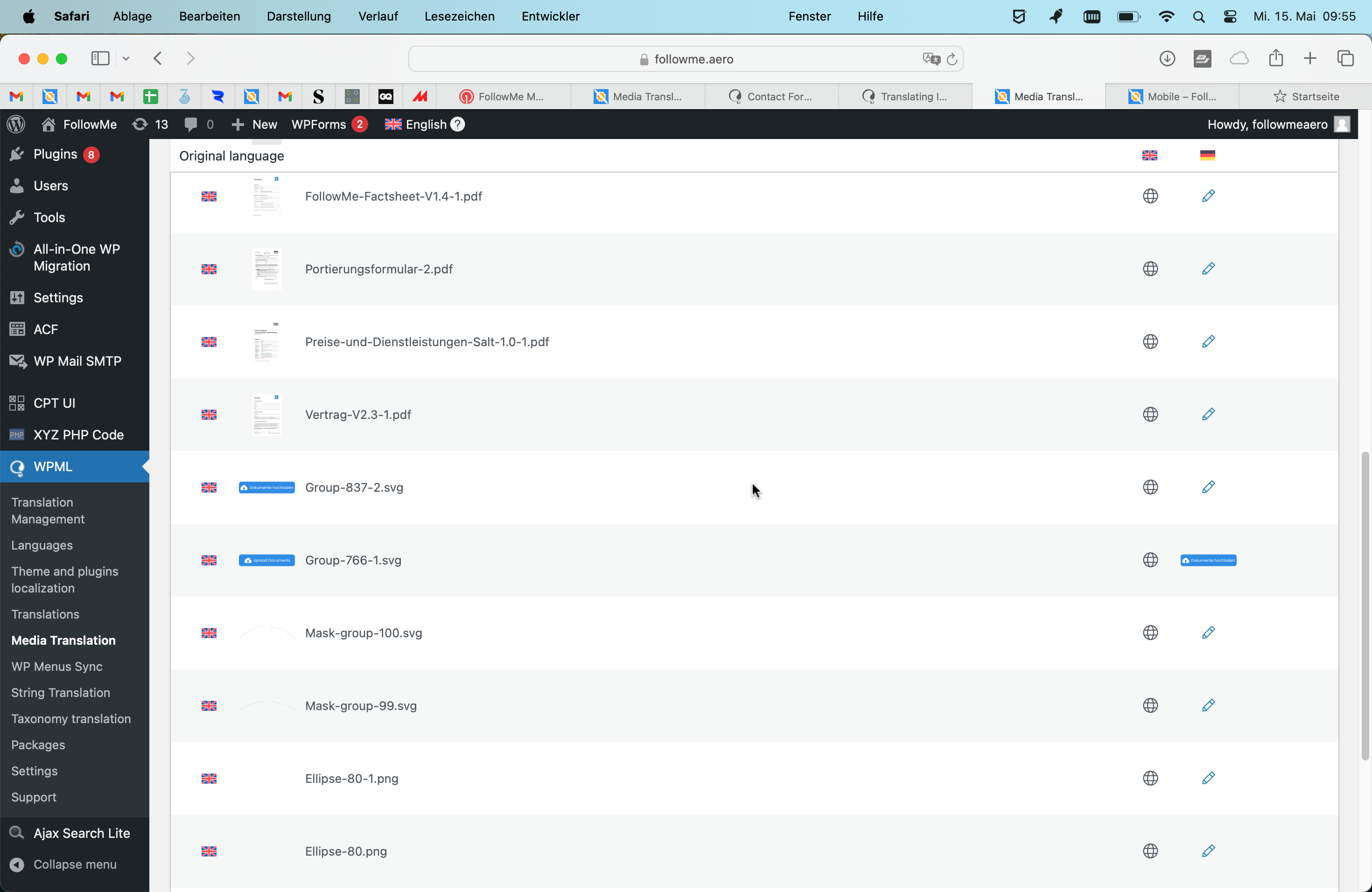

May 15, 2024 at 7:58 am #15628111
andreasN-23
so I activated media translation, translated the media but still it is shown in english on the german site.

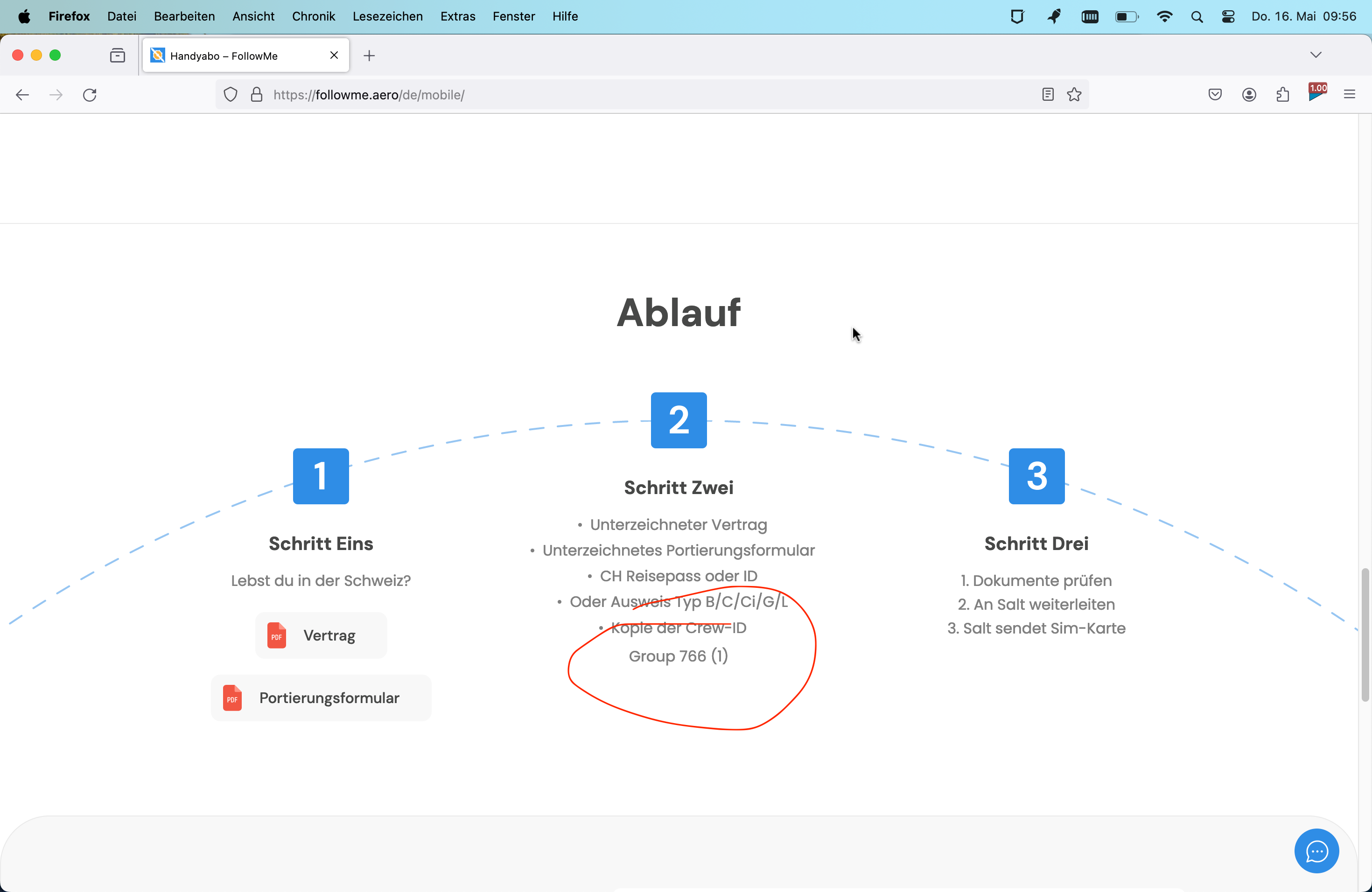

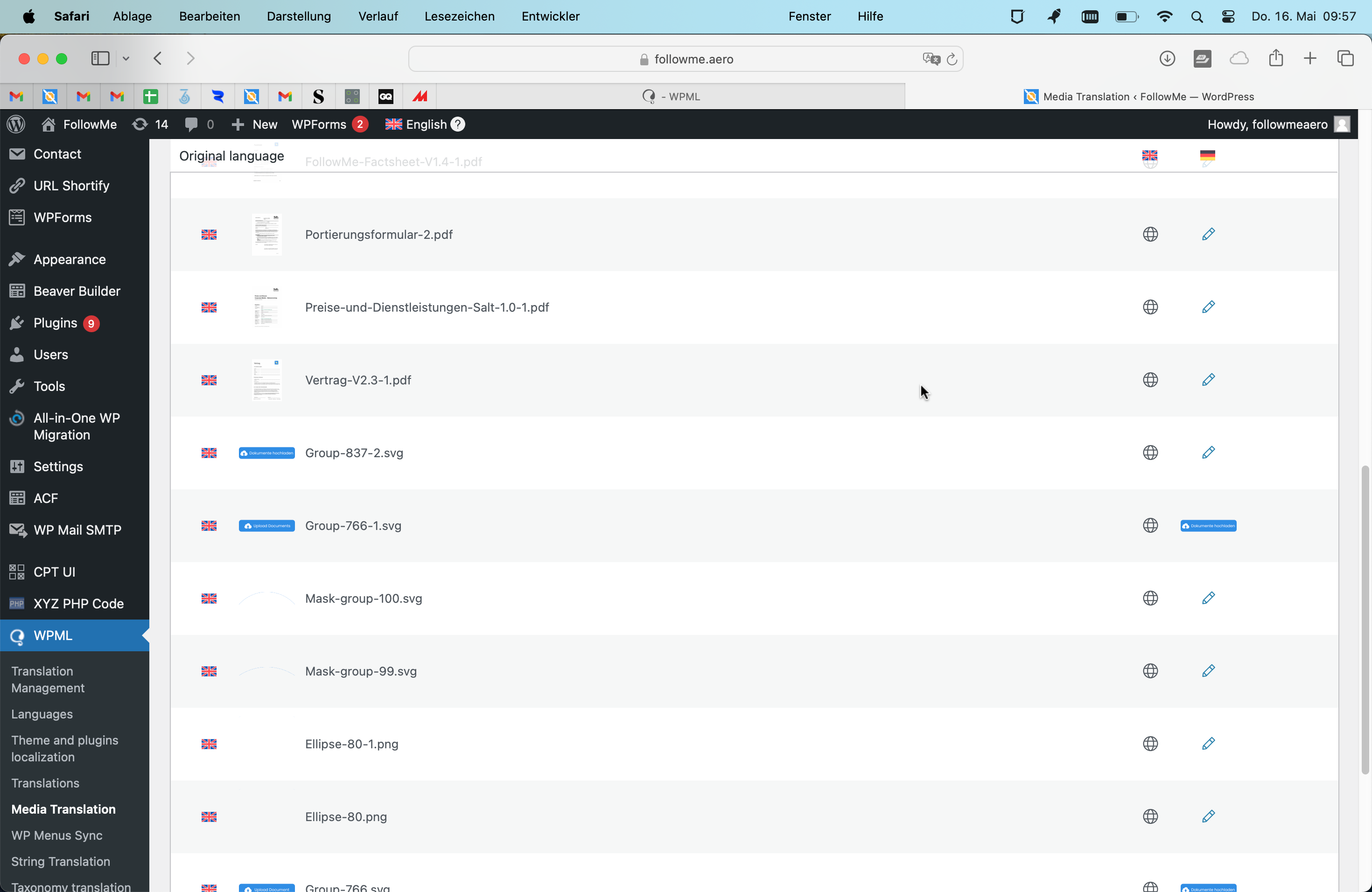

May 16, 2024 at 7:55 am #15633347
andreasN-23
Hi Marcel
The page was purchased, I have no expertise at all in this. The problem now is that the button is not shown at all and that is a problem. Better to have the button in English than not at all. Btw you would still have access.

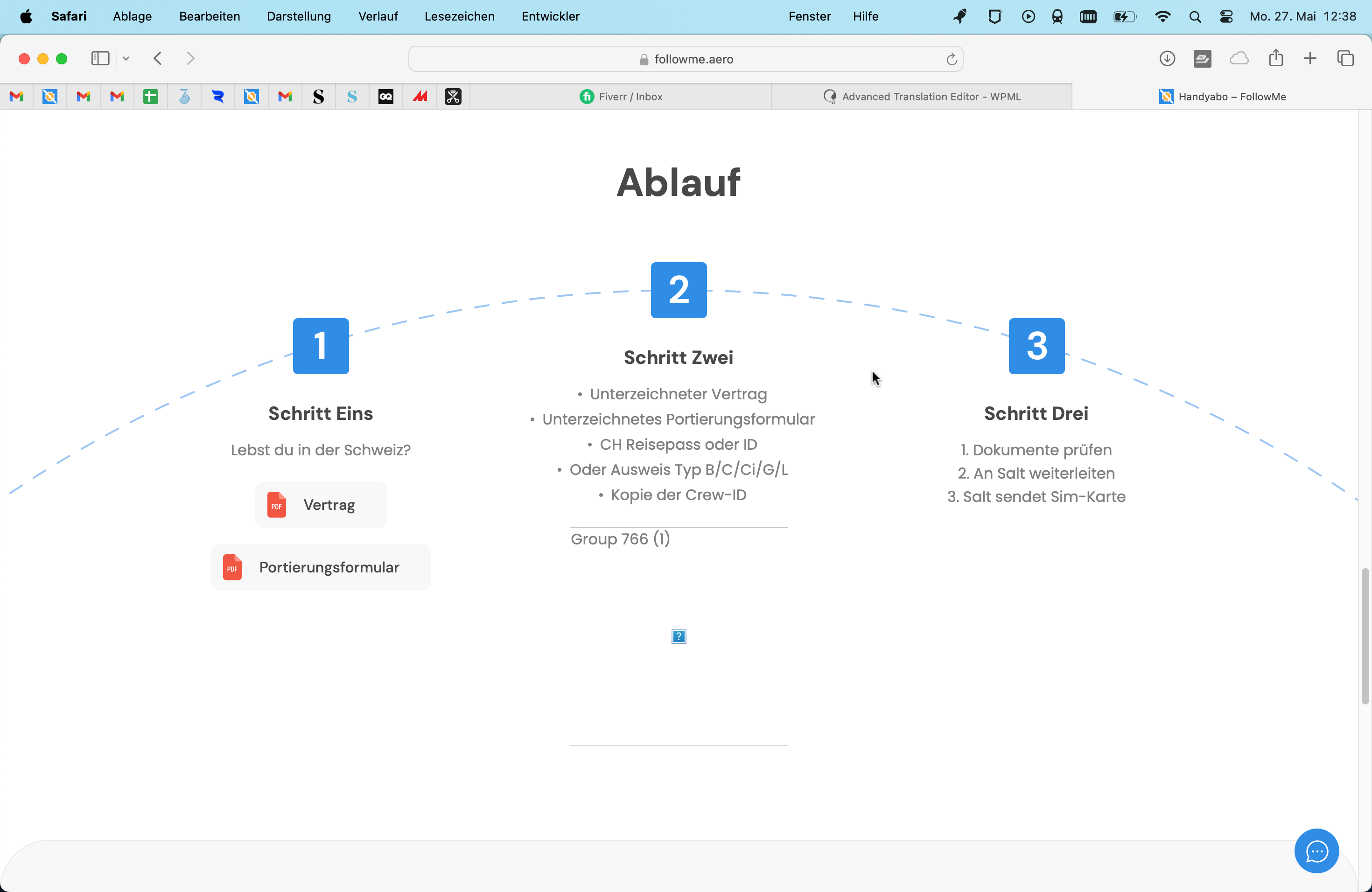

May 27, 2024 at 2:56 pm #15674893
andreasN-23
Hi there, so they are not willing to share the beaver builder.zip and changed that photo element to a button. But the problem is still persisting.
the credentials for our site would be still the same

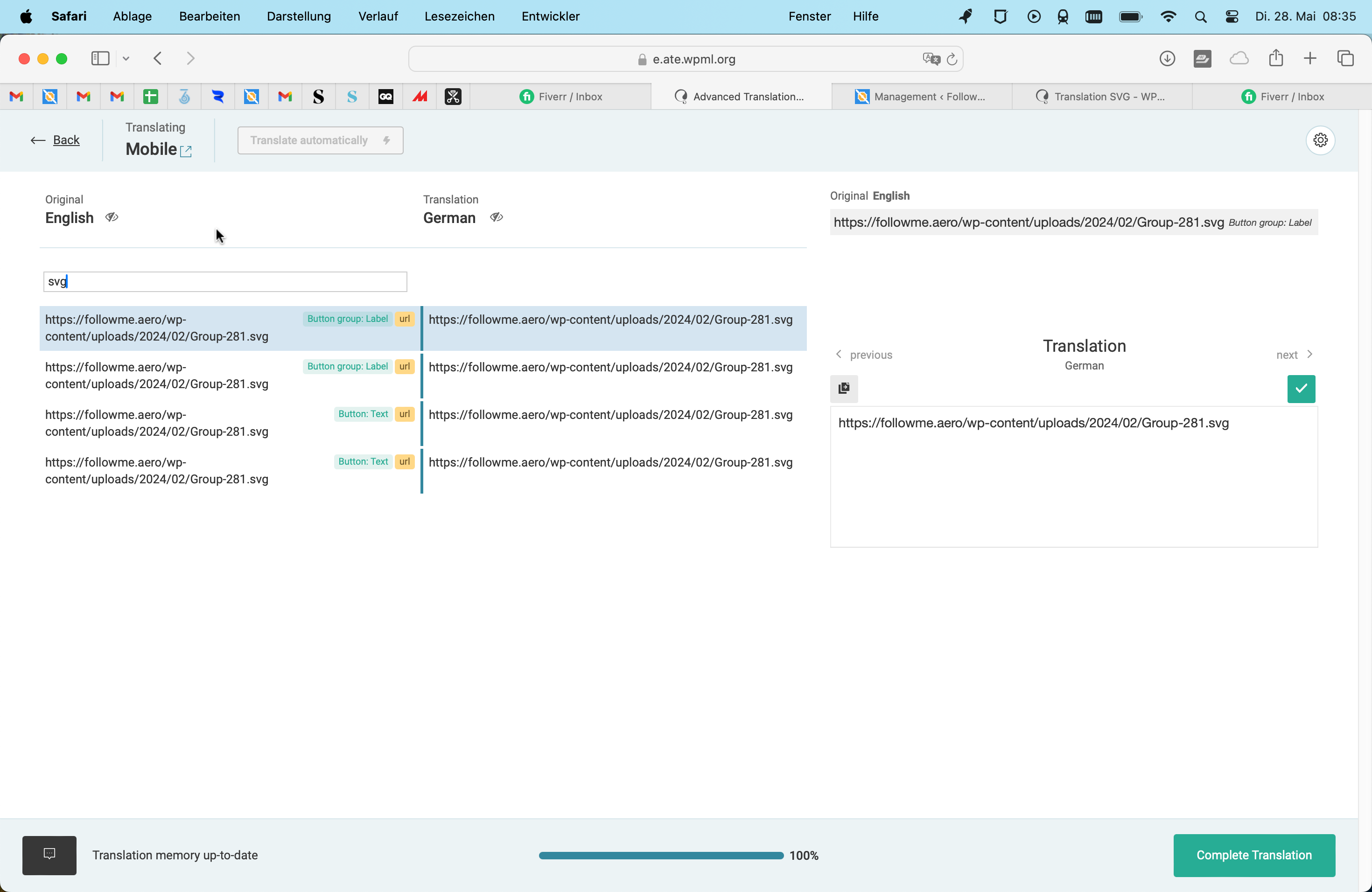

May 28, 2024 at 6:37 am #15676308
andreasN-23
so the developers used indeed now a button element of the beaver builder which should be wpml supported and currently it is shown correctly on the page. But I believe as soon as wpml auto translates the site, it will disappear again and look as on the screenshot above.
I believe so because I cannot find the svg in the advanced translator still
