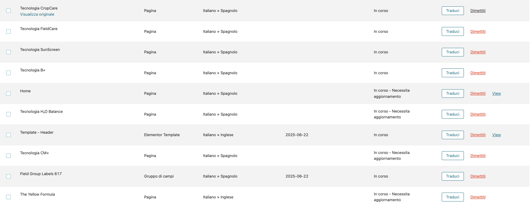

I am trying to save my translations, but they get stuck in the "In progress" (In corso)status, even after they are 100% finished and saved. The page I linked is translated in all languages, but the translations don't save, so they don't show on the website. Link to a page where the issue can be seen: hidden link
Translations are stuck in the 'In progress' status and do not appear on the website, even after being marked as 100% finished and saved.
Why are my translations stuck in the 'In progress' status?
How can I resolve the issue of translations not saving and showing on the website?

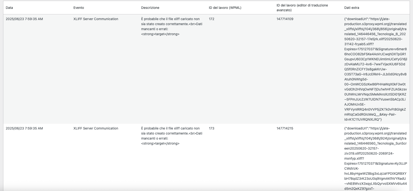

This does happen to all pages. Here's the error log.

This is most likely happening due to a site migration.
As I can see you are working on a staging domain, did you recently migrate from the live domain?
In this case review the documentation here, please:
https://wpml.org/documentation/translating-your-contents/advanced-translation-editor/using-advanced-translation-editor-when-you-move-or-use-a-copy-of-your-site/
The error you are receiving indicates that the data the system is attempting to pull do not match your environment ID.
What is the original Domain URL?

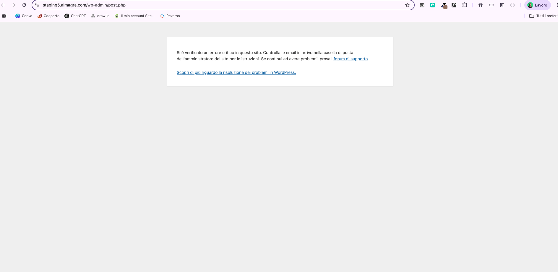

However, the problem persists with our products. When attempting to save any product, we encounter a critical error on the site (see the immage attached). We have enabled debug mode, and the debug.log file has captured the following fatal error:
"PHP Fatal error: Uncaught TypeError: Illegal offset type in isset or empty in /home/customer/www/staging5.almagra.com/public_html/wp-content/plugins/sitepress-multilingual-cms/classes/core-abstract-classes/class-wpml-element-translation.php:282
Stack trace:
#0 /home/customer/www/staging5.almagra.com/public_html/wp-content/plugins/sitepress-multilingual-cms/classes/core-abstract-classes/class-wpml-element-translation.php(113): WPML_Element_Translation->maybe_populate_cache(Object(WP_Post))
#1 /home/customer/www/staging5.almagra.com/public_html/wp-content/plugins/woocommerce-multilingual/classes/Synchronization/Manager.php(54): WPML_Element_Translation->get_element_lang_code(Object(WP_Post))
#2 /home/customer/www/staging5.almagra.com/public_html/wp-content/plugins/woocommerce-multilingual/classes/Synchronization/Hooks.php(184): WCML\Synchronization\Manager->getElementLanguage(Object(WP_Post))
#3 /home/customer/www/staging5.almagra.com/public_html/wp-content/plugins/woocommerce-multilingual/classes/Synchronization/Hooks.php(142): WCML\Synchronization\Hooks->synchronizeProductTranslationsOnSaveInNativeEditor(8184, Object(WP_Post))
#4 /home/customer/www/staging5.almagra.com/public_html/wp-includes/class-wp-hook.php(326): WP_Hook->apply_filters(NULL, Array)
#5 /home/customer/www/staging5.almagra.com/public_html/wp-includes/class-wp-hook.php(348): WP_Hook->do_action(Array)
#6 /home/customer/www/staging5.almagra.com/public_html/wp-includes/plugin.php(517): WP_Hook->do_action(Array)
#7 /home/customer/www/staging5.almagra.com/public_html/wp-includes/post.php(5110): do_action('save_post', 8184, Object(WP_Post), true)
#8 /home/customer/www/staging5.almagra.com/public_html/wp-includes/post.php(5212): wp_insert_post(Array, false, true)
#9 /home/customer/www/staging5.almagra.com/public_html/wp-admin/includes/post.php(453): wp_update_post(Array)
#10 /home/customer/www/staging5.almagra.com/public_html/wp-admin/post.php(227): edit_post()
#11 {main}
thrown in /home/customer/www/staging5.almagra.com/public_html/wp-content/plugins/sitepress-multilingual-cms/classes/core-abstract-classes/class-wpml-element-translation.php on line 282"

Thank you — I was able to reproduce the issue.
The translation was never delivered, and it encounters a 500 error.
The specific error I’m seeing, even when attempting to redeliver the file from our side, is:
"It is likely that the XLIFF file you uploaded was not created correctly.
Missing or incorrect data: target" (translated from Italian)
I also tested duplicating the page and re-translating the duplicate, but that did not resolve the issue. In our experience, when this error appears alongside the message above, it typically indicates that a page builder element may be corrupted.
