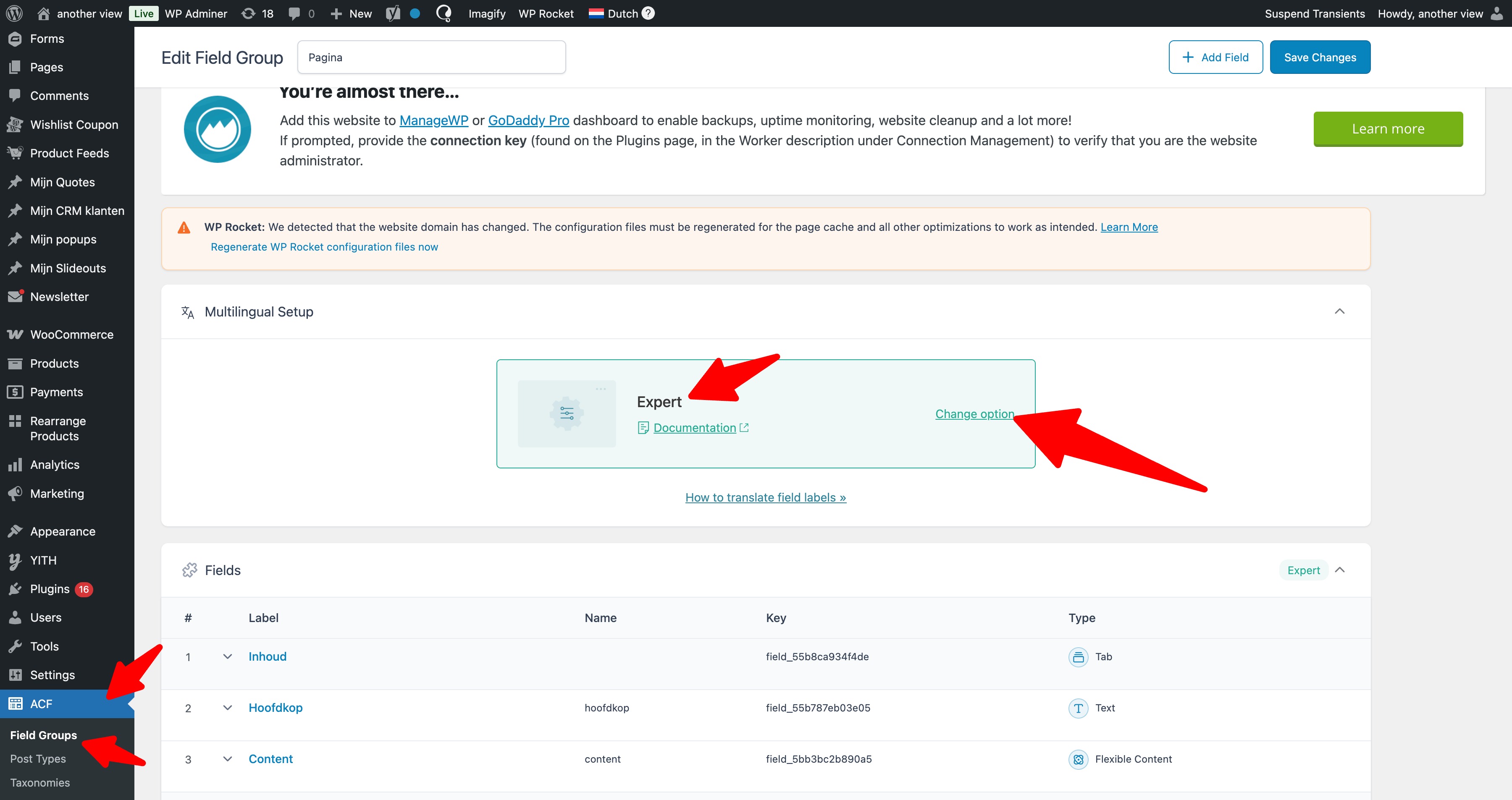

- Go to ACF->Fields Groups
- Change the translations preference to Expert for this field group [Attached screenshot]
https://wpml.org/documentation/related-projects/translate-sites-built-with-acf/
Once this is done, for the flexible field set the translations method to copy.
