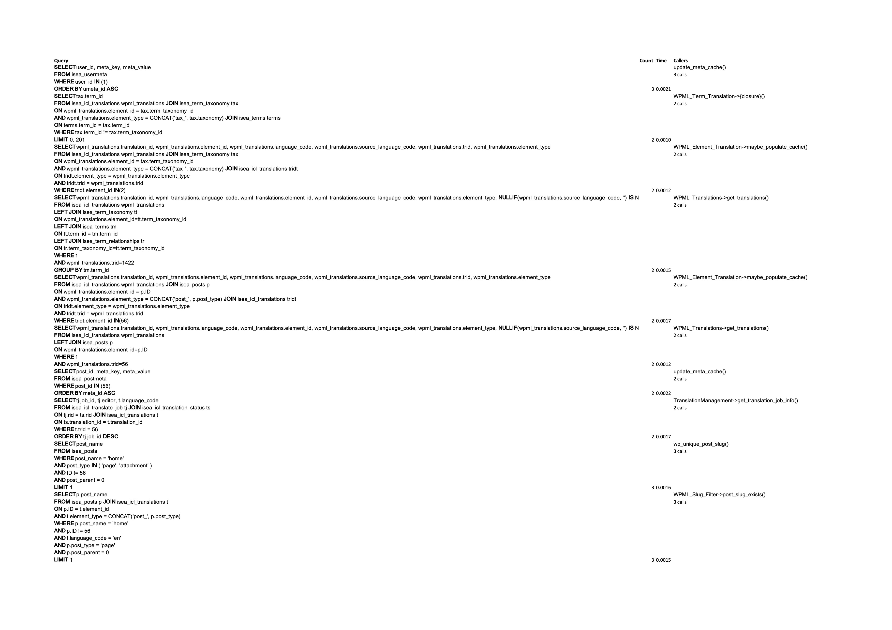

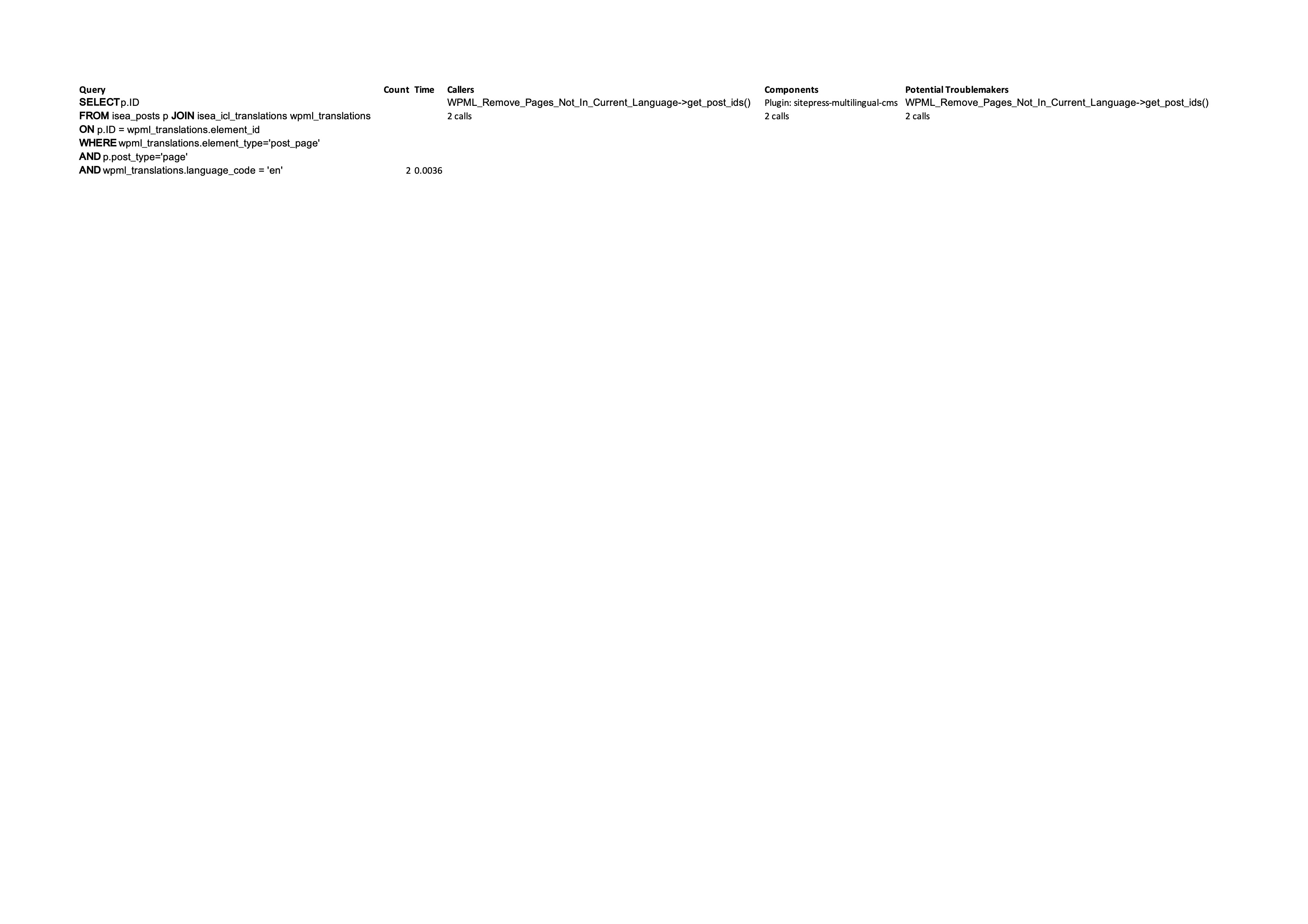

I also added Query Monitor, although I am not sure how to log the queries. Anyway I copied the duplicated queries in an excel (attached). The first image is when I open "Pages" and the second one is when I updated a page translation.

I am not seeing something too out of the ordinary at the moment, but I wIll take a closer look.

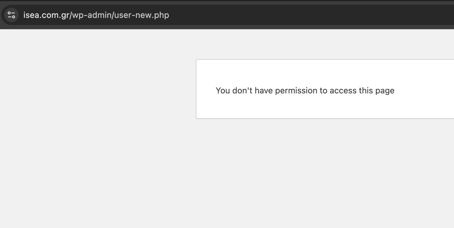

Would it be possible to create a permanent user from Add Users -> New user, you can use my email bobby.k@onthegosystems.com
What we are trying to test is if the 403 error is coming from the temp access plugin, because when we investigate it -- looks like that is the cause of issue here.
