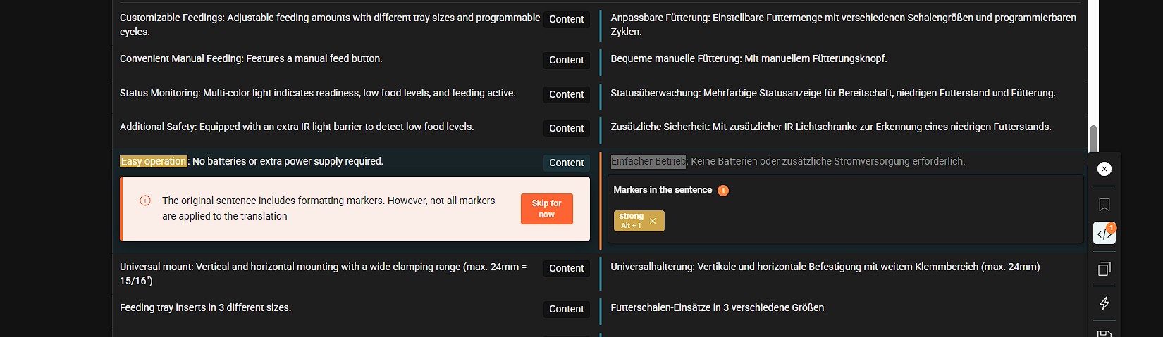

I might have made an observation which can lead to the source of all our problems.
But please still read my previous post above and not only this newest one, because these are additional findings.

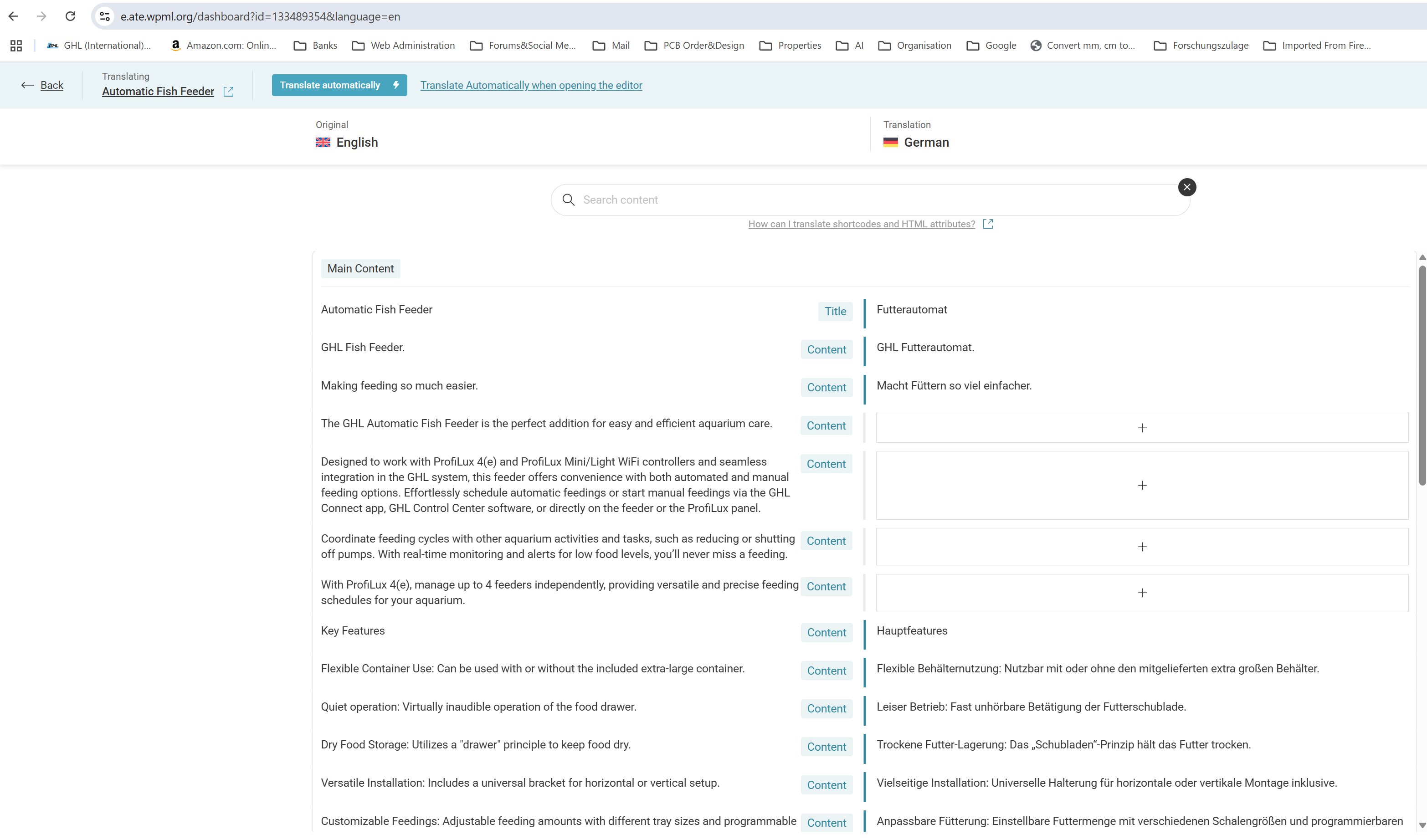

You said "I then did the same on the pages: - Automatic Fish Feeder (worked)"
Needless to say I tried this before without success.
After your intervention I did this:
1. I opened that page in the backend and saw the pen symbol - great
2. I saw there is this The7 button, too, so I wanted to check if and how it appears in the translation editor
3. I couldn't see it in the old editor, so I switched to the ATE, still no code from this button to see
4. I left the ATE with "back", did not click "complete", no changes, I only viewed
5. Back in the backend editor: The GEAR symbol, again! argh
6. I deleted the Buy Now button, just to make sure this is not the troublemaker, changed absolutely nothing else
7. updated the page
8. opened the translation editor
9. and here we are: already translated texts just disappeared! I made a screenshot of that as a proof and uploaded it here. Why do already translated texts disappear when you only do cosmetic changes, remove (or move) elements, but no text changes? What happens in the database that existing translations are deleted?
10. I entered all translations again
11. clicked complete
12. back in the backend editor: still the gear icon!
I guess you go again into this page's backend editor, click complete and all is good, as before.
You must agree that this is not normal. We have neither this ominous button nor Easy Tables on the web page. And there are no HTML markers I could forget. So all previous explanations for the malfunctions are not applicable.

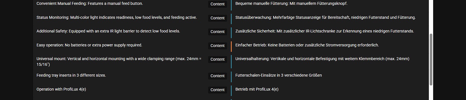

On "Mitras LX7 IL Series" I clicked through all the translated segments and there were for some reason three segments that changed their status to "Draft" when I clicked them. See screenshot.
I saved these segments again, then completed the translation and the status changed to "Completed".
I then edited the original product again, save it and opened the WPML Translation Editor to complete the translation again.
The issue did not occur again and the translation is now completing as expected.
I am not sure what caused this issue, but I suspect that there used to be an issue on the past with translating specific strings, like the HTML entity for example, and since this issue was solved, the segments needed to be saved again.
Regarding the tables:
It might be unrealted, as I could not replicate this issue on our test site, but fact is, that I created earlier a copy of the page. I then tried to translate this copy and had the same issue. Once I removed the tables the translation worked.
On "Automatic Fish Feeder" I also went through all the translated segments and also here one segments changed its status to "Draft". In this case the HTML marker was missing on "Easy operation" - see screenshot.
It is expected in this case that you will not be able to complete the translation. What is unexpected is that the segments was actually marked as completed.
I completed the segment and translation got completed.I then edited again the original content, and updated the translation and the issue was not replicable.
After those tests, there is still not an issue that I can replicate. The issues were solved after making sure that each segment is completed.
