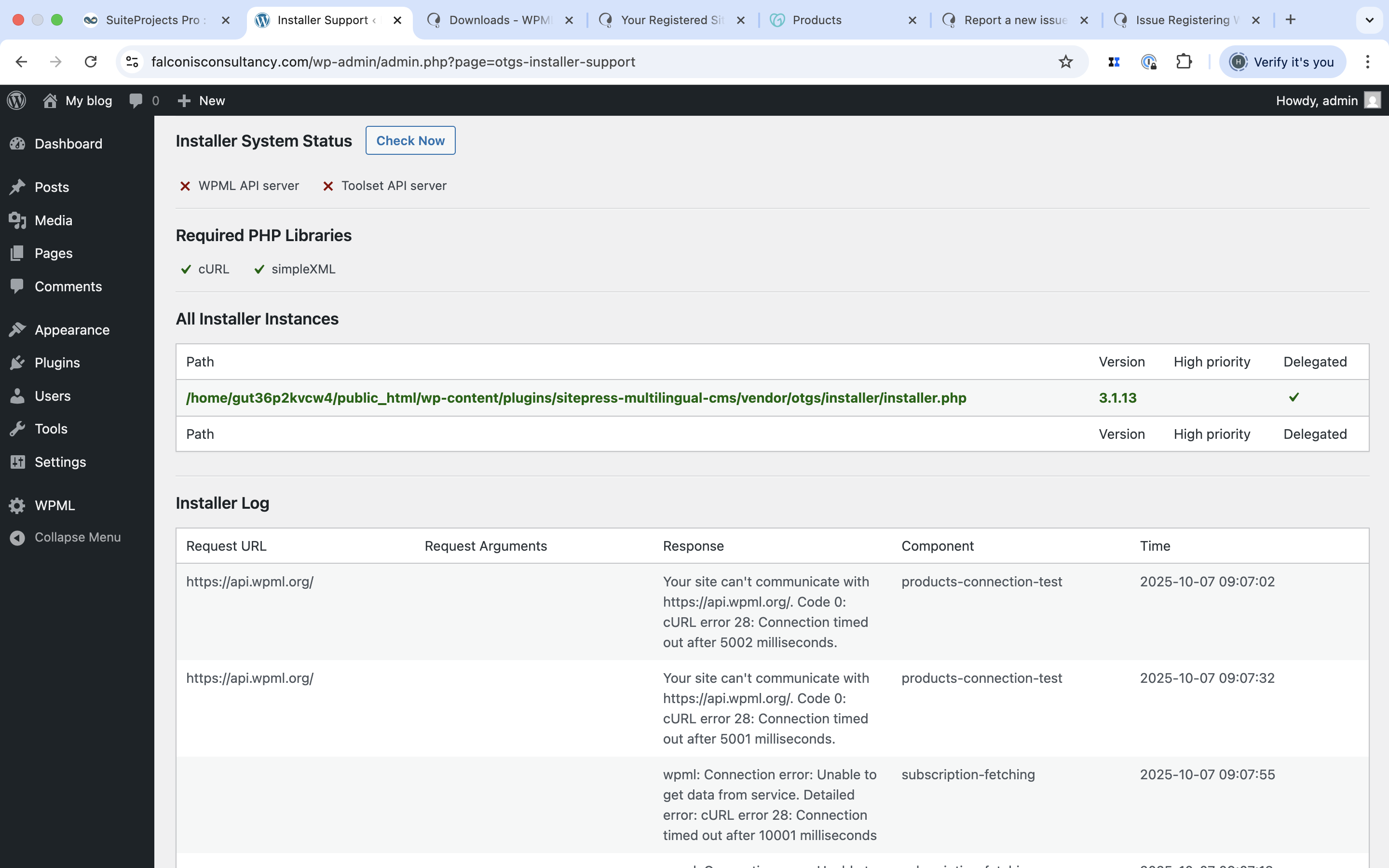

I am trying to register my WPML installation by adding the Site key generated from your systems. My website is hosted with GoDaddy, and they confirm the subdomains relevant to WPML are not blocked.
I get the error "Your site can't communicate with hidden link. Code 0: cURL error 28: Connection timed out after 5002 milliseconds." and also "Your site can't communicate with hidden link. Code 0: cURL error 28: Connection timed out after 5001 milliseconds."
Can you please help with the connection timeout error when registering WPML?

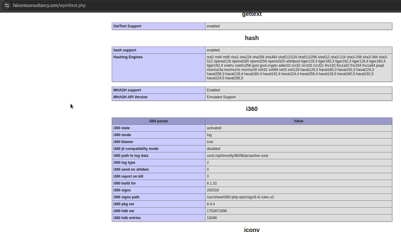

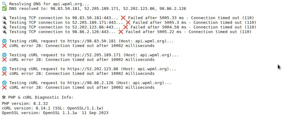

Unfortunately, there's nothing we can do from our side. Our 2nd Tier Support investigated and found the following:
It's very suspicious, and we noticed that the i360 firewall is active on the hosting server (see screenshot php.png).
The system is unable to connect to the server at all.
Since the IP resolves correctly, we can rule out any DNS-related issues.
A connection attempt is made using cURL, but it fails. The issue lies with the client’s hosting provider — something on their end is blocking the request (refer to timeout.png).
We recommend reaching out to the hosting provider to investigate further.

The hosting provider team got back to me with the following:
The CloudLinux team and the software engineer assigned to the case have allowed all IPs under Immunify360, and they even went as far as to completely disable and shut down Immunify360 temporarily, but the api.toolset.com remains inaccessible.
Would it be possible for you to contact WPML and ask them to check if the server IP 192.169.172.41 is by any chance blocked by the api.toolset.com service?
Appreciate if you can test the IP above is blocked by api.toolset.com?
