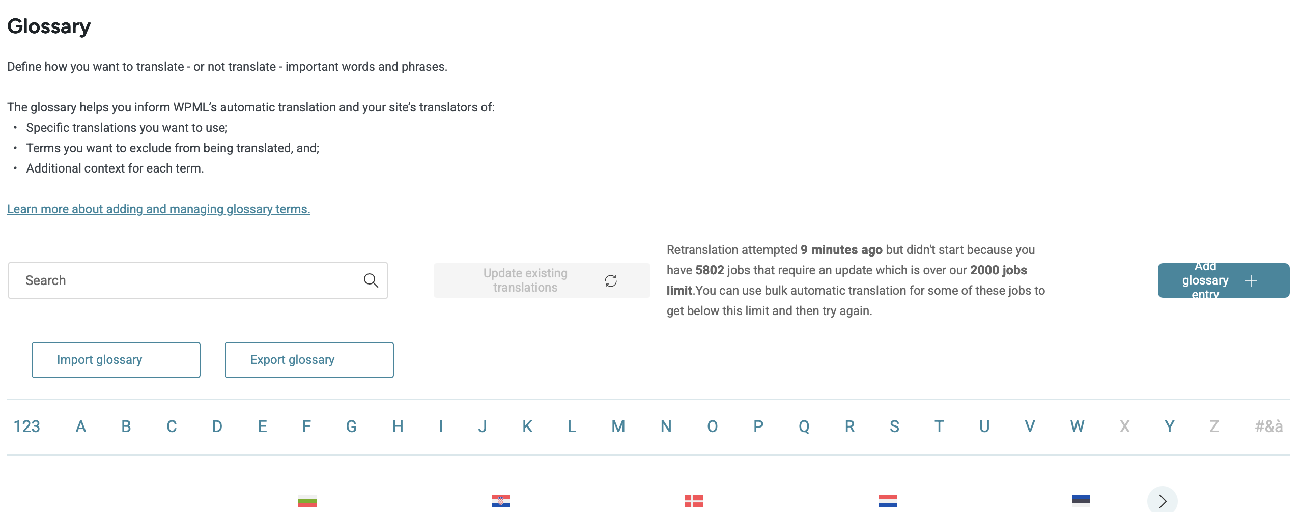

To prevent extra costs by translating twice - I used the update translations button. But I get this notification:
"Retranslation attempted 14 minutes ago but didn't start because you have 5802 jobs that require an update which is over our 2000 jobs limit.You can use bulk automatic translation for some of these jobs to get below this limit and then try again."
How should I approach this?

August 29, 2025 at 2:20 pm #17358381
Alejandro
WPML Supporter since 01/2018
If you have too many jobs in a short amount of time, yes, you won't be able to retranslate it. we're working to remove that limitation and the fix is almost there 🙂
About the type issue, can you send me the CSV you were uploading? So I can try to use it and test what you mentioned and check with our devs how to fix that or why it's happening because i had tested it before letting you know and things were working normally.
