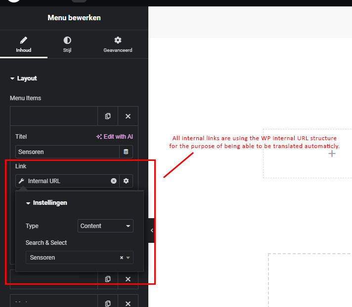

Dear support,
We're using Elementor (Pro) and the default Elementor widgets. The internal links have there title translated but do not have there href updated to the accompanying page. Instead they point to the original URL. Some URL's have there href point to a page id instead of the propper URL.
Nearly all links/URLs are configured trough Elementor to use the internal link settings with WordPress for the purpose of being able to be translated automatically.
We've tried the options bellow:
- WPML->Settings->Scanning for modified URL's
- Editing the original page or Elementor template and then updating the translation
- Re-saving permalinks
- Deleting the page/(Elementor)template and re-translating it

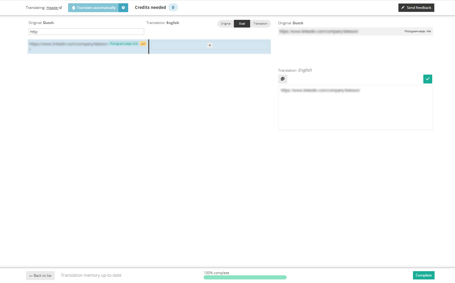

Would you please check and see if the Advanced Translation Editor considers this as an external URL? You can check that by searching the URL:
https://wpml.org/faq/how-to-translate-urls-shortcodes-and-html-attributes-using-the-advanced-translation-editor/
If yes, then would you please see if the same thing happens on the clean installation below?
That way we will understand that if it is isolated to your website or not.

Hi Christopher,
Thank you for your response. We've checked the Advanced Translation Editor and the URL's are not shown. The only URL's that are shown in the Advanced Translation Editor are the external URL's, which is one. We've attached a screenshot to illustrate what we see.
We've double checked on other pages, with the same result. Only URL's to external websites are shown when we type 'http' or 'www' in the search box on the Advanced Translation Editor screen.
This is the first time that our internal URL's are not translated. We've also double checked the hosting environment WP_MEMORY etc.
