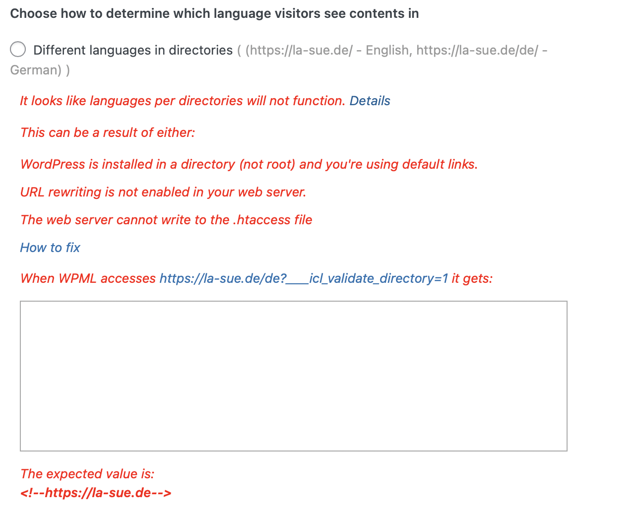

I want to switch languages with the option URL rewriting. When I try to select that option there is a red below the message. I have tried to fix it but have not been able to do. Could you please help me to solve this problem?
Kind regards
"It looks like languages per directories will not function. Details
This can be a result of either:
WordPress is installed in a directory (not root) and you're using default links.
URL rewriting is not enabled in your web server.
The web server cannot write to the .htaccess file"

This is a common false-positive notice, and the best way to verify this is by setting the Language URL Format and visiting the front end.
if the front end is displaying as expected, then this is verified as a false negative and you can continue using the URL Structure without problems
if you are seeing an error 500, blank page or error 503 in the front end and its resolved by changing the URL Structure then we will need to further inspect the issue.
