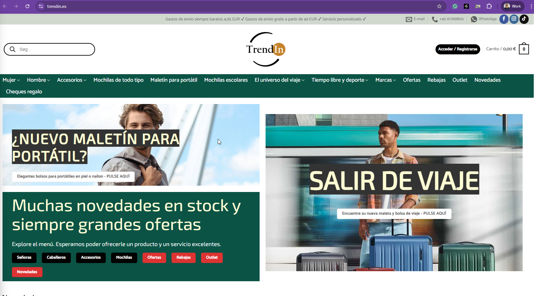

Open on a PC:
trendin.dk
trendin.es
... and see the difference in the top pictures. Thats all.
WPML does not sync. changes in structure from primary lang. to secondary lang.
This has been the experience from our start with WPML, sync. is hard to get working.
If you do this, you will see the problem right away, and I guess you have heard something simmilar before - and know the solution.

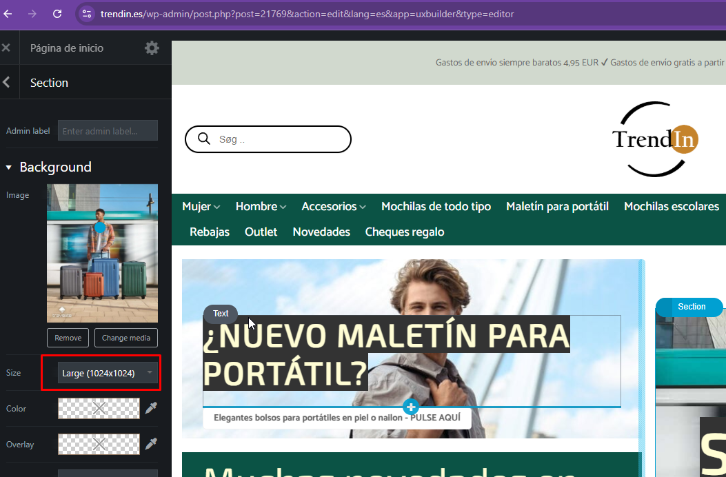

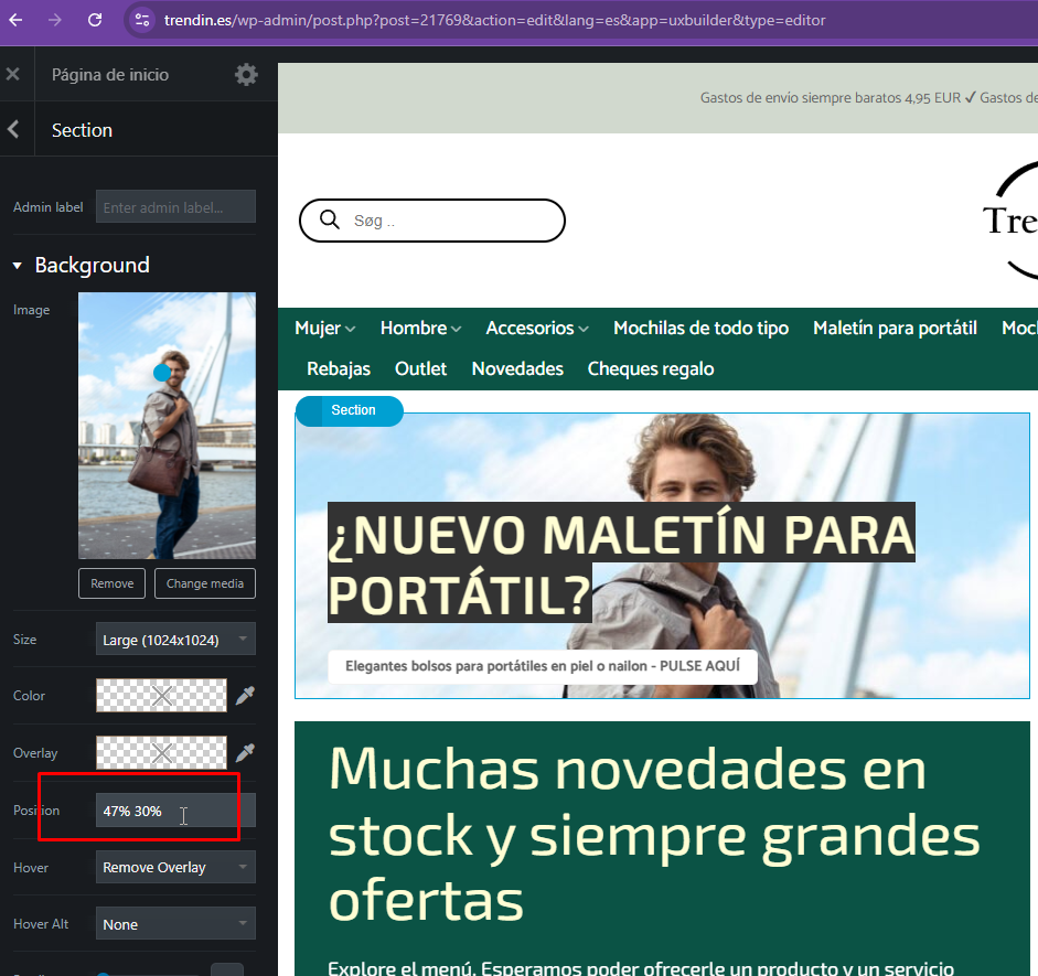

Thanks for your reply. Sorry for the delays due to the weekends. I've checked and compared both homepages hidden link and hidden link and the images on the top look the same as shown in the attached screenshot. Did you manually correct it on your own?
September 30, 2025 at 6:18 am #17442625

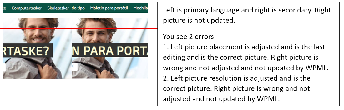

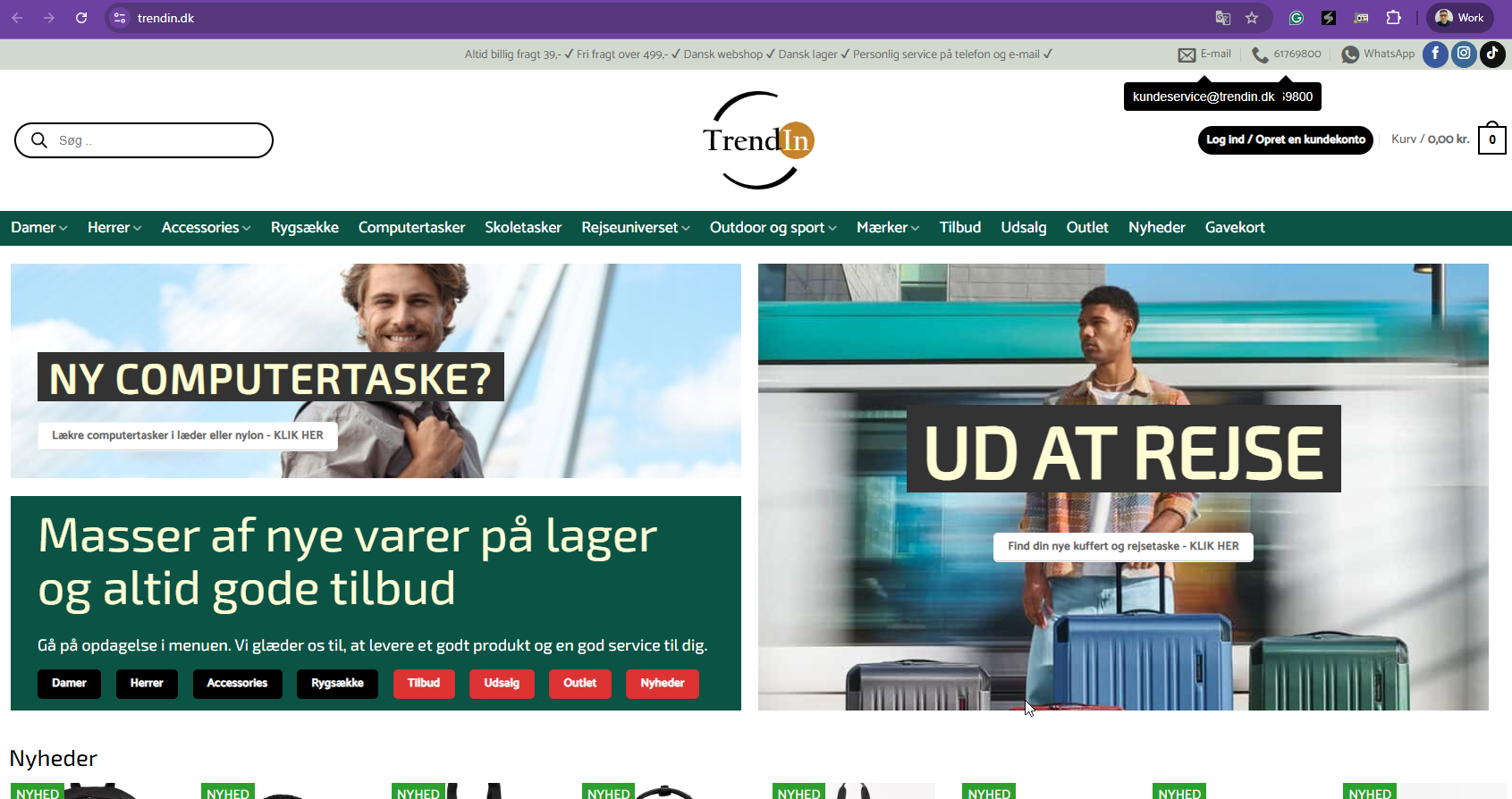

michaelR-151
Hi Kor.
What do you mean? If you look, they are very different in both placement and resolution. The right picture is outdated in both things.
See attached file. Left is primary language and right is secondary. Right picture is not updated, is old version.
You see 2 errors:
1. Left picture placement is adjusted and is the last editing and is the correct picture. Right picture is wrong and not adjusted and not updated by WPML.
2. Left picture resolution is adjusted and is the correct picture. Right picture is wrong and not adjusted and not updated by WPML. You see a lower resolution in the left original if you look carefully.
The same goes for the the other top picture with the black guy. Not updated in secondary language.
Meaning, WPML is not updating site structure, as I wrote. it is a problem, and we have had it before. Please find ud why and fix - solid, so I do not see this again and again.
Regards
Michael

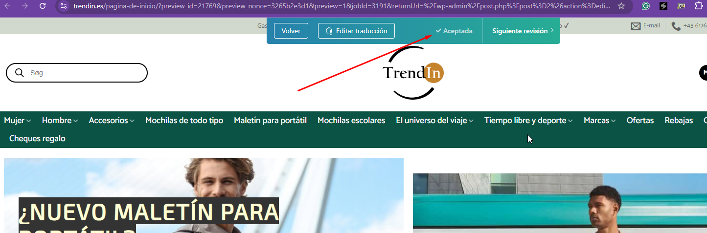

September 30, 2025 at 12:49 pm #17444491

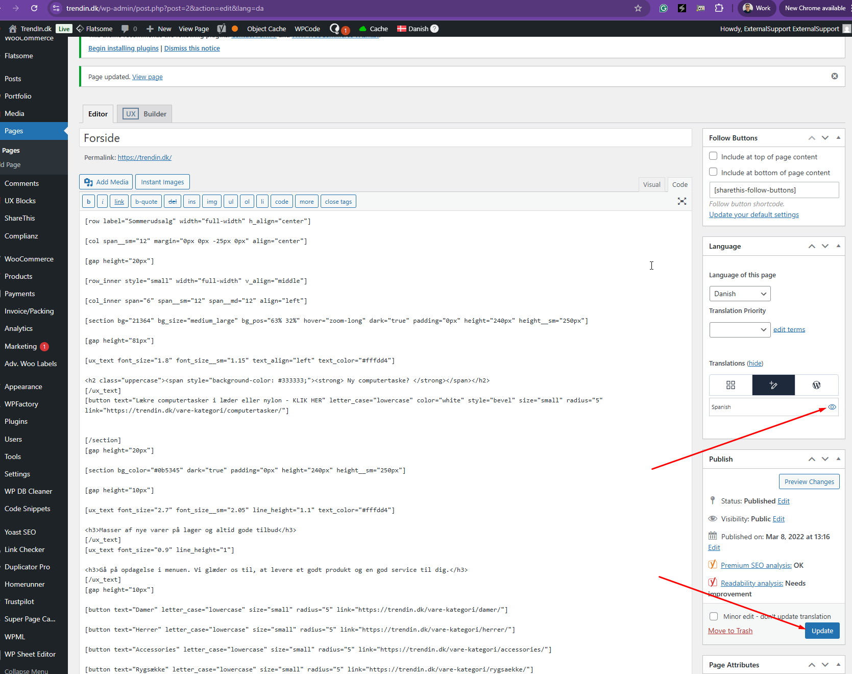

Thanks for your patience. I’ve identified the issue. When comparing the editors for DK and ES, I noticed that the image size and position are different. Let me investigate why they’re not syncing properly.
September 30, 2025 at 12:56 pm #17444714
Thanks for your patience. On the primary language homepage editor hidden link , I clicked the Update button and then reviewed the Spanish translation. It now displays correctly.
This means that if you make changes to the primary language page (such as image size or position), you’ll need to resync or retranslate it.
Could you check again here: hidden link ?

October 1, 2025 at 2:01 pm #17449119
This is the step you should follow when editing the primary language page.
1. Edit the primary language page.
2. Open the UXbuilder and make the changes. Save it.
3. Return to your page editor and click on "update."
4. The page will sync and translate the page to another language.
5. In the Advanced Translation Editor, click save.
Then check the frontend to confirm the changes.
Let me know if this is what you've done earlier.

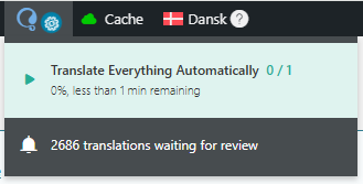

We have started using WPML for real for the first time, and many things went ok.
But not we have the old "gearwheel running for ever" error again.
"Translate Everything Automatically 0 / 1
0%, less than 1 min remaining"
Se clips also.
Meaning WPML is out of control and not working right.
Please fix and please fix so we do not have this again.
You have login + password, same as earlier.
Regards
Michael
October 6, 2025 at 1:17 am #17457903
Thanks for your reply. Ok, I can see the issue. Could you perform a full backup of the site? I need to run some troubleshooting options again here hidden link
