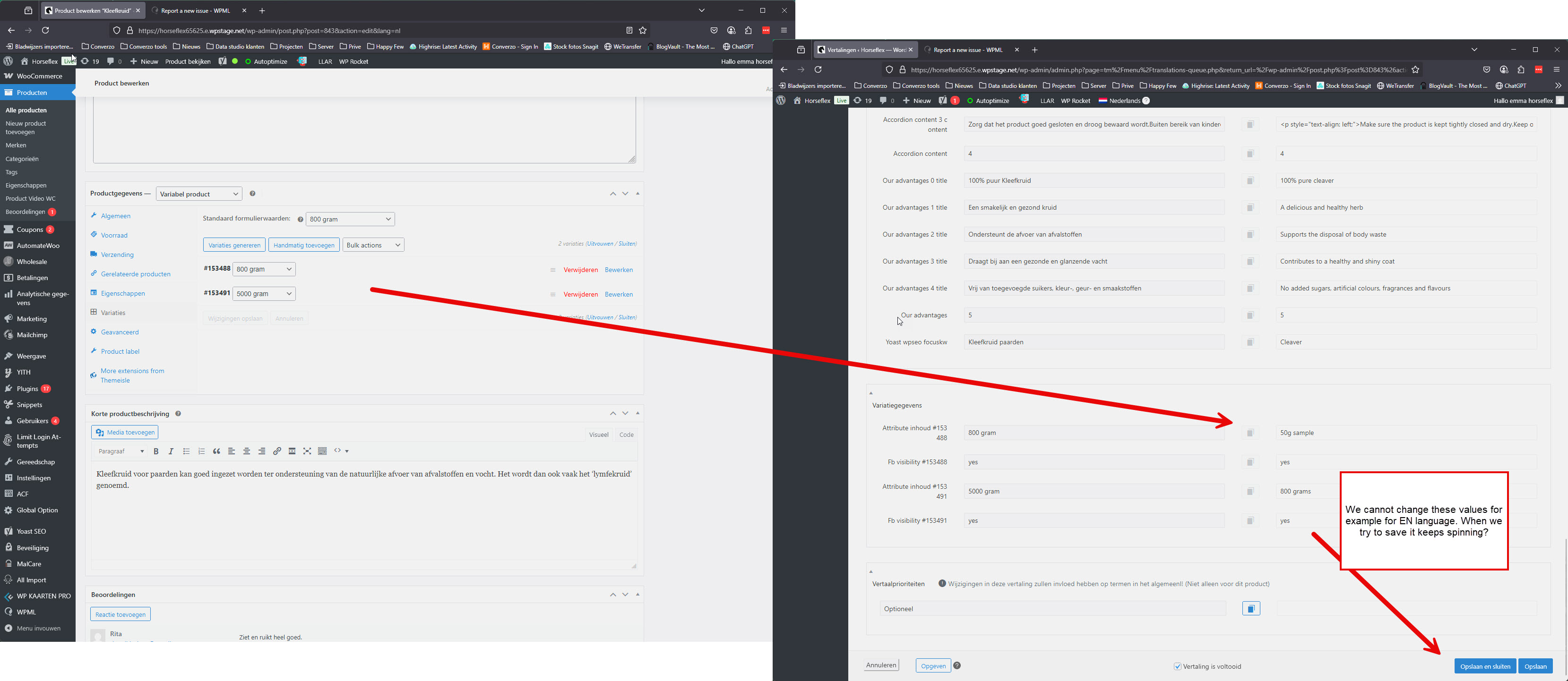

I am trying to translate product variations in WooCommerce using WPML on my site hidden link. The specific product I am working on is located at hidden link. The site is password protected for additional safety, and I have provided the necessary credentials for access.
In the translations, the variations do not correspond to the original variations in Dutch (NL).
How can we fix this so that variations of the product are the same in every language?

I have no conclusion yet on what is causing this problem. Please try the following.
We suspect a collision with the theme or another plugin might cause this problem. If possible, get your site into a minimum environment, switching to a default WordPress theme like TwentyTwenty-Four and having no plugins activated except WPML.
First, you must check if the problem persists when just the theme is switched to TwentyTwenty-Four (for example). If it persists, deactivate all plugins except WPML and its add-ons and WooCommerce without any extensions. Then, please check if the problem persists. If it does not continue, start by activating the plugins individually and checking when the issue comes back, then report to me which plugin was the culprit.

Hello Itamar,
We have tried this but this does not make any difference the problem is still there.
You can also try yourself, as i mentioned before this is a staging environment you can do whatever you want on this environment to solve the issue.
Please advice next steps to solve this issue for our client.

I've tried the minimum environment procedure on your site, but the problem persists. I must mention that some of the plugins can't be deactivated. I also tried all the troubleshooting options in WPML -> Support -> Troubleshooting, but it didn't help either. It seems I need ot esclate this issue to our second-tier supporters. I must have your permission to take a copy of your site for this. I must install a plugin like Duplicator or All In One Migration to do this. Please let me know if you agree.

We solved this issue ourself by removing and adding the variations. Thanks anyway for your help.
