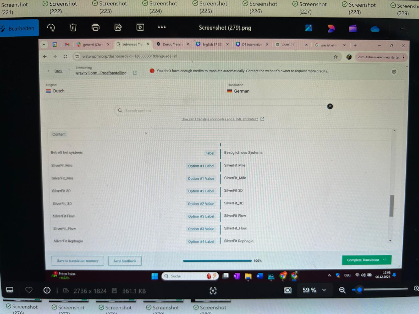

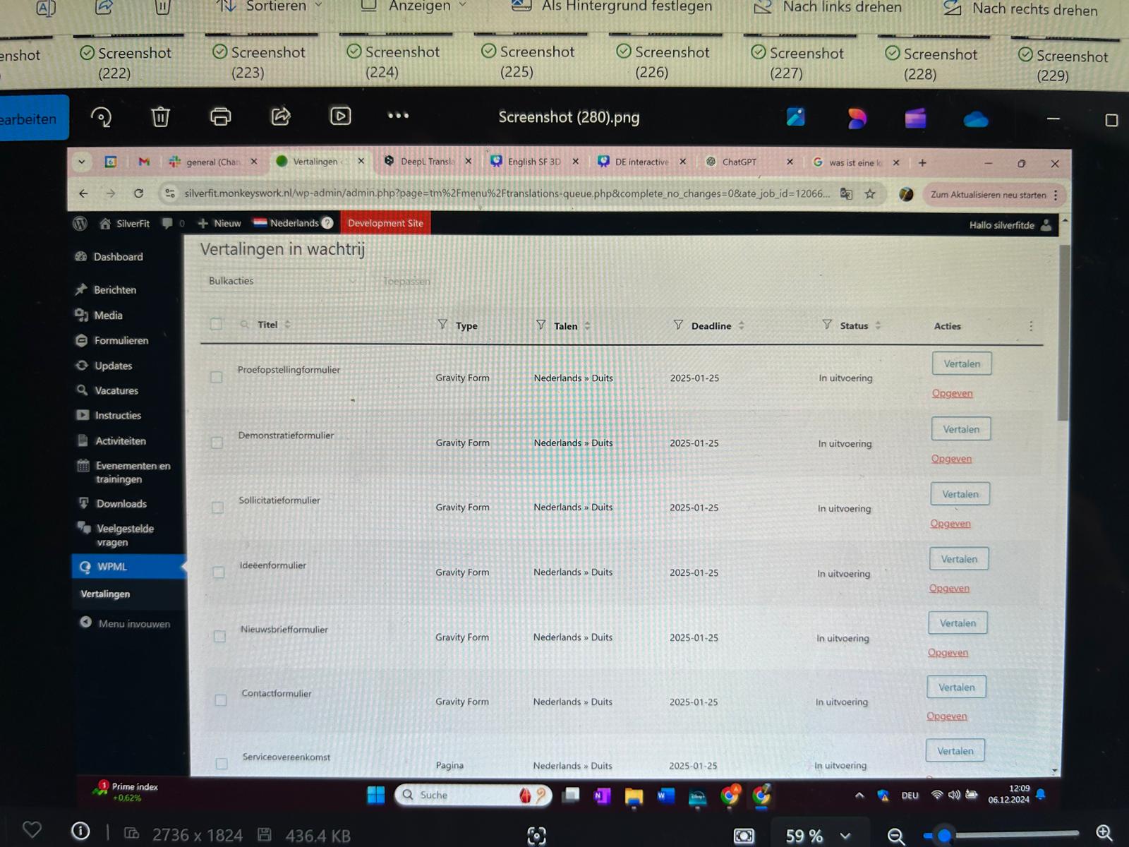

We are in the process of translating the website hidden link using WPML. We followed the full WPML documentation.
1. All text boxes are marked blue, but the overall progress bar shows orange, preventing the translation from being marked as complete. 2. All text boxes and the overall progress bar are blue, yet the translation task still appears as 'in uitvoering', especially with Gravity Forms. 3. Translated items are not saved despite using the 'complete translation' or 'translation memory' buttons.
Why does the overall progress bar show orange even though all text boxes are marked blue?
Why does the translation task appear as 'in uitvoering' despite the progress bar being blue?
Why are translated items not saved after using the 'complete translation' or 'translation memory' buttons?
See screenshot. And here an example for one of the other issues, everything is blue (items and progress bar) for the Gravity Form ‘Proefopstelling'. But here said form is still marked as ‘In uitvoering' (it’s the first item on top).

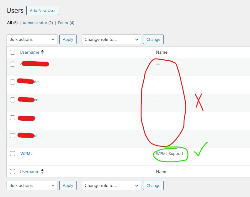

- Corrected my user (you provided for login) to have proper first name and last name.

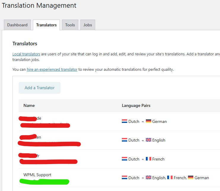

- Added this user to Translators with language pairs (Dutch to all 3 langs).

- The users you've added as translators, are missing their first and last names. Although it shouldn't be a problem, but it is recommended that the user which are also the translators, must have first/last names and emails filled in their profile.
