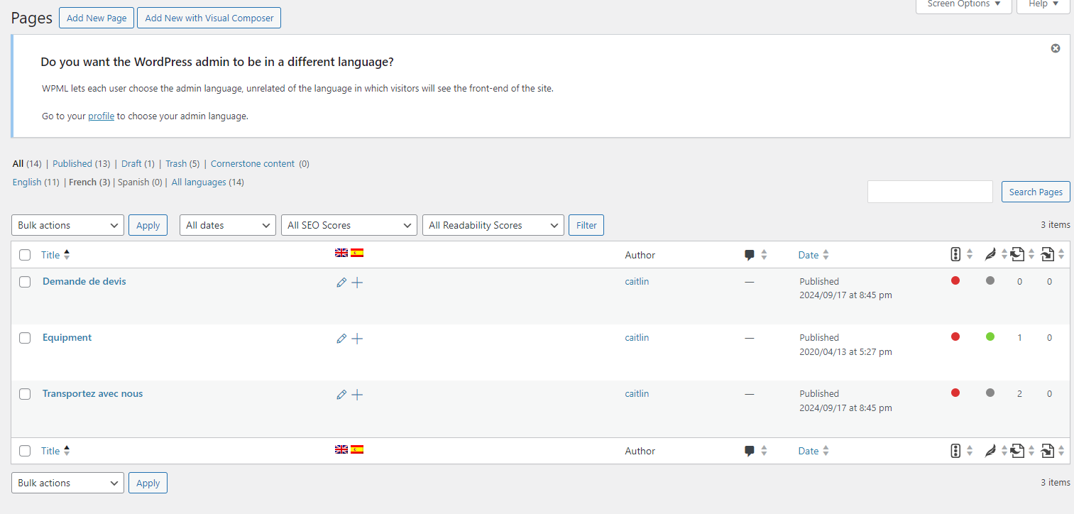

I used the Translation Management and it says the pages are translated to French. See screenshot. hidden link
However as shown in the screenshot, the French pages are not created. The page Equipment was created through the duplicate option but the visual composer content is not French.
French pages not automatically created.
Visual Composer content not translated.
What's the procedure to automatically translate visual composer (hidden link) content?

I understand the issue you're encountering. From the screenshot, it appears that all pages in French are marked as "Translated," so they should be visible in the French language. Additionally, there isn't a separate process for translating pages built with Visual Composer. If you're using the default VC modules and automatic translation is enabled on your site, the content should automatically appear translated without any extra steps.
Since the French pages aren't visible even though their status shows as "Translated" in translation management, the issue might be related to synchronization. Please try the following steps and check if they help.
- Please go to WPML > Support > Troubleshooting
- Click on the following buttons:
-- Synchronize posts taxonomies [Select 'Pages' from the dropdown and then click the button]
-- Clear the cache in WPML
-- Remove ghost entries from the translation tables
-- Fix element_type collation
-- Fix WPML tables collation
-- Synchronize local job ids with ATE jobs
-- Synchronize translators and translation managers with ATE
-- Assign translation status to duplicated content
-- Set language information
-- Fix post type assignment for translations
- Once done, clear the caches from your site and browser.
Check if the pages are visible in the French language section. If they’re not, try sending another page for translation into French. Once the translation is complete, see if the French page appears.
Please let me know how it goes. I'll be happy to help if you need further assistance in this matter.

This fixed the missing pages issue.
