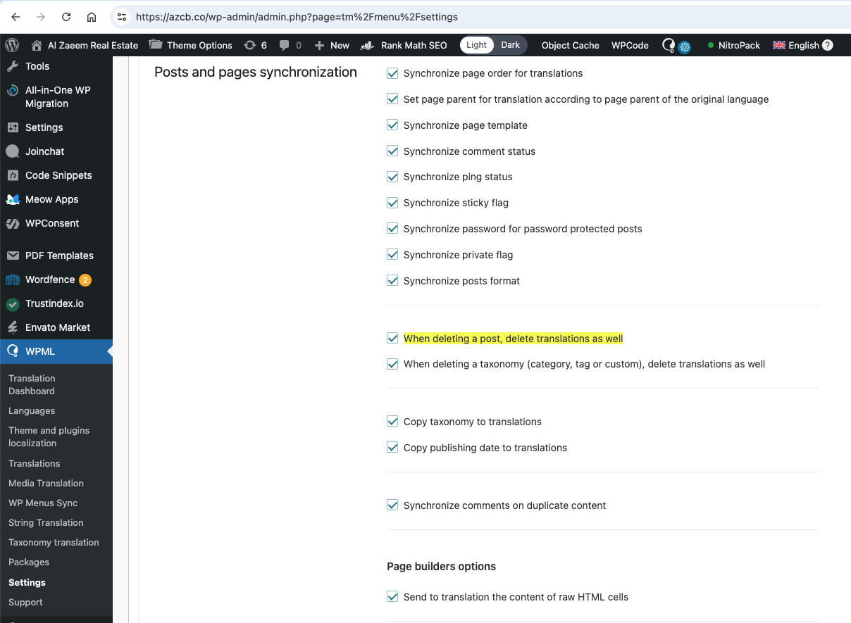

Thanks. I have seen that you have already enabled some options in WPML Setting to remove translated posts when the original post is removed (see the screenshot). Can you explain whether you enabled these options after the posts had already been translated and after the original posts had been removed?
Please also provide the exact steps to reproduce the issue, because it is not clear which posts are involved, what you expected to happen, or any useful links for the investigation. Please also share some screenshots or a video where the issue is visible.

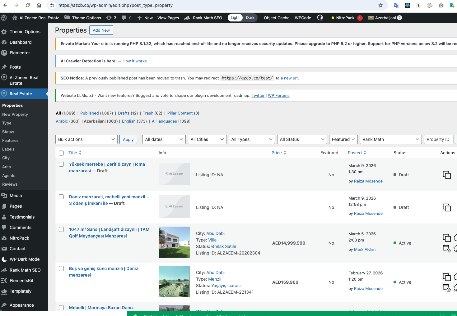

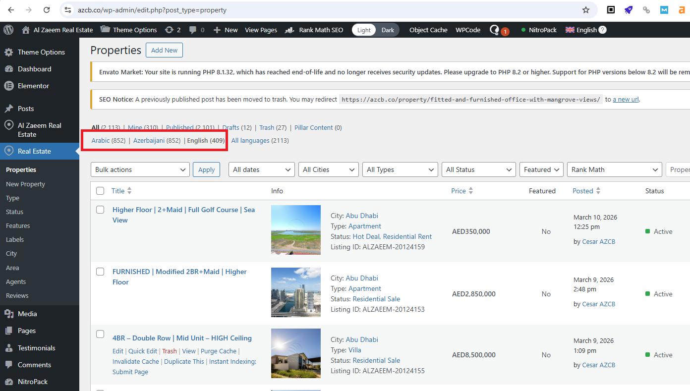

Hi Giuseppe,
I have attached two screenshots to explain my problem. The problem is with Property Listings. Please go to Dashboard > Real Estate > Properties, you will note that the original English Property Listings are showing only 409, however Arabic and Azerbaijani both showing as 852.
I read your response very carefully, and maybe, this is possible that we enabled this option after the posts had already been translated.
To clear this mess and reduce the possibilities of being fined from the government, I decided to remove all Arabic and Azerbaijani property listings and translate from scratch but this will consume more credit and time, so I did not do it. I am seeking your support to help us find a way that these translated property listings should match the original listing.
Please help!

In the meantime, I've discovered something new worth sharing.
First, I want to clarify that the WPML option to remove translated content when the original post is deleted is actually enabled correctly — so the problem seems not related to that setting.
It looks like in the past "az" (Azerbaijani) was used as the primary language. As a result, there are 411 posts that were originally created in az and then translated to ar but not in English. (see the query and screenshot that I attached).
At some point the primary language was switched to English, and from that point 443 posts were created in English and translated to both az and ar.
This means the current content breakdown is:
- English: 443 posts (primary language)
- Azerbaijani (az): 443 posts translated from English + 411 posts that are still registered as originals in az (no English version exists for these)
- Arabic (ar): 443 posts translated from English + 411 posts translated from the old az originals (no English version exists for these)
In conclusion, the 411 az posts with no English counterpart — and their 411 ar translations — are the records we need to address.

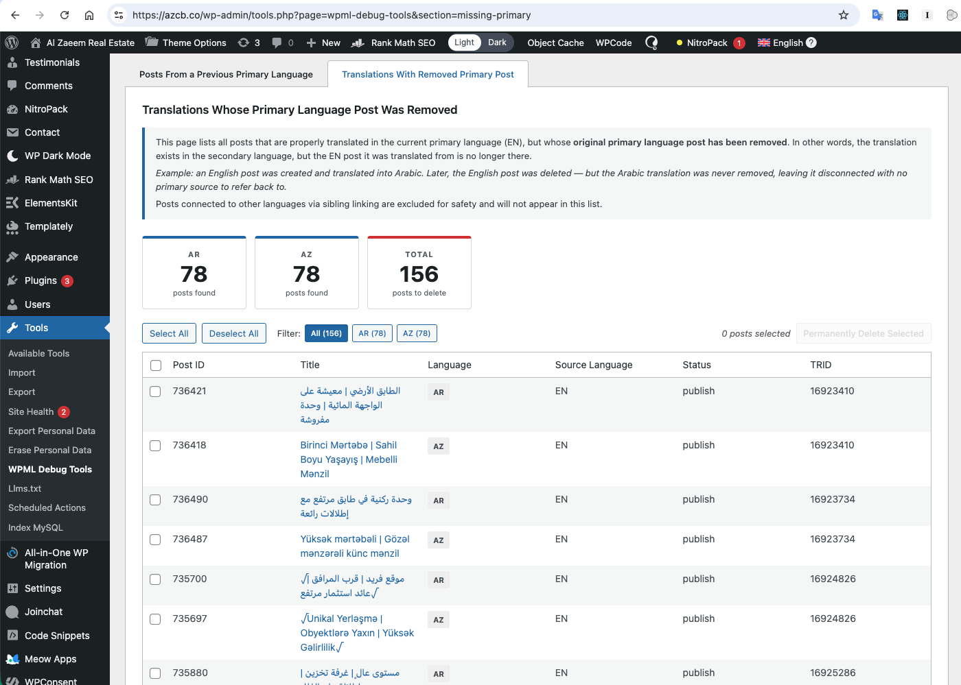

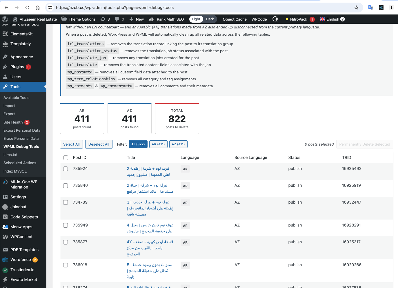

I built and installed a custom plugin called WPML Debug Tools that allowed me to safely identify and remove orphaned translation records from the database.
The plugin includes two tools:
1. Posts From a Previous Primary Language (see screenshot 1)
This tool identified all posts that were created or translated when Azerbaijani was the primary language of the site. After the switch to English, these posts were left without an English counterpart and were no longer reachable through the normal WPML workflow. I used this tool to permanently remove them.
2. Translations With Removed Primary Post (see screenshot 2)
This tool identified all posts that were properly translated from English at some point, but whose English original had since been deleted — leaving the translations disconnected with no source to refer back to. I used this tool to permanently remove those as well.
On a related note, WPML has a setting to automatically delete translations when the original post is removed — this is now correctly enabled on your site, so this issue should not occur again in the future. That said, please make sure to verify this behaviour whenever you delete a post in English.
In conclusion, the database is now clean and properly aligned. Posts in secondary languages (Azerbaijani and Arabic) are now fewer than posts in English, as expected (see screenshot 3).

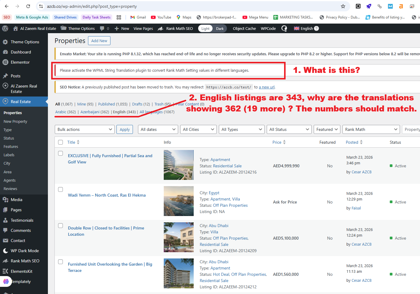

March 23, 2026 at 1:12 pm #17918731
hassanM-11
Dear Giuseppe,
Thank you for your support. We are currently reviewing the property listings and other content on the website and will inform you if we find any issues.
However, despite the setting you shared in your previous screenshot ("when deleting a post, delete translation as well"), we have noticed that the number of translated property listings is higher than the actual number of properties. Screenshot attached.
Could you please check this and clarify the reason? We want to fix this issue as soon as possible.

Giuseppe Toto
Yes, I confirmed that you still have some orphan records.
You can clean them manually by going here:
and selecting all of them.

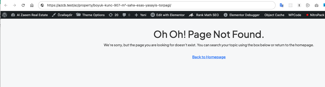

However, I checked whether the "when deleting a post, delete translation as well" option works properly by removing the post
"Large Corner 907SQM Plot | Prime Residential Land"
in my local WordPress copy, and its translations were removed correctly as well.
In fact, the translated link
was no longer available (see the screenshot).
Here are the steps you can replicate yourself to verify that translated posts are cleaned when the original post is removed:
  1. Go to hidden link
  2. Open the frontend link of an English post that you want to remove.
  3. Open the translated posts by switching the languages.
  4. Remove the original post.
  5. Then try to open both the original post and its translated links: they should no longer be available.
So, this means that everything seems to be working correctly.
