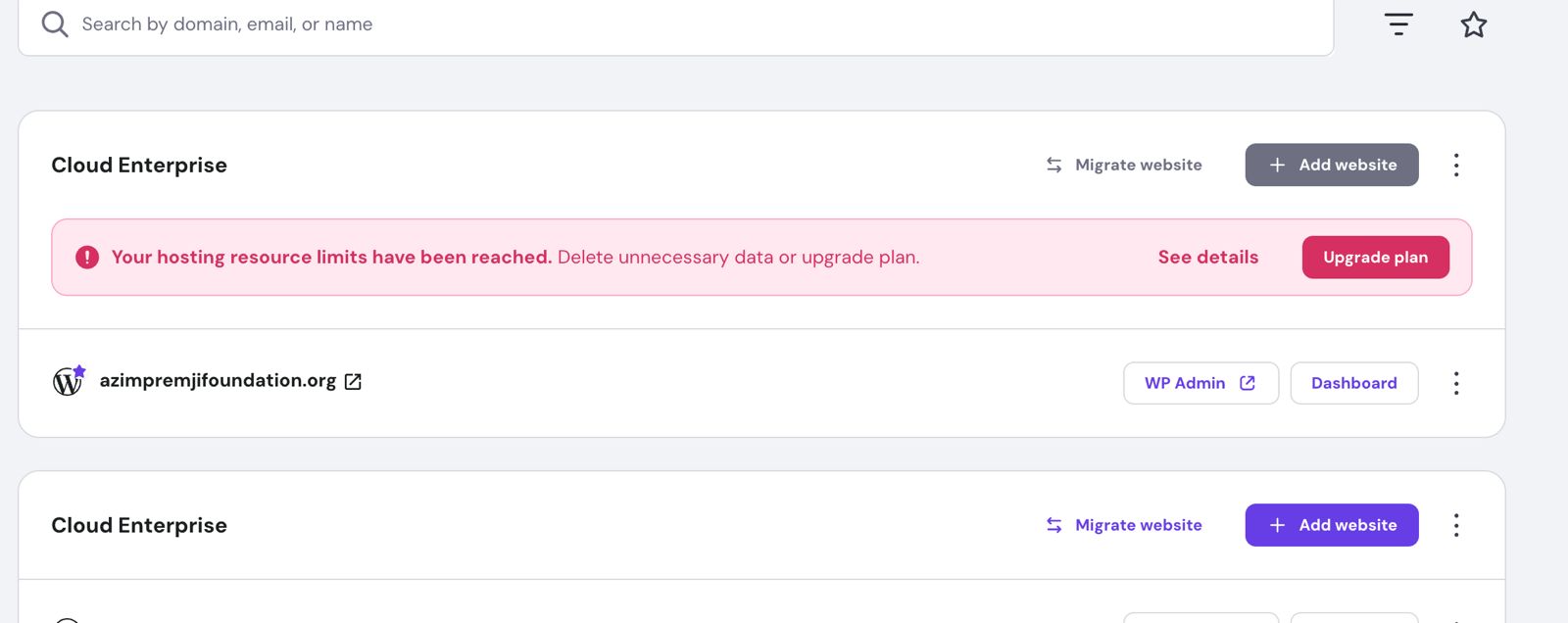

I am trying to perform page translations on my WordPress site hosted on Hostinger. The issue can be seen on this page: hidden link

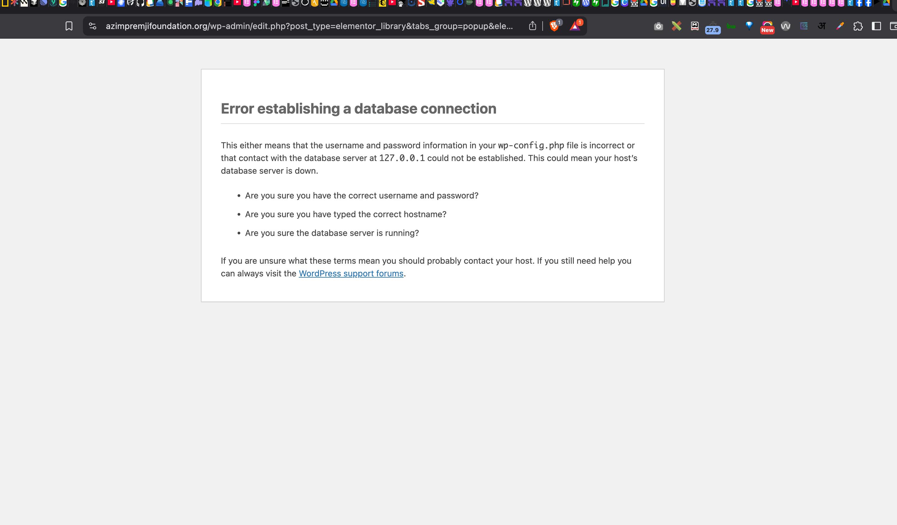

Whenever I perform page translations, the Hostinger server's CPU and memory usage hit 100%, resulting in a database error establishment error. This causes the site to slow down, experience downtime, or not load at all. If I do not interact with the admin -> page translations, the CPU and memory usage remain normal.
Why does the server CPU and memory usage spike to 100% during page translations?
How can I prevent the database error establishment error when performing page translations?

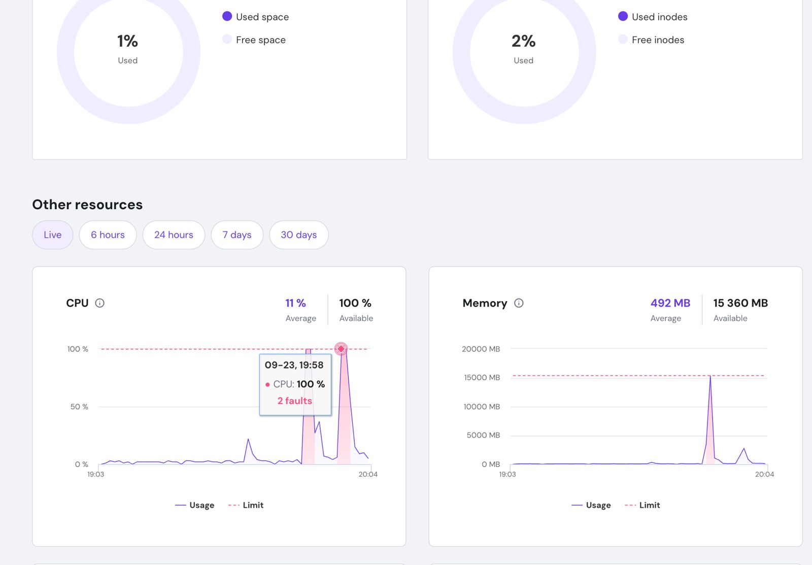

**“Could you share a reference screenshot showing how you are monitoring CPU and memory consumption while performing page translations? Also, have you tested this under higher visitor loads?
From our side, here’s what we observed:
1. When we perform translations, CPU and memory usage spikes, but it does not immediately throw a database error.
2. However, when translations are done during peak traffic (around 1–1.5 lakh visitors due to campaigns), CPU and memory hit 100%, which then triggers the ‘Error Establishing Database Connection’ issue.
3. Additionally, could you confirm if your team is using any cache plugins on your side? On the Hostinger server side, we are already using LiteSpeed Cache.”**
We had shared screenshots of this behavior in our earlier message.”**

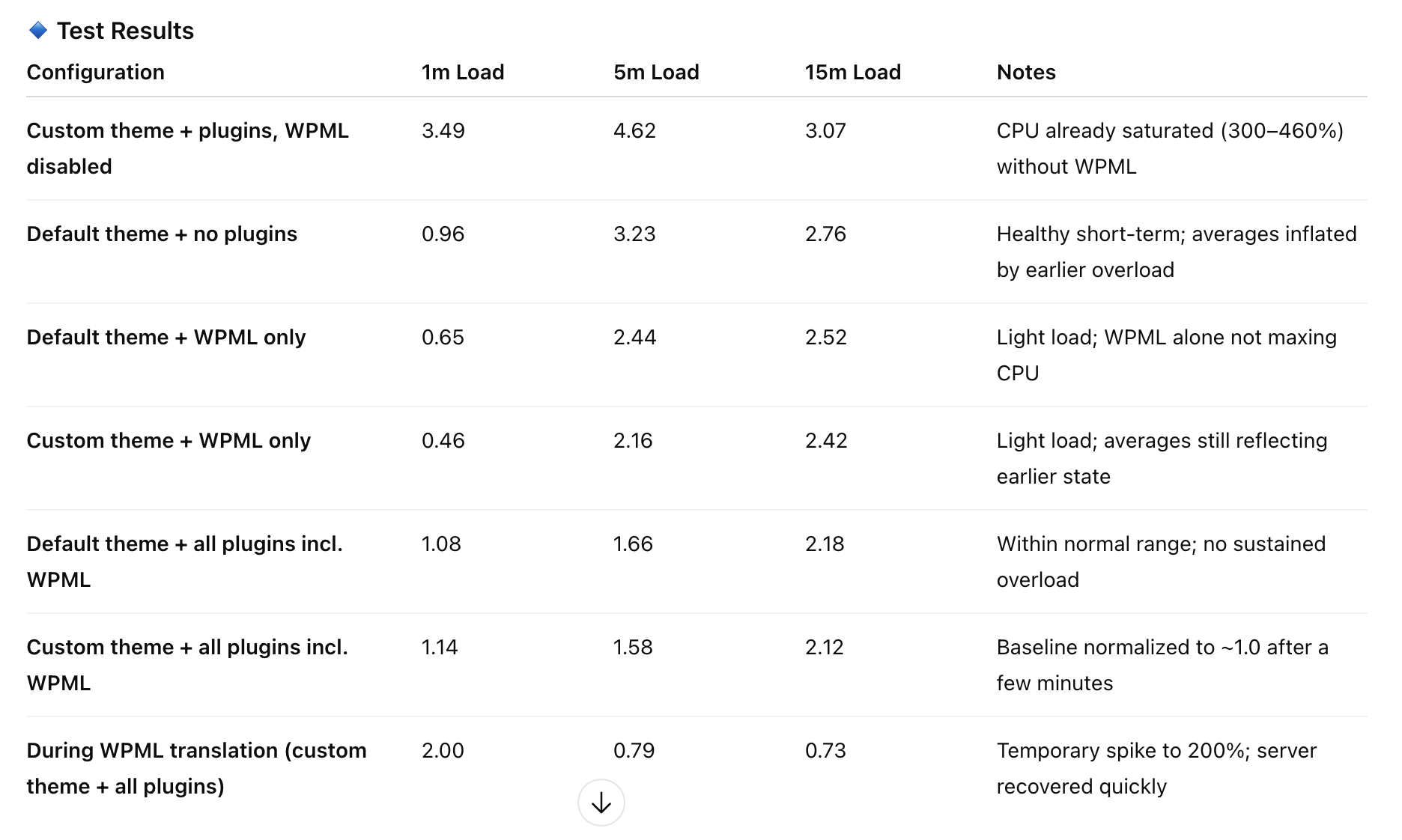

Also, have you tested this under higher visitor loads? Since it is a staging site, there are not high visitor loads. We are unable to test that. To better understand the reported high CPU usage during translations, I ran controlled benchmarks under different configurations. The Cloudways test server is a 1-core virtual machine (so a CPU load of 1.0 = 100% capacity). I have attached the test results in a screenshot.
Key Takeaways
-WPML alone does not max out CPU. In isolation, WPML runs well under capacity.
-The custom/child theme and plugin stack drive the high baseline load, even with WPML disabled.
-Translations cause short spikes (e.g., 2.0 on a 1-core server), which is expected because translations are compute-intensive. On multi-core servers, the same spike would be distributed and appear lower.
-The sustained overload we observed (300–460%) was not caused by WPML, but by the combination of custom/child theme + plugins running on limited resources.
Next Steps
1. Could you please confirm the hosting specifications (CPU cores, RAM) of your live site’s server? This will help us gauge whether it has enough resources to handle translations smoothly.
2. If the live server is also 1-core, upgrading to a 2–4 core plan would provide the headroom needed.
3. We also recommend an audit of the custom theme and plugins to identify additional performance bottlenecks. This means you should set up a copy of your site on your same server and deactivate non WPML plugins and switch to a default theme to see if the translations are spiking the CPU in that environment. if not, activate plugins a few at a time and check to see when the issue returns.

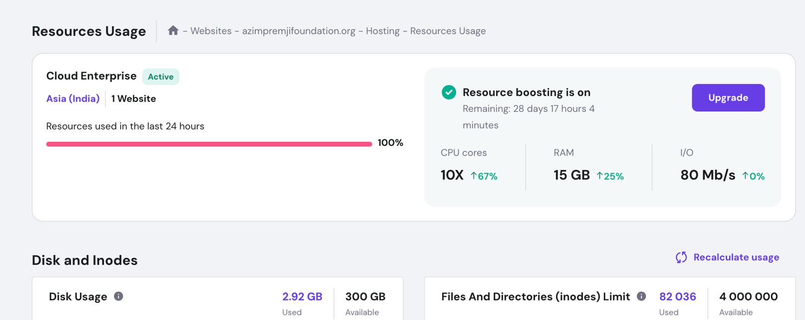

CPU cores -10X, 67%
RAM - 15 GB, 25%
I/O- 80 Mb/s, 0%
Earlier we have 6x, and 12gb later boosted to above configurations.
