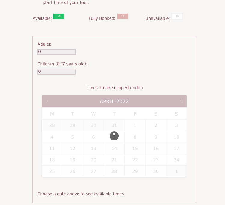

- Neither the English or French WC Booking forms are working. The WC Booking Calendars are not loading, causing an error on the console which I've included below.

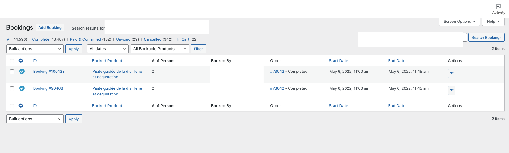

- No new bookings have actually been created using the French bookable product or the French resource, the reason I'm getting this error is WPML has created 2 copies of every English booking in French despite "Bookings (wc_booking)" being set to "Not translatable" in WPML settings. So for every booking a have a total of 3 bookings on 3 different booking numbers... I cannot find a way removing these duplicate bookings, I'm just getting an error when trying to trash them as they are also trying to trash the associated Order.

We have managed to fix the calendar not loading issue.
It was caused by one of the duplicate French WooCommerce Bookings which didn’t have a Bookable Product associated with it.
This issue still is not fully resolved however, as availability of WooCommerce Booking blocks is now being incorrectly impacted by these duplicate French bookings.

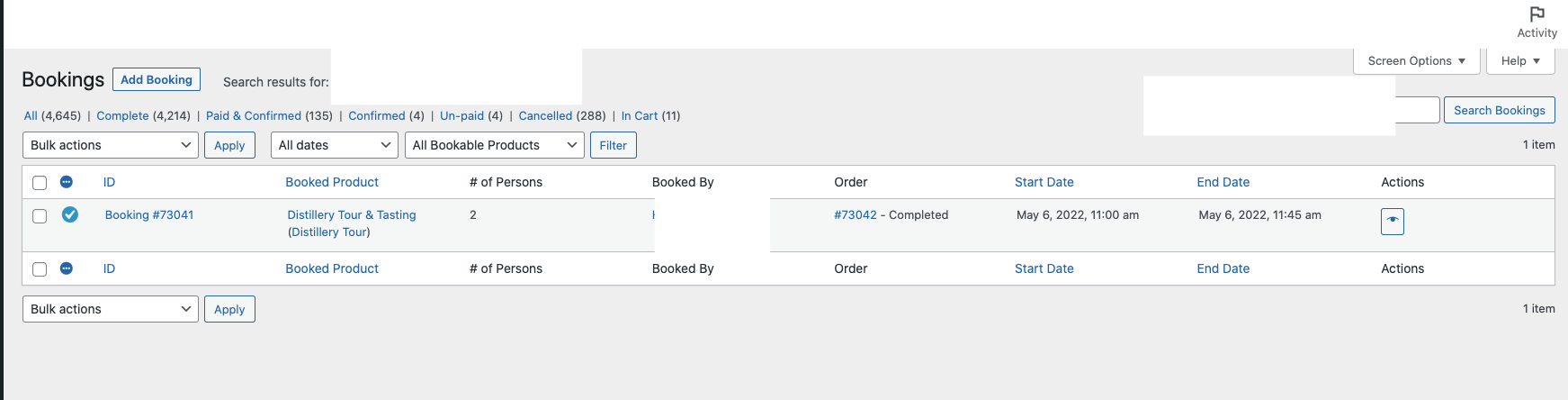

- I have thousands of duplicate bookings in French. These are duplicates of the English bookings. Here is an example, all of these bookings are the result of the order 71925 on which a customer booked once and paid once. In this case there are actually 2 x duplicates in French:
Screenshots:
- These duplicate bookings are having an impact on availability of WooCommerce Bookable Products on the front end calendars. Example here: hidden link of our WC Booking Resources block allows 10 x persons to be booked onto them. On my example below there is 1 x booking with 8 x persons booked on the 11am tour 2nd June 2022. On the front end calendar, I have no spaces available - I should have 2 (10 persons as defined on the WC Booking Resource less the 8 x persons booked on order 71925). So Woo Booking is counting the 2 x duplicate French bookings in addition to the original English booking when calculating what blocks are available for booking and so I have no 11am slot available for customers to book. This is incorrect.
Screenshots:
- All new bookings being created with WPML active are creating duplicate bookings in French as I’ve stated above, though most are only created 1 x duplicate rather than the 2 x in my example above. These duplicate bookings are impacting availability as I state above.
