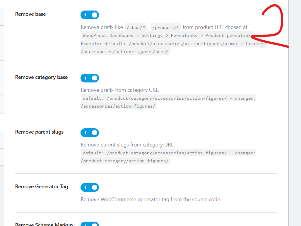

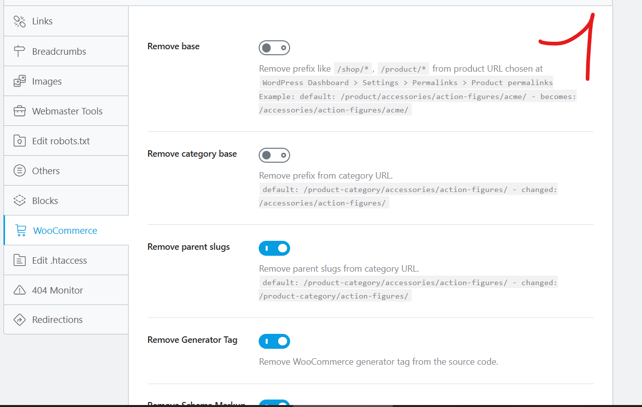

Adding some precisions. Screenshot 1, configuration is problematic. Screenshot 2, it works well.
However, I do need configuration 1 for analytics purpose (/product-category/ and /product/ in the urls). The configuration 2 was done a long time ago on another website and I don't want to create a mess with seo.

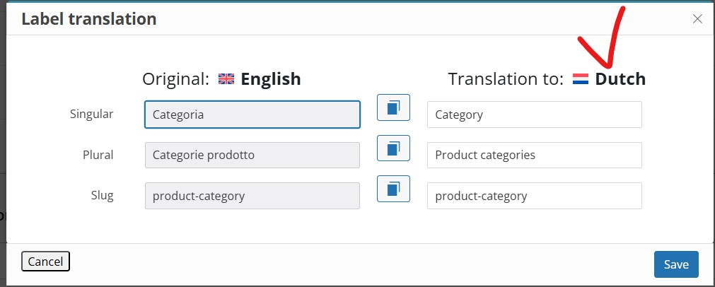

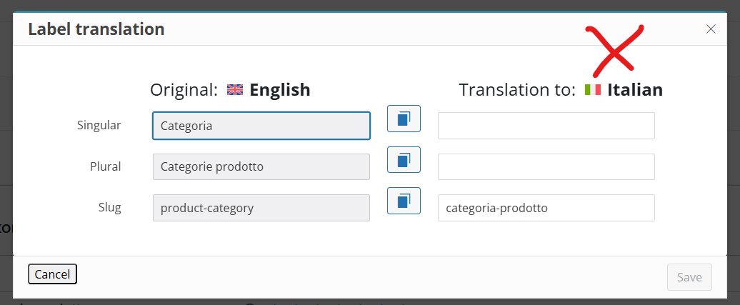

I found the issue. It is a bug related to "Slug translations".
I disabled this option because obviously I don't need it. However, when testing stuff on the staging website, I found out that some languages still have this slug translation.
Recap:
1/ Turn on "Slug translations" : WPML - Settings - Slug translations
2/ Check the slugs: WPML - Taxonomy Translation - Product Categories
3/ Result:
- Some languages already had their product category slug translated. These languages are all problematic (404 error when trying to open any product category).
- Other languages didn't have any slug translations (French, German). And they work just fine.
4/ The fix:
- Either the slug translation should be blank.
- Either the slug translation should be a copy of the original wordpress settings: product-category.
- Please advice, how to delete the slug translation for all taxonomies when disabling the function "Slug translations". This was my issue. For some reason, I had translations saved with the slug translation option disabled. Maybe I tested the function before and figured out it's useless in my case.
However, disabling the function should also delete the translated slugs. So this is your plugin improvement job.
I will just copy the original slug for the moment, for all languages. Since it works well. And I don't know how to delete this type of translations.

August 31, 2025 at 7:55 am #17360089
bikbulatovaE
I don't understand what you're talking about.
The problem is related to the translated taxonomy slugs, which are different from the standard WooCommerce ones:
- /product-category/
- /product-tag/
They should be identical to the default (English) ones and not translated.
You could improve the taxonomy slug translation option by removing the data entered when disabling the option. This was precisely my problem.
I didn't see the error until I re-enabled the slug translation option and viewed the translations on the Taxonomy > Product Category page. The two working languages, French and German, had no slug translations. All other languages ​​were buggy and had translations in Italian, Dutch, Spanish, etc.
After copying the default English slug to the other languages, everything worked.
