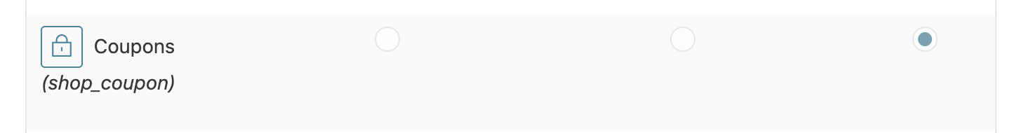

The post type "shop_coupon" is correctly set to the recommended setting of "Not Translatable" (screenshot)

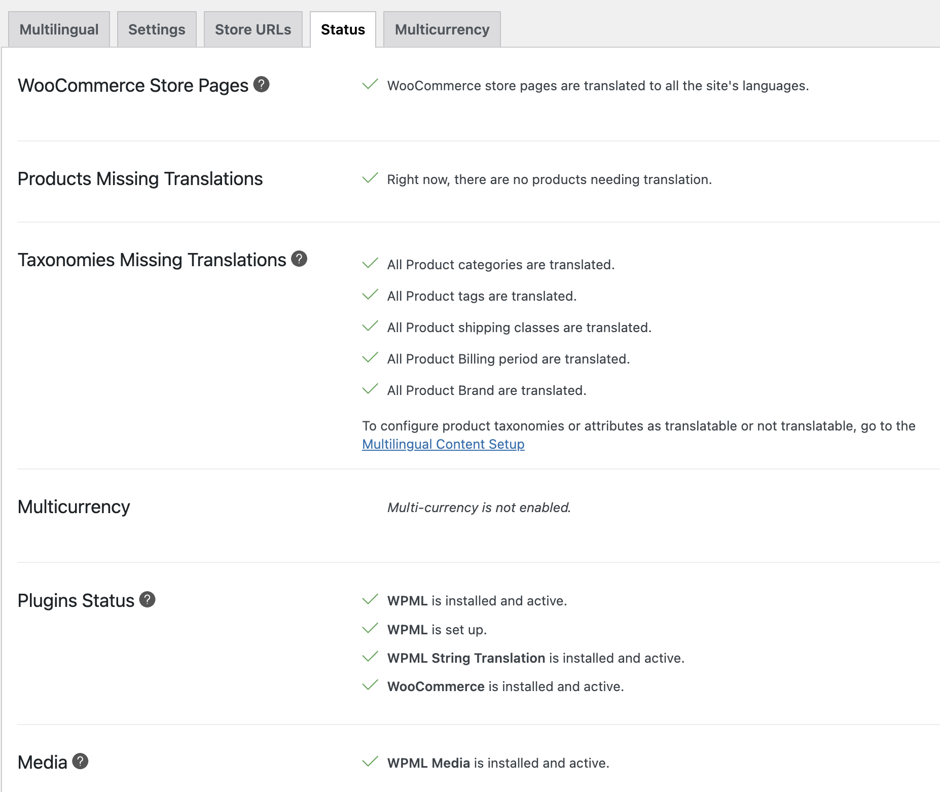

WooCommerce Multilingual & Multicurrency is active on our site, if that's relevant. According to its status page everything looks good (green ticks everywhere, see screenshot).

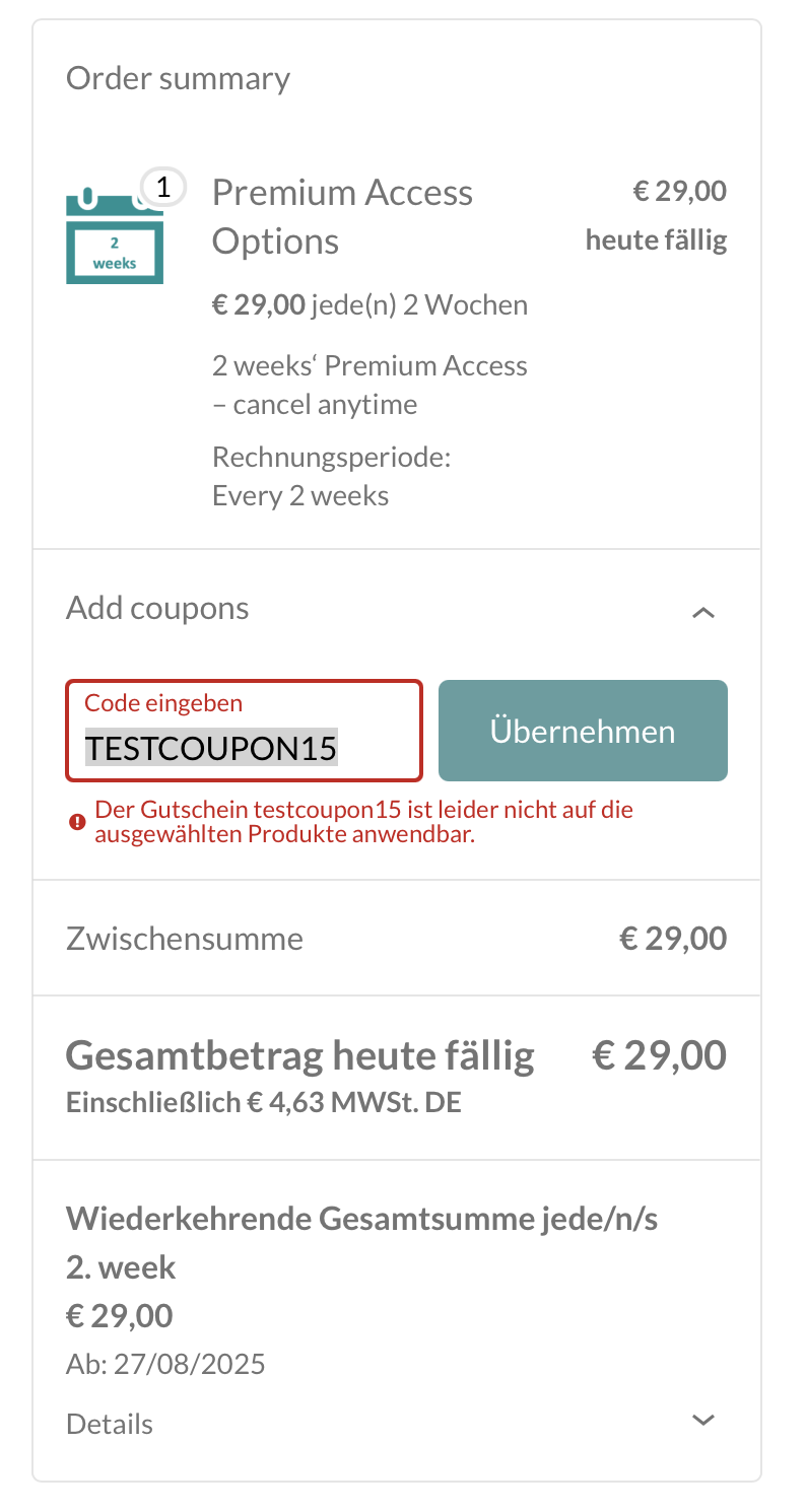

I downloaded and installed the latest version of WPML SEO and cleared the WP Rocket Cache, but that didn't solve the issue either.

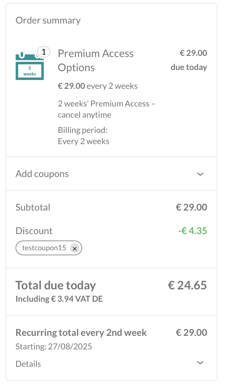

Also attached are the two screenshots, showing the coupon being applied successfully in our pimary language English and NOT being applied correctly in German.

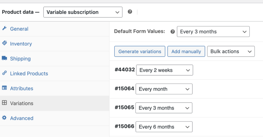

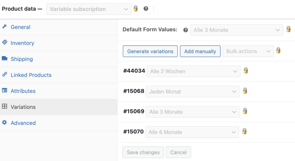

WooCommerce Support has spotted the issue:
The English subscription product (ID 15063) has the variations: #44032, 15064, #15065, #15066.
The German subscription product (ID 15067) has the variations: #44034, #15068, #15069, #15070.
However, when going through the add-to-cart process on both the English and German versions of our site, the system is only adding the English product IDs to the cart — even on the German pages.
Because of how WPML handles multilingual product contexts, this mismatch between the selected site language (German) and the actual product IDs in the cart (English) means the coupon is not being applied correctly.
This appears to be a WPML configuration or compatibility issue, so the best next step is to contact WPML support with these findings. They’ll be able to help adjust your product and variation mapping so that the correct language product IDs are added to the cart, which should resolve the coupon issue.

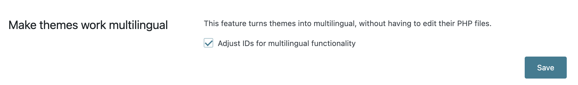

Welcome to the WPML support forum. Before passing this thread to my colleague, I would like to share some suggestions and possible solutions for the issues you mentioned. Sorry for the late response becuase of the holidays.

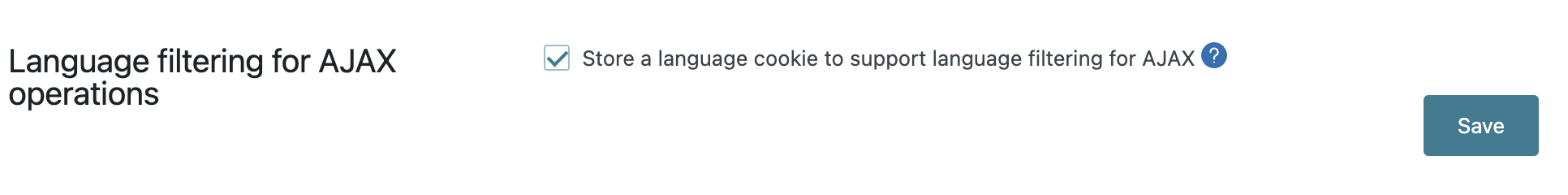

This may be a compatibility issue. Please visit the WPML >> Languages page and ensure the following options are enabled.
a) Make themes work multilingual >> Adjust IDs for multilingual functionality
b) Language filtering for AJAX operations >> Store a language cookie to support language filtering for AJAX
If it is already enabled, please follow the WPML and WooCommerce Multilingual troubleshooting steps in the linked article after taking a full site backup. Then, clear all caches (plugin, server/hosting, CDN, and browser) and check whether the bug still occurs.

I have checked both those options were enabled and cleared all caches etc, the result is the same.

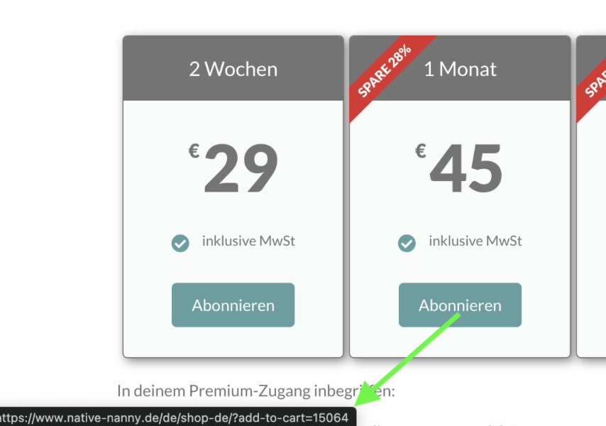

Perhaps you could explain what I SHOULD be seeing? ... Are WooCommerce add-to-cart URLs supposed to have their translated Product IDs included in the TRANSLATIONS? I understood up til now WPML "translated" these on-the-fly (meaning it picked up the correct Product ID) depending on what language the user was using the site in.
So for example if add-to-cart=44032 is the English version, then add-to-cart= 44034 should be "found" automatically when using the German version of our site.
Could the problem be to do with the fact that when we translate the original page
to the German page
that we are not even being offered the URLs from the Subscribe buttons to translate?! I seem to remember when I developed those pages originally years back that I was given the URLs to translate, however I could be mistaken.

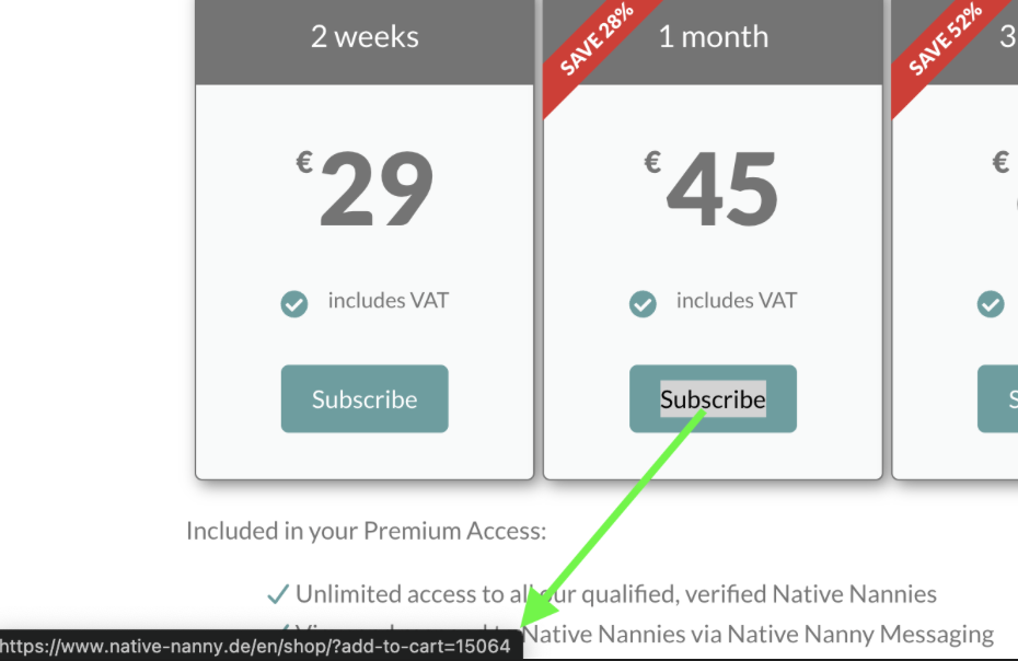

1) From what you are saying, I am understanding that we MUST translate the add-to-cart URLs? In other words I MUST translate
to its German equivalent of
Correct? Has this changed at some point? We didn't have to do this in the past I believe.
2) That table you can see when opening the URL you are quoting is only for the mobile version of our Subscription selection page, because it's a simple HTML table.
For all non-mobile versions of that page, the buttons (which contain the add-to-cart URLs are from the Elementor Price Table and the URLs are not being presented for translation.

August 19, 2025 at 9:58 am #17330667
Carlos Rojas
Hi Simon,
1.- Yes, exactly
